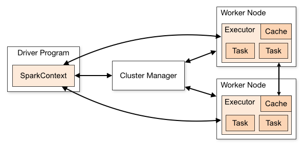

How it Works
In a standalone cluster deployment, the cluster manager in the below diagram is a Spark master instance. When using Mesos, the Mesos master replaces the Spark master as the cluster manager.
Now when a driver creates a job and starts issuing tasks for scheduling, Mesos determines what machines handle what tasks. Because it takes into account other frameworks when scheduling these many short-lived tasks, multiple frameworks can coexist on the same cluster without resorting to a static partitioning of resources.
