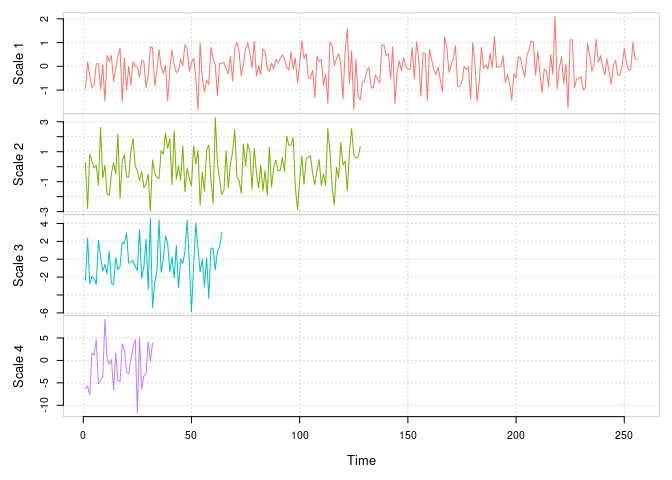

The DWT performs a wavelet decomposition by applying the wavelet filter to non-overlapping windows of the time series. Below is an example of how to perform this decomposition on a simulated Gaussian random walk process.
# Load packages
library(wv)
library(simts)
#> Attaching package: 'simts'
#> The following object is masked from 'package:wv':
#> unitConversion
# Set seed for reproducibility

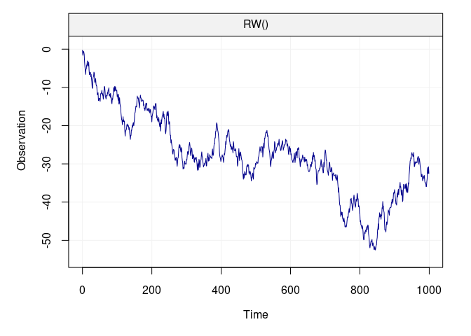

set.seed(999)
# Simulate a Gaussian random walk
n = 10^3
model = RW(gamma2 = 1)
Xt = gen_gts(n = n, model = model)
# Plot the simulated random walk
plot(Xt)
Based on the above code, we have simulated a random walk with null expectation unit innovation variance. The functions to compute the DWT, access its output and plot the related wavelet coefficients can be found below.
# DWT
Xt.dwt = dwt(Xt)
#> Warning in dwt(Xt): The data has been truncated so that it is divisible by
#> `nlevels` (e.g. 2^*)
# Print the Wavelet Coefficients
summary(Xt.dwt)
#> Results of DWT using haar filter with 8 levels:
#> Displaying only the first 6 coefficients...
#> Level 1 Wavelet Coefficients
#> -0.9281198 0.1909687 -0.4002392 -0.8957566 -0.7926733 0.09473632 ...
#> Level 2 Wavelet Coefficients
#> 0.2739394 -2.795066 0.8319477 0.3625764 -0.08550498 0.108777 ...
#> Level 3 Wavelet Coefficients
#> -2.384147 2.388987 -2.733086 -1.928826 -2.133592 -2.809311 ...
#> Level 4 Wavelet Coefficients
#> -6.282995 -5.729953 -7.616116 1.635971 1.2219 4.605007 ...
#> Level 5 Wavelet Coefficients
#> -10.03819 -6.631445 -0.6948675 -19.01644 12.1667 -5.350667 ...
#> Level 6 Wavelet Coefficients
#> -23.08426 -18.32217 18.40802 -8.680854 -4.335243 6.224648 ...
#> Level 7 Wavelet Coefficients
#> -34.68146 -7.485961 -5.448519 -30.51181 ...
#> Level 8 Wavelet Coefficients
#> -50.81154 1.13322 ...
# Plot of Discrete Wavelet Coefficients
plot(Xt.dwt)
Discrete Wavelet Transform (DWT) for scales 1 to 4 for a simulated Gaussian white noise.

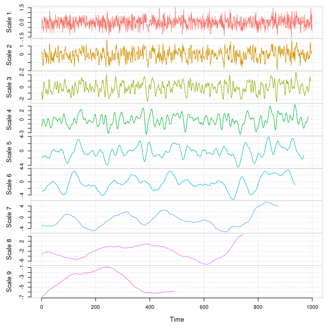

Compared to the DWT, the MODWT applies the wavelet filter to overlapping windows of the time series (more specifically it slides the filter by one observation at a time). As for the DWT, the functions to perform the MODWT are below.
# MODWT
Xt.modwt = modwt(Xt)
# Summary of Maximum Overlap Discrete Wavelet Coefficients
summary(Xt.modwt)
#> Results of MODWT using haar filter with 9 levels:
#> -0.6562798 0.397592 0.1350352 -0.1386532 -0.2830119 -0.9393291 ...
#> 0.1369697 0.2645046 -0.2126415 -0.822003 -1.397533 -1.344998 ...
#> -0.8429231 -1.362249 -2.044266 -1.991537 -1.571604 -0.827054 ...
#> -1.570749 -1.175945 -0.7167598 -0.3172241 -0.04720348 0.01135659 ...
#> -1.774519 -1.731545 -1.702113 -1.711879 -1.649612 -1.530804 ...
#> -2.885532 -2.821419 -2.829503 -2.839451 -2.783538 -2.726905 ...
#> -3.065437 -3.069304 -3.063743 -3.03344 -2.997907 -2.955661 ...
#> -3.175721 -3.114701 -3.064177 -3.0097 -2.956361 -2.910441 ...
#> Level 9 Wavelet Coefficients
#> -6.967706 -6.925613 -6.884283 -6.838645 -6.79024 -6.735489 ...
# Plot of Maximum Overlap Discrete Wavelet Coefficients
plot(Xt.modwt, index = "all")
Maximum Overlap Discrete Wavelet Transform (MODWT) for scales 1 to 9 for a simulated Gaussian white noise.

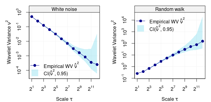

If the interest of the user lies solely in the wavelet variance
(issued from either DWT or MODWT), then the package provides functions
that directly compute this quantity and deliver the tools necessary to
analyse it (confidence intervals and plots). Below is a code that
simulates a white noise and a random walk process and directly plots
their respective wavelet variances in a log-log plot applying the
plot() function to the package function
wvar().
set.seed(999)
# Simulate Gaussian White noise
n = 10^4
Xt = gen_gts(n = n, model = WN(sigma2 = 1))
# Simulate Gaussian Random walk
Yt = gen_gts(n = n, model = RW(gamma2 = 1))
# Plot WV
par(mfrow = c(1,2), mar = c(4,5,1,1))
plot(wvar(Xt), main = "White noise")
plot(wvar(Yt), main = "Random walk", legend_position = NULL)
Wavelet variance of two simulated processes, i.e white noise (left panel) and random walk (right panel).

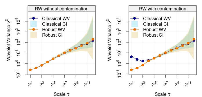

As indicated in the legends, the light shaded blue area represents the 95% confidence intervals for each scale of estimated wavelet variance. However, there could be many practical settings where the time series can suffer from some “contamination” (e.g. outliers) which can seriously bias the standard estimator of wavelet variance. The code below randomly replaces one percent of the observations from the above simulated random walk with observations from a white noise process with larger variance.
# Add contamination
gamma = 0.01
Yt2 = Yt
Yt2[sample(1:n,round(gamma*n))] = rnorm(round(gamma*n),0,5)
robust_eda(Yt, main = "RW without contamination")
robust_eda(Yt2, legend_position = NULL, main = "RW with contamination")
It can be seen how the classic and robust wavelet variance estimates agree when there is no contamination (left plot) but they classic estimates are heavily biased (especially at the first more informative scales) when the random walk has only 1% contamination.

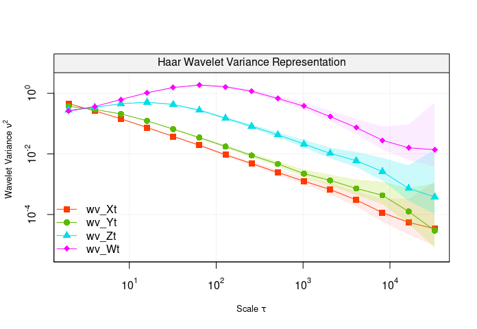

When dealing with different time series, it is possible to compare their respective wavelet variances to understand if they have similar behaviour/properties. An example is given below where four different first-order autoregressive processes (with different values of the autoregressive parameters) are simulated and succesively their wavelet variance is computed.
# Simulate AR processes
n = 10^5
Xt = gen_gts(n = n, model = AR1(phi = 0.10, sigma2 = 1))
Yt = gen_gts(n = n, model = AR1(phi = 0.35, sigma2 = 1))
Zt = gen_gts(n = n, model = AR1(phi = 0.79, sigma2 = 1))
Wt = gen_gts(n = n, model = AR1(phi = 0.95, sigma2 = 1))
# Compute WV
wv_Xt = wvar(Xt)
wv_Yt = wvar(Yt)
wv_Zt = wvar(Zt)
wv_Wt = wvar(Wt)
# Plot results
compare_wvar(wv_Xt, wv_Yt, wv_Zt, wv_Wt)
As seen above, the function compare_wvar() allows to
plot different outputs of the wvar() function and it can be
seen how the four time series deliver different wavelet variances (as
the autoregressive parameter approaches zero, the shape of the wavelet
variance plot approaches the behaviour of the wavelet variance of a
white noise process).

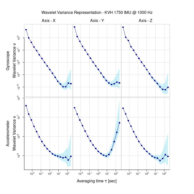

In the package, we also add some datasets which are the wavelet
variance computed based on real IMU data. Currently the package includes
datasets adis_wv, imar_wv,
kvh1750_wv, ln200_wv and
navchip_av. We can plot these wavelet variance simply with
the plot function. As an example:
data("kvh1750_wv")
plot(kvh1750_wv)
