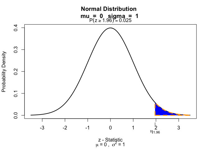

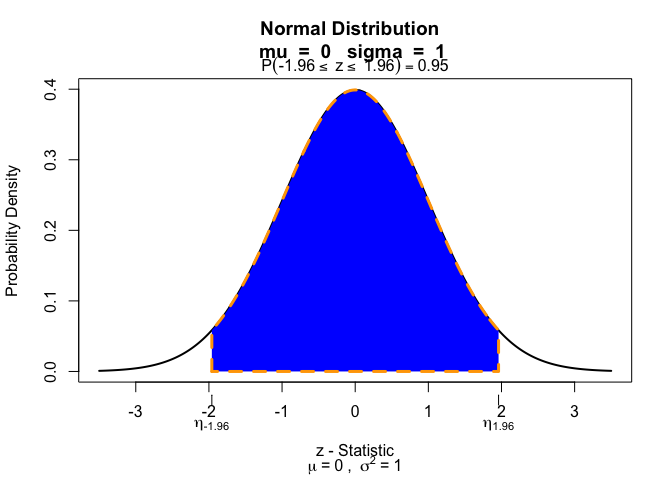

Then, construct a graph by following the visualize.dist() pattern. For example, the normal distribution can be shown with:

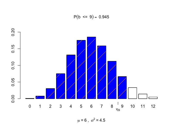

The parameters of the distribution can also be modified. Take for example the Binomial distribution.
# Visualize the binominal distribution with a higher size and lower probability.
visualize.binom(stat = 9, size = 24, p = 0.25)

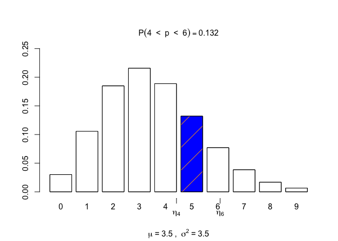

Discrete distributions can also handle a level of strict (<, >) or equal to (<=, >=) inequality.
# Create a strict inequality (lower < x < higher)
visualize.pois(stat = c(4, 6), lambda = 3.5, section = "bounded",
strict = c(TRUE, TRUE))

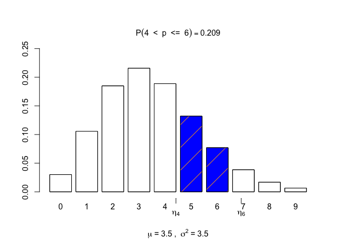

# Allow for equality on either side only on the right side of the bounded region.
strict = c(TRUE, FALSE))

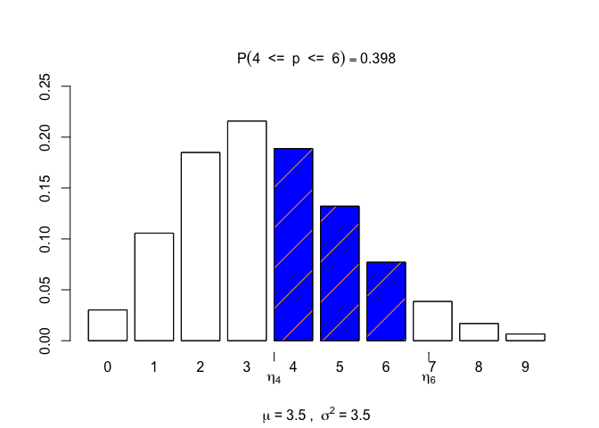

# Allow for equality on either side of the inequality (lower <= x <= higher)
strict = c(FALSE, FALSE))
