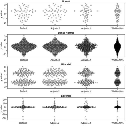

We use the provided function offsetX to generate the x-offsets for plotting.
library(vipor)
# Generate data
set.seed(12345)
dat <- list(rnorm(50), rnorm(500), c(rnorm(100), rnorm(100,5)), rcauchy(100))
names(dat) <- c("Normal", "Dense Normal", "Bimodal", "Extremes")
# Violin points of several distributions
par(mfrow=c(4,1), mar=c(2.5,3.1, 1.2, 0.5),mgp=c(2.1,.75,0),
cex.axis=1.2,cex.lab=1.2,cex.main=1.2)
sapply(names(dat),function(label) {
y<-dat[[label]]
offsets <- list(
'Default'=offsetX(y), # Default
'Adjust=2'=offsetX(y, adjust=2), # More smoothing
'Adjust=.1'=offsetX(y, adjust=0.1), # Tighter fit
'Width=10%'=offsetX(y, width=0.1) # Less wide
ids <- rep(1:length(offsets), each=length(y))
plot(unlist(offsets) + ids, rep(y, length(offsets)), ylab='y value',
xlab='', xaxt='n', pch=21,col='#00000099',bg='#00000033',las=1,main=label)
axis(1, 1:length(offsets), names(offsets))

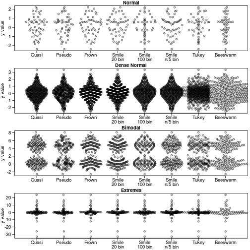

library(beeswarm)
y<-dat[[label]]
#need to start plot first for beeswarm so xlim is magic number here
plot(1,1,type='n',ylab='y value',xlim=c(.5,8+.5),
ylim=range(y),xlab='', xaxt='n', ,las=1,main=label)
offsets <- list(
'Quasi'=offsetX(y), # Default
'Pseudo'=offsetX(y, method='pseudorandom',nbins=100),
'Frown'=offsetX(y, method='frowney',nbins=20),
'Smile\n20 bin'=offsetX(y, method='smiley',nbins=20),
'Smile\n100 bin'=offsetX(y, method='smiley',nbins=100),
'Smile\nn/5 bin'=offsetX(y, method='smiley',nbins=round(length(y)/5)),
'Tukey'=offsetX(y, method='tukey'),
'Beeswarm'=swarmx(rep(0,length(y)),y)$x
points(unlist(offsets) + ids, rep(y, length(offsets)),pch=21,col='#00000099',bg='#00000033')
par(lheight=.8)
axis(1, 1:length(offsets), names(offsets),padj=1,mgp=c(0,-.3,0),tcl=-.5)
