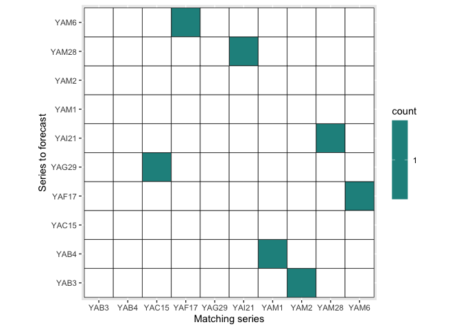

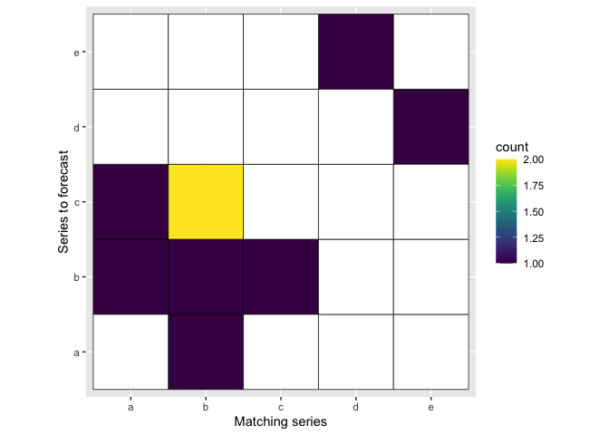

viz_dataleaks: Visualise the data leaks
[[2]]
[[2]]$a
.id start end
2 b 2 6
[[2]]$b
.id start end
1 a 1 5
2 b 17 21
4 c 11 15
[[2]]$c
.id start end
1 a 1 5
2 b 17 21
3 b 22 26
[[2]]$d
.id start end
5 e 6 10
[[2]]$e
.id start end
4 d 6 10

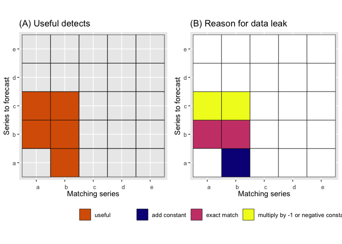

reason_dataleaksDisplay the reasons for data leaks and evaluate usefulness of data leaks towards the winning of the competition
r1 <- reason_dataleaks(lstx = lst, finddataleaksout = f1, h=5)
r1
[[1]]
series1 .id start end dist_mean dist_sd is.useful.leak dist_cor
1 a b 2 6 -8.0 0.0 useful 1
2 b a 1 5 0.0 0.0 useful 1
3 b b 17 21 0.0 0.0 useful 1
4 b c 11 15 -1.7 2.6 not useful -1
5 c a 1 5 1.7 2.6 useful -1
6 c b 17 21 1.7 2.6 useful -1
7 c b 22 26 1.7 2.6 not useful -1
8 d e 6 10 0.0 0.0 not useful 1
9 e d 6 10 0.0 0.0 not useful 1
reason
1 add constant
2 exact match
3 exact match
4 multiply by -1 or negative constant value
5 multiply by -1 or negative constant value
6 multiply by -1 or negative constant value
7 multiply by -1 or negative constant value
8 exact match
9 exact match

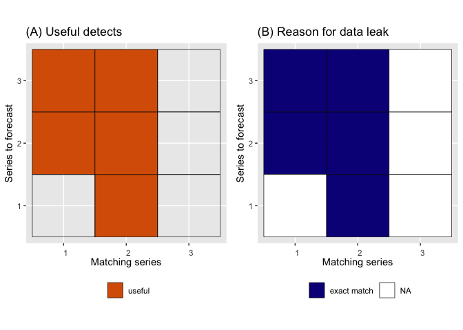

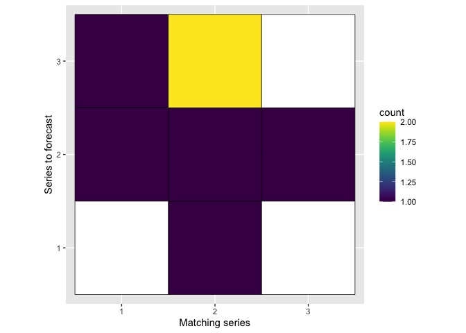

[[2]]
a = rnorm(15)
lst <- list(
a,
c(a[10:15], rnorm(10), a[1:5], a[1:5]),
c(rnorm(10), a[1:5])
f1 <- find_dataleaks(lst, h=5)
#> [[2]]
#> [[2]]$`1`
#> .id start end
#> 2 2 2 6
#> [[2]]$`2`
#> .id start end
#> 1 1 1 5
#> 2 2 17 21
#> 4 3 11 15
#> [[2]]$`3`
#> .id start end
#> 1 1 1 5
#> 2 2 17 21
#> 3 2 22 26
reason_dataleaks(lst, f1, h=5)
#> [[1]]
#> series1 .id start end dist_mean dist_sd is.useful.leak dist_cor reason
#> 1 1 2 2 6 0 0 useful 1 exact match
#> 2 2 1 1 5 0 0 useful 1 exact match
#> 3 2 2 17 21 0 0 useful 1 exact match
#> 4 2 3 11 15 0 0 not useful 1 exact match
#> 5 3 1 1 5 0 0 useful 1 exact match
#> 6 3 2 17 21 0 0 useful 1 exact match
#> 7 3 2 22 26 0 0 not useful 1 exact match

#> [[2]]
#> [[2]]$YAF17
#> .id start end
#> 22 YAM6 9 14
#> [[2]]$YAM6
#> .id start end
#> 16 YAF17 16 21
#> [[2]]$YAM28
#> .id start end
#> 78 YAI21 16 21
#> [[2]]$YAB3
#> .id start end
#> 18 YAM2 14 19
#> [[2]]$YAB4
#> .id start end
#> 17 YAM1 15 20
#> [[2]]$YAI21
#> .id start end
#> 43 YAM28 16 21
#> [[2]]$YAG29
#> .id start end
#> 137 YAC15 6 11

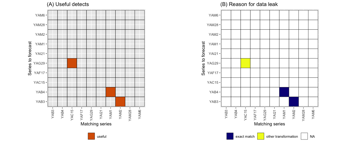

reason_dataleaks(M1Y_x, m1y_f1, h=6, ang=90)
#> [[1]]
#> 1 YAF17 YAM6 9 14 5.4 0.4 not useful 1
#> 2 YAM6 YAF17 16 21 -5.4 0.4 not useful 1
#> 3 YAM28 YAI21 16 21 0.0 0.0 not useful 1
#> 4 YAB3 YAM2 14 19 0.0 0.0 useful 1
#> 5 YAB4 YAM1 15 20 0.0 0.0 useful 1
#> 6 YAI21 YAM28 16 21 0.0 0.0 not useful 1
#> 7 YAG29 YAC15 6 11 -36815.7 6159.2 useful 1
#> reason
#> 1 other transformation
#> 2 other transformation
#> 3 exact match
#> 4 exact match
#> 5 exact match
#> 6 exact match
#> 7 other transformation
#> [[2]]
