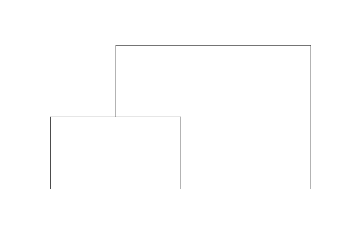

Consider a three tip tree:
library(ape)
library(treenomial)
threeTipTree <- rtree(3, rooted = T)
plot.phylo(threeTipTree, use.edge.length = F, show.tip.label = F, direction = "downwards")
It’s polynomial is x^3+xy+y which can equivalently be described with a coefficient matrix where the element in the ith row, jth column represents the y^(i-1) * x^(j-1) coefficient:
treeToPoly(threeTipTree, varLabels = T)
#> x^0 x^1 x^2 x^3
#> y^0 0 0 0 1
#> y^1 1 1 0 0

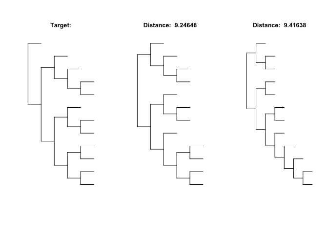

#> y^2 0 0 0 0Using the coefficients of the polynomials, distances between trees can be compared, below the two closest trees to a random target tree are found from a random sample:
# random 12 tip target tree
target <- rtree(12)
# random sample of 100 trees
sample <- rmtree(100,12)
minInfo <- plotExtremeTrees(target,sample, n = 2, comparison = "min", type = "d")
