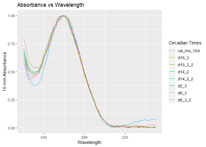

#PLOT-rnaspec2018.csv 'strict'
library(ggplot2)
library(plotly)
library(htmlwidgets)
rnaqcplot = ggplot(rna_data, aes(x=wave_length)) +
geom_line(aes(y=zt2_3, color='zt2_3')) +
geom_line(aes(y=zt14_2, color='zt14_2')) +
geom_line(aes(y=zt14_2_2, color='zt14_2_2')) +
geom_line(aes(y=cal_rna_12ul, color='cal_rna_12ul')) +
geom_line(aes(y=zt6_3, color='zt6_3')) +
geom_line(aes(y=zt6_3_2, color='zt6_3_2')) +
geom_line(aes(y=zt10_3, color='zt10_3')) +
geom_line(aes(y=zt10_3_2, color='zt10_3_2')) +
labs(title = 'Absorbance vs Wavelength', x = 'Wavelength', y='10 mm Absorbance', color='Circadian Times')
#saveWidget(ggplotly(rnaqcplot), file = "rnaplot.html", selfcontained = F, libdir = "lib")
#ggplotly(rnaqcplot)
rnaqcplot

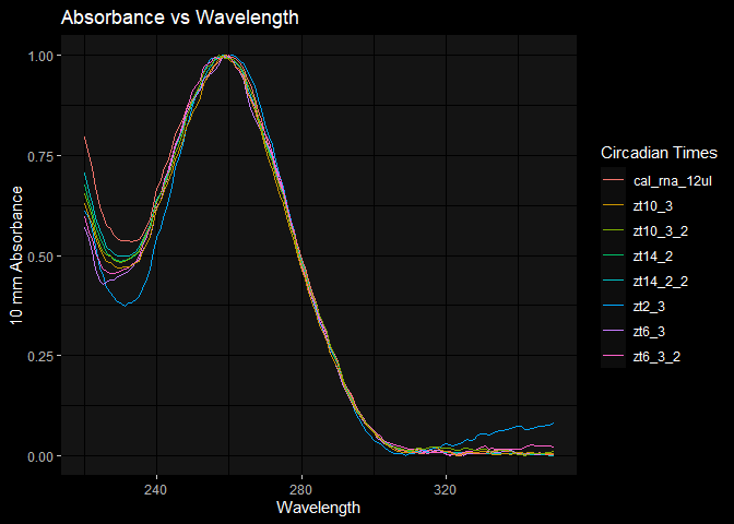

#PLOT dark mode-rnaspec2018.csv 'strict'
library(ggplot2)
library(plotly)
library(ggdark)
library(ggthemes)
library(widgetframe)
#library(hrbrthemes)
#old <- theme_set(theme_dark())
dark_mode() +
#frameWidget(ggplotly(rnaqcplot))
rnaqcplot
