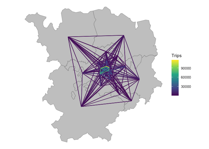

Let’s focus on trips in and around a particular area (Salamanca):
salamanca_zones <- zonebuilder::zb_zone("Salamanca")
distritos_salamanca <- distritos_wgs84[salamanca_zones, ]
plot(distritos_salamanca)
We will use this information to subset the rows, to capture all movement within the study area:
ids_salamanca <- distritos_salamanca$id
od_salamanca <- od_national_sf |>
filter(id_origin %in% ids_salamanca) |>
filter(id_destination %in% ids_salamanca) |>
arrange(Trips)Let’s plot the results:
od_salamanca_sf <- od::od_to_sf(
od_salamanca,
z = distritos_salamanca
ggplot() +
geom_sf(fill = "grey", data = distritos_salamanca) +
geom_sf(aes(colour = Trips), size = 1, data = od_salamanca_sf) +
scale_colour_viridis_c() +
theme_void()
