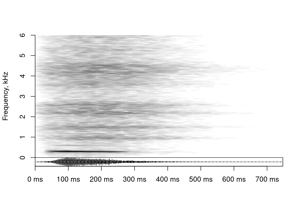

soundgen()soungen_app()analyze()pitch_app()segment()Use the soundgen() function to create a breathy
moan:
s = soundgen(
sylLen = 230, # duration of voiced part, ms
pitch = c(305, 280), # pitch, Hz (goes down from 305 to 380 Hz)
ampl = c(0, -20), # amplitude, dB (gradual fade-out by 20 dB)
rolloff = -30, # strong f0, weak harmonics
temperature = 0.05, # some stochasticity in generation
formants = c(260, 960, 1500, 2200, # F1-F8 formant frequencies, Hz
2600, 3600, 4200, 4500),
noise = data.frame(
time = c(-50, 120, 700), # time of noise anchors
value = c(-15, -5, -50) # noise amplitude, dB
rolloffNoise = 0, # flat noise spectrum before adding formants
addSilence = 0, samplingRate = 44100, pitchSamplingRate = 44100,
play = TRUE, plot = TRUE, osc = TRUE, ylim = c(0, 6)

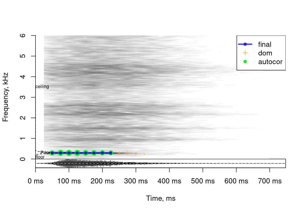

Use the analyze() function to detect pitch and obtain
other spectral descriptives of the sound we have just synthesized:
a = analyze(s, 44100, plot = TRUE, ylim = c(0, 6))
a$detailed[1:5, c('pitch', 'peakFreq', 'harmHeight', 'HNR', 'ampl', 'loudness')]
#> pitch peakFreq harmHeight HNR ampl loudness
#> 1 NA NA NA NA 0.02993491 NA
#> 2 291.4030 300.1361 582.8060 5.743706 0.19258955 11.19230
#> 3 293.9992 300.1361 881.9977 13.480664 0.41832141 18.21197
#> 4 293.8760 300.1361 881.9977 13.757051 0.53108777 22.46051
#> 5 292.1780 300.1361 1753.0680 12.266983 0.49117243 21.69834
