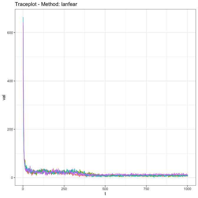

Multivariate, multichain MCMC diagnostics, including traceplots,
Gelman-Rubin diagnostics, and effective sample size, are all available
for various parameters from the model fit. These are supplied using the
genMCMCDiag package, see that packages’ documentation for
details.
Here we show the output of the diagnostics on the \(c_{ij}\) parameters, which show that (at least for the \(c_{ij}\) values) the algorithm is mixing effectively (or will be, once the algorithm runs a little longer).
skipTrack.diagnostics(ft, param = 'cijs')
#> Generalized MCMC Diagnostics using Custom Method
#> |Effective Sample Size:
#> | Chain 1| Chain 2| Chain 3| Chain 4| Sum|
#> | 86.077| 81.6| 91.054| 114.178| 372.909|
#> |psrf:
#> | Point est.| Upper C.I.|
#> | 1.001| 1.005|

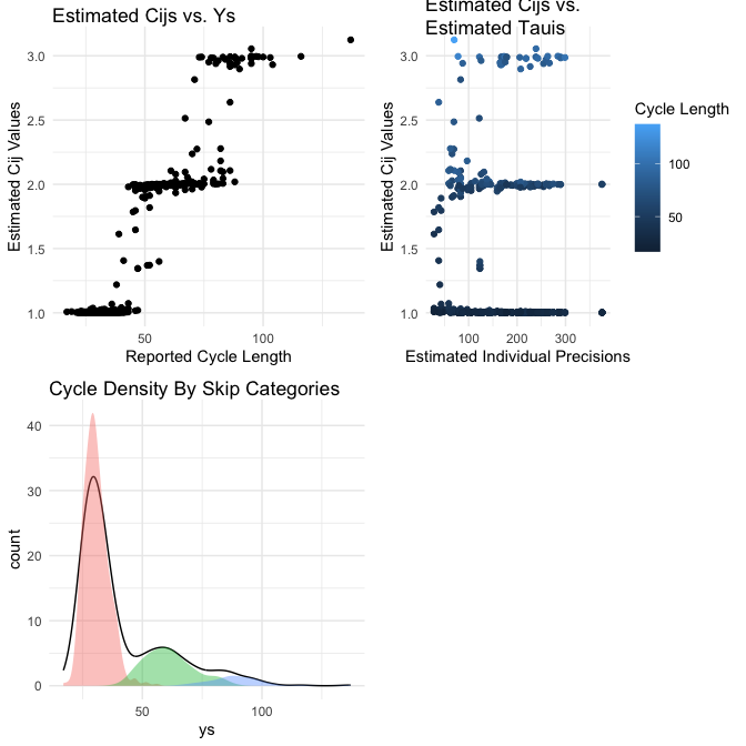

In order to see some important plots for the SkipTrack model fit, you
can simply use plot(ft), and the plots are directly
accessible using skipTrack.visualize(ft).
plot(ft)
