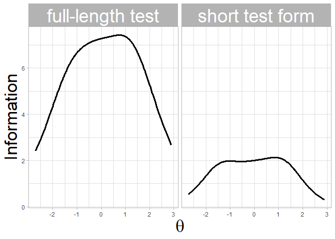

#> 144 I24 2.3350 0.4488457 STF-5Plot the test information function of both the full-length test and the STF:
plot_tif(stf_eip, tif = "both") + theme_light() +
ylab("Information") + xlab(expression(theta)) +
theme(axis.title = element_text(size = 26),
strip.text.x = element_text(size = 28))

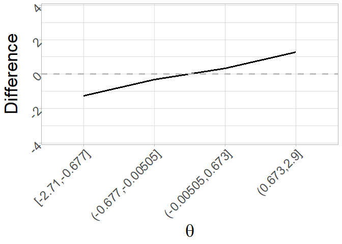

#> 6 -1.9871210 -1.462003e-78 -1.9871210 1.9871210Finally, bias can also be plotted with the function plot_difference() as a function of different levels of \(\theta\). Default is to plot the difference as a function of 4 levels of \(\theta\):
plot_difference(bias_eip) + theme_light() +
ylab("Difference") + xlab(expression(theta)) +
strip.text.x = element_text(size = 28),
axis.text = element_text(size = 18, angle = 45, hjust=1))

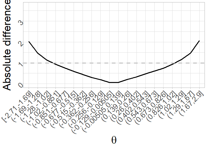

But this can be changed by changing the default of the arguments type and levels to plot, for instance, the absolute difference for 20 levels of the latent trait:
plot_difference(bias_eip, type = "absolute_diff", levels = 20) + theme_light() + xlab(expression(theta)) +
