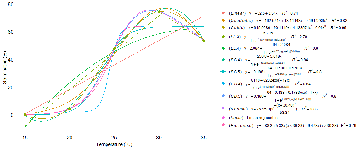

The influence of temperature on plant seed germination is a very
popular topic in agronomy. However, researchers have difficulty in
estimating the optimal, maximum and minimum points for the occurrence of
germination, often using inappropriate models. Thus, the present work
has the purpose of presenting regression models common in scientific
works and others with potential for use, implemented in the form of an R
package called seedreg. Eight regression models were implemented:
linear, quadratic, cubic, logistic of three or four parameters,
Brain-Cousens logistic with four and five parameters,
Cedergreen-Ritz-Streibig with four and five parameters, normal and

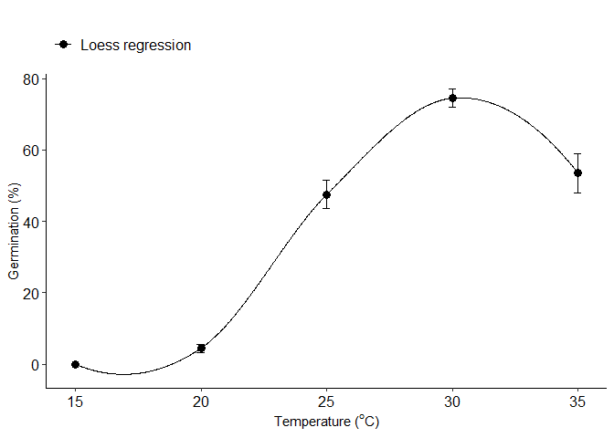

loess. The package returns the estimate of the optimal, maximum and
minimum points, in addition to statistical parameters, such as the
criteria of AIC, BIC, R2, significance of the
coefficients. Models can be accessed by the LL_model(),
BC_model(),CD_model,normal_model,
quali_model, loess_model and
LL_model() functions.

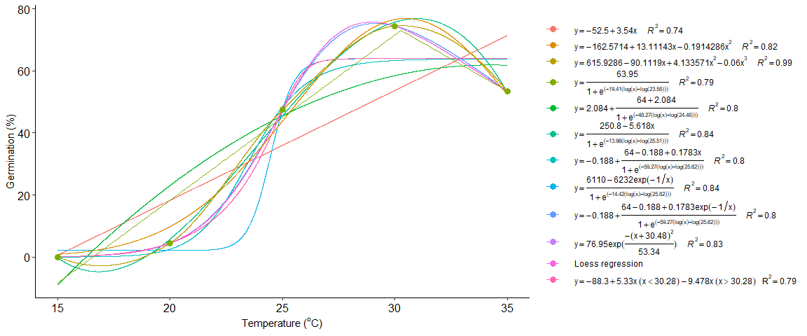

rm(list=ls())
library(seedreg)
data("aristolochia")

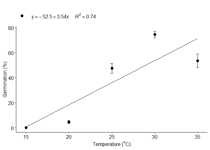

attach(aristolochia)a=LM_model(trat,resp)
#> Scale for 'colour' is already present. Adding another scale for 'colour',
#> which will replace the existing scale.
#> Warning in max(temp1[round(result) == "0" & temp1 > maximo]): nenhum argumento
#> não faltante para max; retornando -Inf
#> Warning in max(temp1[round(result) == "0"]): nenhum argumento não faltante para
#> max; retornando -Inf
#> Predicted values and statistical parameters
#> Note: if the maximum predicted value is equal to the maximum x, the curve does not have a maximum point within the studied range. If the minimum value is less than the lowest point studied, disregard the value.
#> Note: Lower AIC and BIC values and higher R-squared values indicate better models. VIF above 10 indicates variance inflation problem (Multicollinearity)
#> Estimate Std. Error t value Pr(>|t|)
#> (Intercept) -52.50 8.0436071 -6.526922 6.166973e-09
#> trat 3.54 0.3095986 11.434161 2.398736e-18
#> $teste
#> Parameter values
#> 1 optimum temperature 35.0000000
#> 2 Predicted maximum value -Inf
#> 3 Predicted minimum value -Inf
#> 4 AIC 706.9321172
#> 5 BIC 714.0781971
#> 6 r-squared 0.7443336
#> $VIF
#> [1] NA
#> [[3]]

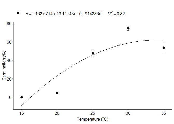

b=LM_model(trat,resp,grau = 2)
#> (Intercept) -162.5714286 28.53350582 -5.697562 2.124445e-07
#> trat 13.1114286 2.41373278 5.432013 6.288396e-07
#> I(trat^2) -0.1914286 0.04794024 -3.993067 1.478864e-04
#> $teste
#> Parameter values
#> 1 optimum temperature 34.2459246
#> 3 Predicted minimum value 16.3301330
#> 4 AIC 693.8762781
#> 5 BIC 703.4043847
#> 6 r-squared 0.8205139
#> $VIF
#> trat I(trat^2)
#> 72.42857 72.42857
#> [[3]]

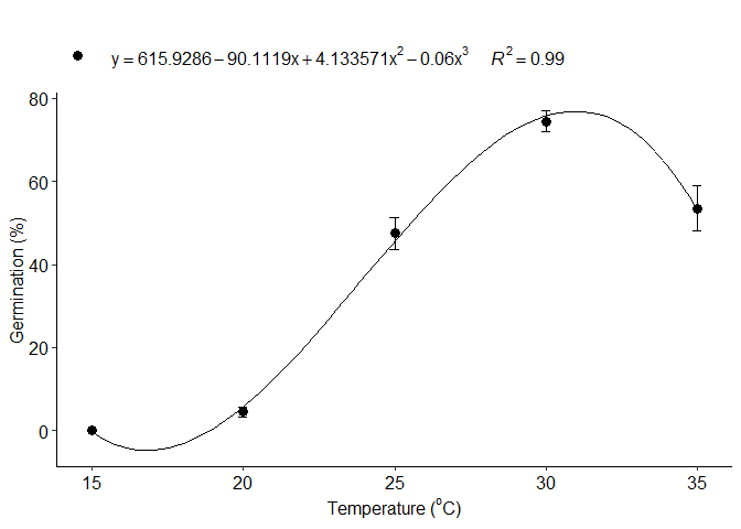

c=LM_model(trat,resp, grau=3)
#> (Intercept) 615.92857143 94.631279296 6.508721 7.284199e-09
#> trat -90.11190476 12.369050966 -7.285272 2.537032e-10
#> I(trat^2) 4.13357143 0.514234979 8.038293 9.299156e-12
#> I(trat^3) -0.05766667 0.006840848 -8.429754 1.653134e-12
#> $teste
#> Parameter values
#> 1 optimum temperature 30.9655966
#> 3 Predicted minimum value 19.0024002
#> 4 AIC 643.0672814
#> 5 BIC 654.9774146
#> 6 r-squared 0.9982817
#> $VIF
#> trat I(trat^2) I(trat^3)
#> 3632.540 15916.179 4488.194
#> [[3]]
d=LL_model(trat,resp,npar = "LL.3")
#> Model fitted: Log-logistic (ED50 as parameter) with lower limit at 0 (3 parms)
#> Parameter estimates:
#> Estimate Std. Error t-value p-value
#> b:(Intercept) -19.40819 7.22347 -2.6868 0.008834 **
#> d:(Intercept) 63.94663 2.65919 24.0474 < 2.2e-16 ***
#> e:(Intercept) 23.57567 0.70284 33.5436 < 2.2e-16 ***
#> Signif. codes: 0 '***' 0.001 '**' 0.01 '*' 0.05 '.' 0.1 ' ' 1
#> Residual standard error:
#> 14.63286 (77 degrees of freedom)
#> $teste
#> Parameter values
#> 3 Predicted minimum value 18.3683368
#> 4 AIC 661.2956178
#> 5 BIC 670.8237244
#> 6 r-squared 0.7943074
#> [[2]]

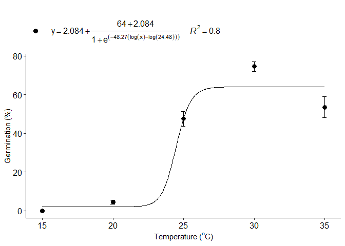

e=LL_model(trat,resp,npar = "LL.4")
#> Warning in max(temp1[round(result) == "0" & temp1 < maximo]): nenhum argumento
#> Model fitted: Log-logistic (ED50 as parameter) (4 parms)
#> b:(Intercept) -48.2686 121.7112 -0.3966 0.6928
#> c:(Intercept) 2.0836 2.5960 0.8026 0.4247
#> d:(Intercept) 63.9961 2.5954 24.6572 <2e-16 ***
#> e:(Intercept) 24.4808 1.3094 18.6960 <2e-16 ***
#> 14.6807 (76 degrees of freedom)
#> $teste
#> Parameter values
#> 4 AIC 662.7721102
#> 5 BIC 674.6822433
#> 6 r-squared 0.7953455
#> [[2]]

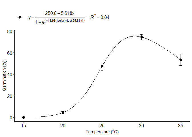

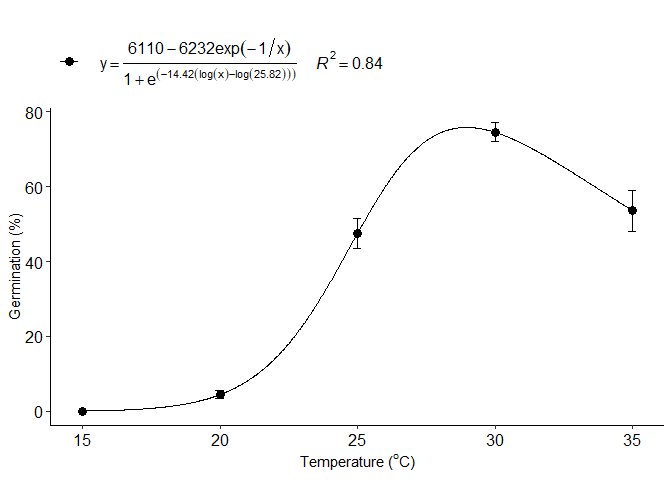

f=BC_model(trat,resp, npar = "BC.4")
#> Model fitted: Brain-Cousens (hormesis) with lower limit fixed at 0 (4 parms)
#> b:(Intercept) -13.95721 3.65564 -3.8180 0.0002727 ***
#> d:(Intercept) 250.77475 60.32596 4.1570 8.381e-05 ***
#> e:(Intercept) 25.50595 0.69513 36.6923 < 2.2e-16 ***
#> f:(Intercept) -5.61797 1.74018 -3.2284 0.0018389 **
#> 12.92089 (76 degrees of freedom)
#> $teste
#> Parameter values
#> 1 optimum temperature 29.1414141
#> 3 Predicted minimum value 16.9061906
#> 4 AIC 642.3420163
#> 5 BIC 654.2521495
#> 6 r-squared 0.8414623
#> [[2]]

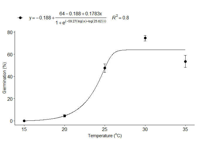

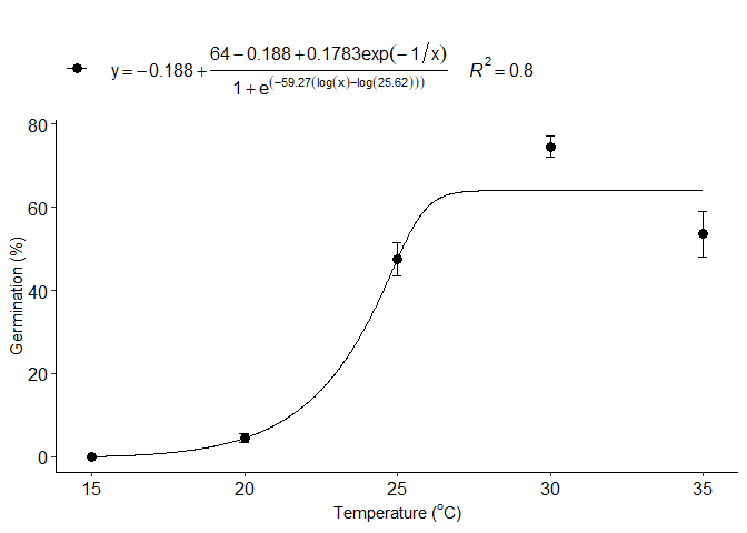

g=BC_model(trat,resp, npar = "BC.5")
#> Model fitted: Generalized log-logistic (ED50 as parameter) (5 parms)
#> b:(Intercept) -59.27493 215.42337 -0.2752 0.7840
#> c:(Intercept) -0.18797 4.13493 -0.0455 0.9639
#> d:(Intercept) 64.00006 2.59966 24.6186 <2e-16 ***
#> e:(Intercept) 25.62206 1.21891 21.0205 <2e-16 ***
#> f:(Intercept) 0.17829 0.68758 0.2593 0.7961
#> 14.70436 (75 degrees of freedom)
#> $teste
#> Parameter values
#> 3 Predicted minimum value 16.6801680
#> 4 AIC 663.9700837
#> 5 BIC 678.2622435
#> 6 r-squared 0.7973767
#> [[2]]

#> Model fitted: Cedergreen-Ritz-Streibig with lower limit 0 (alpha=1) (4 parms)
#> b:(Intercept) -14.42145 3.53110 -4.0841 0.0001085 ***
#> d:(Intercept) 6110.38907 1944.20876 3.1429 0.0023858 **
#> e:(Intercept) 25.81624 0.75778 34.0682 < 2.2e-16 ***
#> f:(Intercept) -6231.70537 2001.17232 -3.1140 0.0026022 **
#> 12.92096 (76 degrees of freedom)
#> $teste
#> Parameter values
#> 1 optimum temperature 28.9633963
#> 3 Predicted minimum value 16.8361836
#> 4 AIC 642.3427825
#> 5 BIC 654.2529157
#> 6 r-squared 0.8414613

i=CD_model(trat,resp, npar = "CRS.5")
#> $teste
#> Parameter values
#> [[2]]

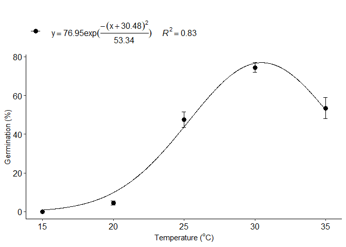

j=normal_model(trat,resp)
#> Formula: resp ~ a * exp(-1/2 * (trat - b)^2/c^2)
#> Parameters:
#> a 76.9526 3.1188 24.67 <2e-16 ***
#> b 30.4797 0.2581 118.09 <2e-16 ***
#> c 5.1641 0.2934 17.60 <2e-16 ***
#> Residual standard error: 13.22 on 77 degrees of freedom
#> Number of iterations to convergence: 10
#> Achieved convergence tolerance: 7.538e-06
#> $teste
#> Parameter values
#> 1 optimum temperature 30.4795480
#> 4 AIC 645.0511211
#> 5 BIC 654.5792276
#> 6 r-squared 0.8332529

k=loess_model(trat,resp)
#> Predicted maximum and minimum values
#> $teste
#> Parameter values
#> 1 optimum temperature 30.31153
#> 3 Predicted minimum value 18.99240
#> [[2]]

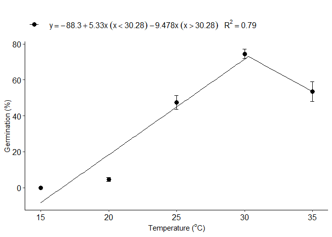

l=piecewisel_model(trat,resp)
#> Warning in data.frame(x = temp2, y = predict(model, x = temp2)): row names were
#> found from a short variable and have been discarded
#> Warning in max(temp2[round(preditos1$y) == "0"]): nenhum argumento não faltante
#> para max; retornando -Inf
#> Warning in max(temp2[round(preditos1$y) == "0" && preditos1$y > breaks]): nenhum
#> argumento não faltante para max; retornando -Inf
#> Call:
#> stats::lm(formula = y ~ x + w)
#> Residuals:
#> Min 1Q Median 3Q Max
#> -28.950 -11.600 2.775 8.350 46.500
#> Coefficients:
#> (Intercept) -88.3000 7.7231 -11.433 < 2e-16 ***
#> x 5.3300 0.3331 16.000 < 2e-16 ***
#> w -9.4783 1.2473 -7.599 5.99e-11 ***
#> Residual standard error: 14.9 on 77 degrees of freedom
#> Multiple R-squared: 0.7865, Adjusted R-squared: 0.7809
#> F-statistic: 141.8 on 2 and 77 DF, p-value: < 2.2e-16
#> $teste
#> Parameter values
#> 1 optimum temperature 30.2787
#> 4 AIC 664.1642
#> 5 BIC 673.6923
#> 6 r-squared 0.7900
#> [[2]]
seedreg::multicurve(list(a,b,c,d,e,f,g,h,i,j,k,l),legend.position = "right")
trat=c("(italic(Linear))",
"(italic(Quadratic))",
"(italic(Cubic))",
"(italic(LL.3))",
"(italic(LL.4))",
"(italic(BC.4))",
"(italic(BC.5))",
"(italic(CD.4))",
"(italic(CD.5))",
"(italic(Normal))",
"(italic(loess))",
"(italic(Piecewise))"),

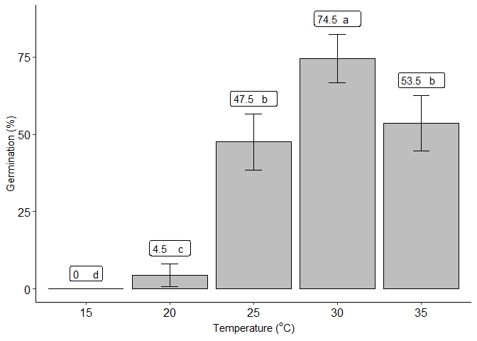

quali_model(trat, resp,family = "quasibinomial")
#> Quasi-binomial model
#> Note: adjust = "tukey" was changed to "sidak"
#> because "tukey" is only appropriate for one set of pairwise comparisons
#> Analysis of Deviance Table (Type II tests)
#> Response: cbind(nseeds, n - nseeds)
#> LR Chisq Df Pr(>Chisq)
#> trat 460.7 4 < 2.2e-16 ***
#> trat prob SE df asymp.LCL asymp.UCL .group
#> 15 0.000 1.41e-06 Inf -3.60e-06 3.60e-06 d
#> 20 0.045 1.45e-02 Inf 7.65e-03 8.24e-02 c
#> 25 0.475 3.50e-02 Inf 3.85e-01 5.65e-01 b
#> 30 0.745 3.06e-02 Inf 6.66e-01 8.24e-01 a
#> 35 0.535 3.50e-02 Inf 4.45e-01 6.25e-01 b
#> Confidence level used: 0.95
#> Conf-level adjustment: sidak method for 5 estimates
#> P value adjustment: tukey method for comparing a family of 5 estimates
#> significance level used: alpha = 0.05
