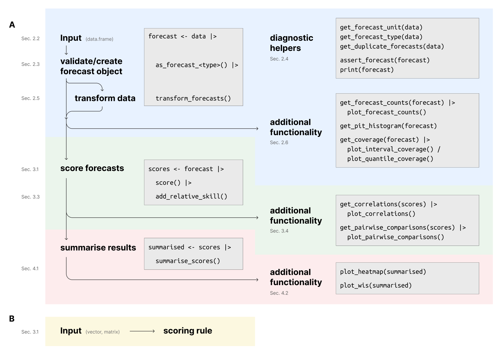

#> 7: 31.9 -0.00513 0.420 0.908 105.0The following depicts the suggested workflow for evaluating forecasts
with scoringutils (sections refer to the paper). Please
find more information in the paper,
the function documentation and the vignettes.
