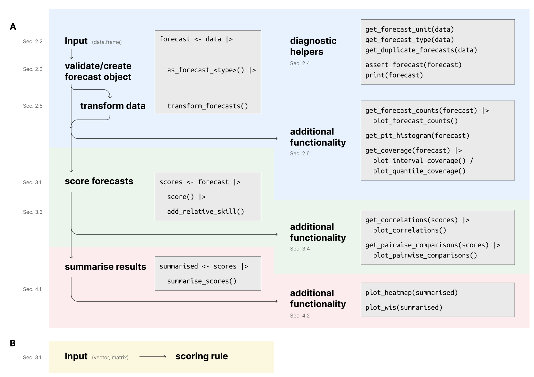

The update aims to make the package more modular and customisable and
overall cleaner and easier to work with. In particular, we aimed to make
the suggested workflows for evaluating forecasts more explicit and
easier to follow (see visualisation below). To do that, we clarified

scores <- score(forecast_quantile)Overall, we updated the suggested workflows for how users should
work with the package. The following gives an overview (see the updated
paper for more details).

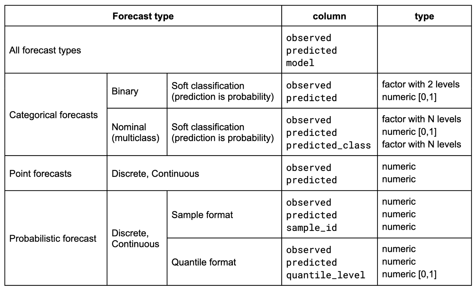

We standardised input formats both for score() as
well as for the scoring rules exported by scoreingutils.
The following plot gives a overview of the expected input formats for
the different forecast types in score().
