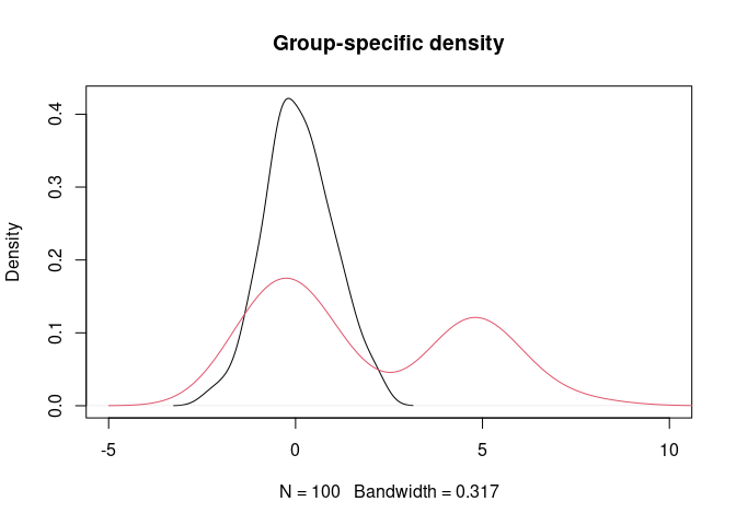

y <- c(rnorm(160), rnorm(40, 5))
g <- rep(1:2, rep(100, 2))
plot(density(y[g==1]), xlim = c(-5,10), main = "Group-specific density")
lines(density(y[g==2]), col = 2)

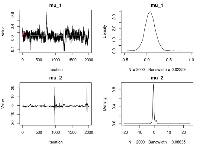

out_mcmc <- fit_CAM(y = y, group = g, est_method = "MCMC", mcmc_param = list(nrep = 5000, burn=3000))
#> Warning in sample_CAM(y, group, prior_param = prior_param, mcmc_param =
#> mcmc_param): Increase maxK: all the provided distributional mixture components
#> were used. Check '$warnings' to see when it happened.
out_mcmc
#> MCMC result of CAM model
#> Model estimated on 200 total observations and 2 groups
#> Size of the MCMC sample (after burn-in): 2000
#> Total MCMC iterations performed: 5000
#> maxL: 50 - maxK: 20
#> Elapsed time: 0.615 secs
plot(out_mcmc)
#> [1] "Output truncated at 2 for mu."

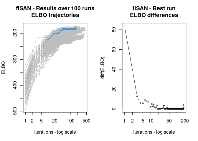

out_vi <- fit_fiSAN(y, group = g, est_method = "VI", vi_param = list(n_runs = 100))
out_vi
#> Variational inference results for fiSAN
#> L: 30 - K: 20
#> Threshold: 1e-06
#> ELBO value: -173.141
#> Best run out of 100
#> Convergence reached in 180 iterations
#> Elapsed time: 0.041 secs
plot(out_vi)
