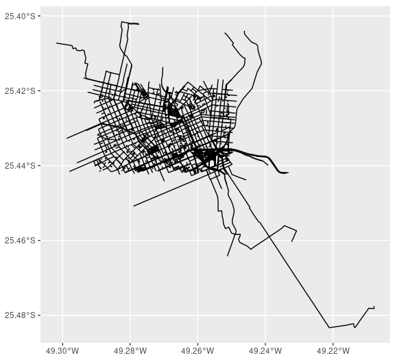

cur_pbf <- system.file("extdata/cur.osm.pbf", package = "rosmium")
cur_pbf_lines <- sf::st_read(cur_pbf, layer = "lines", quiet = TRUE)
ggplot(cur_pbf_lines) + geom_sf()

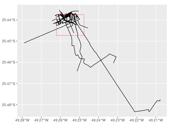

extract()extract() creates geographical extracts from OSM files. In its most basic form, the function takes the path to the OSM file whose geographical extent should be extracted from, the extent, either as a bounding box or as a (multi)polygon, and the path to the file where the output should be written to. Additionally, the function can also take the strategy to be used when creating the extract, which defaults to "complete_ways". Please check the function documentation for details on the available strategies and their behavior.
# buffering the pbf bounding box 4000 meters inward and using the result
# extent to extract the osm data inside it. transforming the crs because
# inward buffers only work with projected crs
bbox <- sf::st_bbox(cur_pbf_lines)
bbox_polygon <- sf::st_as_sf(sf::st_as_sfc(bbox))
smaller_bbox_poly <- sf::st_buffer(sf::st_transform(bbox_polygon, 5880), -4000)
smaller_bbox_poly <- sf::st_transform(smaller_bbox_poly, 4326)
output_path <- extract(
cur_pbf,
smaller_bbox_poly,
tempfile(fileext = ".osm.pbf"),
spinner = FALSE
extracted_pbf_lines <- sf::st_read(output_path, layer = "lines", quiet = TRUE)
ggplot() +
geom_sf(data = extracted_pbf_lines) +
geom_sf(data = smaller_bbox_poly, color = "red", fill = NA)

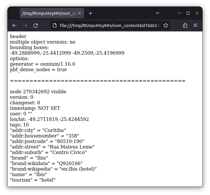

#> [6] "\"addr:city\"=>\"Curitiba\",\"addr:country\"=>\"BR\",\"addr:housenumber\"=>\"965\",\"addr:street\"=>\"Rua José de Alencar\""show_content()Finally, show_content() displays the content of an OSM file either in .html, .xml or .opl format. The function takes as input the path to the OSM file whose content should be shown, the output format in which the content should be displayed (defaulting to .html, the most human readable format, although also the slowest to open and inspect, depending on the size of the input file) and the type of objects that should be included in the output (defaulting to all existing objects in the input). The function returns the path to the temporary file in which the OSM file content was saved and opens the content in the web browser or the most appropriate application, depending on the output format.
# displays the content of the previous tags_filter() output in html format
show_content(output, spinner = FALSE)
#> [1] "/tmp/RtmpcvrR7F/osm_content72fa2e992ee.html"
