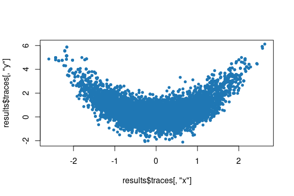

#> Adapter scale est.: 1.5328097767097, 1.42342707172926, 0.280359693392091As a second example, the snippet below demonstrates sampling from a
two-dimensional banana shaped distribution based on the Rosenbrock
function and plotting the generated chain samples. Here we use the
default values of the proposal and adapters
arguments to sample_chain(), corresponding respectively to
the Barker proposal, and adapters for tuning the proposal scale to
coerce the average acceptance rate using a dual-averaging algorithm, and
for tuning the proposal shape based on an estimate of the target
distribution covariance matrix. The target_distribution
argument to sample_chain() is passed a formula specifying
the log density of the target distribution, which is passed to
target_distribution_from_log_density_formula() to construct
necessary functions, using stats::deriv() to symbolically
compute derivatives.
library(rmcmc)
set.seed(651239L)
results <- sample_chain(
target_distribution = ~ (-(x^2 + y^2) / 8 - (x^2 - y)^2 - (x - 1)^2 / 100),
initial_state = rnorm(2),
n_warm_up_iteration = 10000,
n_main_iteration = 10000
plot(results$traces[, "x"], results$traces[, "y"], col = "#1f77b4", pch = 20)
