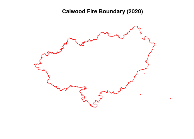

library(foreign)First, we will load the Calwood Fire perimeter data which was downloaded from Boulder County’s geospatial data hub.
boundary_file <- file.path(tempdir(), "wildfire")
utils::unzip(system.file("extdata/wildfire.zip", package = "rlandfire"),
exdir = tempdir())
boundary <- st_read(file.path(boundary_file, "wildfire.shp")) %>%
sf::st_transform(crs = st_crs(32613))
#> Reading layer `wildfire' from data source `/tmp/RtmpViWB1y/wildfire/wildfire.shp' using driver `ESRI Shapefile'
#> Simple feature collection with 1 feature and 7 fields
#> Geometry type: MULTIPOLYGON
#> Dimension: XY
#> Bounding box: xmin: -105.3901 ymin: 40.12149 xmax: -105.2471 ymax: 40.18701
#> Geodetic CRS: WGS 84
plot(boundary$geometry, main = "Calwood Fire Boundary (2020)",
border = "red", lwd = 1.5)

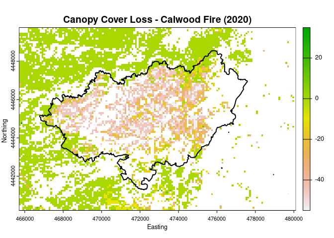

recursive = TRUE))Now we can reclassify the canopy cover layers to remove any values which are not classified as Ponderosa Pine, calculate the change, and plot our results.
lf$US_200CC_19[lf$US_200CC_19 == 1] <- NA
lf$US_220CC_22[lf$US_220CC_22 == 1] <- NA
change <- lf$US_220CC_22 - lf$US_200CC_19
plot(change, col = rev(terrain.colors(250)),
main = "Canopy Cover Loss - Calwood Fire (2020)",
xlab = "Easting",
ylab = "Northing")
plot(boundary$geometry, add = TRUE, col = NA,
border = "black", lwd = 2)

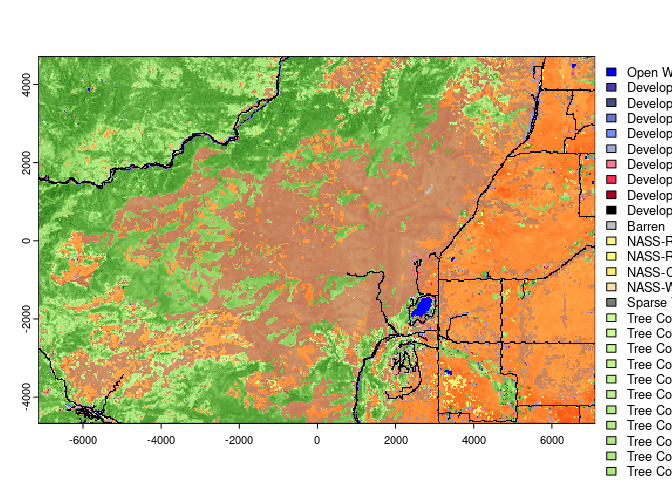

verbose = FALSE)When we read in and plot the EVC layer the legend will now list the
classnames for each vegetation type.
lf_cat <- file.path(tempdir(), "lf_cat")
utils::unzip(resp$path, exdir = lf_cat)
evc <- terra::rast(list.files(lf_cat, pattern = ".tif$",
full.names = TRUE,
recursive = TRUE))
plot(evc)
