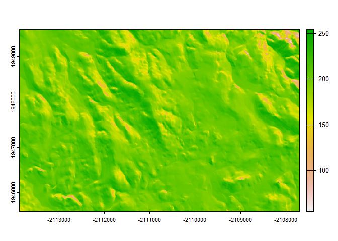

We will download the US NED CHILI (Continuous Heat-Insolation Load Index) https://developers.google.com/earth-engine/datasets/catalog/CSP_ERGo_1_0_US_CHILI. We specify an equal-area coordinate reference system (NAD83 Albers), bilinear resampling, and a resolution of 10 meters.
x <- 'CSP/ERGo/1_0/US/CHILI' |>
gd_image_from_id() |>
gd_download(
filename = 'image.tif',
region = r,
crs = "EPSG:5070",
resampling = "bilinear",
scale = 10, # scale=10: request ~10m resolution
overwrite = TRUE,
silent = FALSE
)We can inspect our results with {terra}. The resulting GeoTIFF has two layers, "constant" and "FILL_MASK". The former contains the data, and the latter contains a mask reflecting data availability (value = 1 where data are available).
library(terra)
#> terra 1.7.65
f <- rast(x)
f
#> class : SpatRaster
#> dimensions : 402, 618, 2 (nrow, ncol, nlyr)
#> resolution : 10, 10 (x, y)
#> extent : -2113880, -2107700, 1945580, 1949600 (xmin, xmax, ymin, ymax)
#> coord. ref. : NAD83 / Conus Albers (EPSG:5070)
#> source : image.tif
#> names : constant, FILL_MASK
plot(f[[1]])

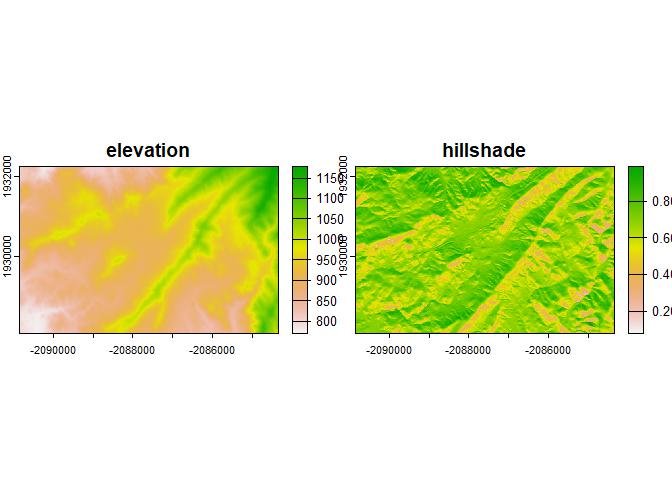

This example demonstrates the download of a section of the USGS NED seamless 10m grid. This DEM is processed locally with {terra} to calculate some terrain derivatives (slope, aspect) and a hillshade.
library(rgeedim)
library(terra)
gd_initialize()
b <- gd_bbox(
xmin = -120.296,
xmax = -120.227,
ymin = 37.9824,
ymax = 38.0071
## hillshade example
# download 10m NED DEM in AEA
x <- "USGS/3DEP/10m" |>
gd_download(
region = b,
scale = 10,
crs = "EPSG:5070",
filename = "image.tif",
bands = list("elevation"),
overwrite = TRUE,
silent = FALSE
dem <- rast(x)$elevation
# calculate slope, aspect, and hillshade with terra
slp <- terrain(dem, "slope", unit = "radians")
asp <- terrain(dem, "aspect", unit = "radians")
hsd <- shade(slp, asp)
# compare elevation vs. hillshade
plot(c(dem, hillshade = hsd))
Subsets of the "USGS/3DEP/10m" image result in multi-band GeoTIFF with "elevation" and "FILL_MASK" bands. In the contiguous US we know the DEM is continuous so the FILL_MASK is not that useful. With geedim >1.7 we retrieve only the "elevation" band by specifying argument bands = list("elevation"). This cuts the raw image size that we need to download in half.

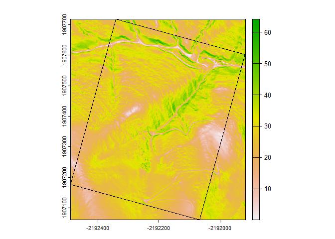

This example demonstrates how to access 1-meter LiDAR data from the USGS 3D Elevation Program (3DEP).
There are other methods to derive an area of interest from existing spatial data sources, here we use gd_region() on a SpatVector object and pass resulting object to several functions that require a processing extent.
LiDAR data are not available everywhere, and are generally available as collections of (tiled) layers. Therefore we use gd_search() to narrow down the options. The small sample extent covers only one tile. Additional filters on date and data quality are also possible with gd_search(). A key step in this process is the use of gd_composite() to resample the component images of interest from the collection on the server-side.

x <- a |>
gd_composite(resampling = "bilinear") |>
gd_download(region = r,
crs = "EPSG:5070",
scale = 1,
overwrite = TRUE,
silent = FALSE) |>
rast()
# inspect
plot(terra::terrain(x$elevation))
plot(project(b, x), add = TRUE)

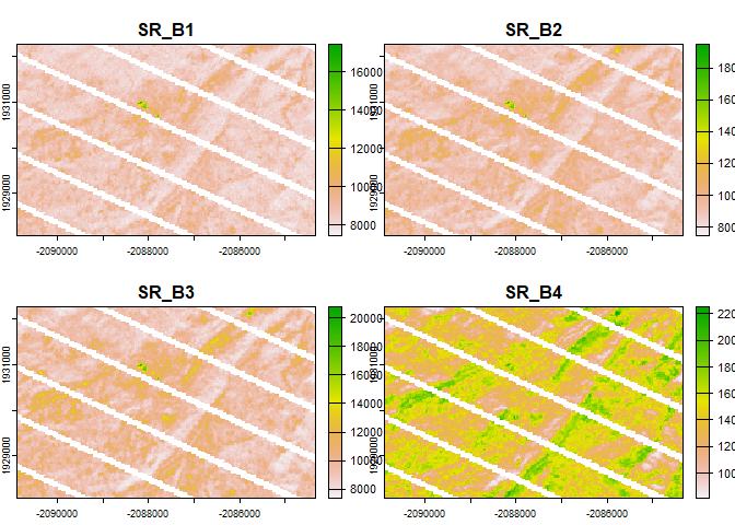

# download a single image, no compositing
y <- gd_properties(x)$id[1] |>
gd_download(
region = b,
scale = 30,
crs = 'EPSG:5070',
dtype = 'uint16',
overwrite = TRUE,
silent = FALSE
plot(rast(y)[[1:4]])
Now we have several images of interest, and also major issues with some of the inputs. In this case there were failures of sensors on the Landsat satellite, but other data gaps may occur due to masked cloudy areas or due to patchy coverage of the source product.

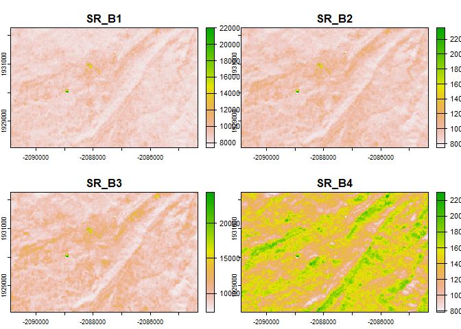

# create composite landsat image near December 1st, 2020 and download
# using q-mosaic method.
z <- x |>
gd_composite(
method = "q-mosaic",
date = '2020-12-01'
gd_download(
region = b,
scale = 30,
crs = 'EPSG:5070',
dtype = 'uint16',
overwrite = TRUE,
silent = FALSE
plot(rast(z)[[1:4]])
The "q-mosaic" method produces a composite (largely) free of artifacts in this case; this is because it prioritizes pixels with higher distance from clouds to fill in the gaps. Other methods are available such as "medoid"; this may give better results when compositing more contrasting inputs such as several dates over a time period where vegetation or other cover changes appreciably.
