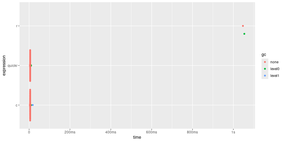

Let’s benchmark it! For reference, we’ll also compare it to a pure-C
implementation.

a <- runif (100000); b <- runif (100)
timings <- bench::mark(
r = slow_convolve(a, b),
quickr = quick_convolve(a, b),
c = convolve_c(a, b),
min_time = 2
timings
#> # A tibble: 3 × 6
#> expression min median `itr/sec` mem_alloc `gc/sec`
#> <bch:expr> <bch:tm> <bch:tm> <dbl> <bch:byt> <dbl>
#> 1 r 1.05s 1.05s 0.955 847KB 0.955
#> 2 quickr 4.8ms 5.09ms 195. 782KB 3.07
#> 3 c 4.73ms 5.04ms 196. 782KB 3.09
plot(timings) + bench::scale_x_bench_time(base = NULL)
In the case of convolve(), quick() returns
a function approximately 200 times quicker, giving similar
performance to the C function.

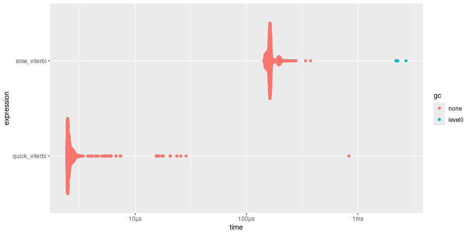

type(y = double(n+2)))viterbiThe Viterbi algorithm is an example of a dynamic programming
algorithm within the family of Hidden Markov Models (https://en.wikipedia.org/wiki/Viterbi_algorithm). Here,
quick() makes the viterbi() approximately 50
times faster.
slow_viterbi = slow_viterbi(observations, states, initial_probs,
transition_probs, emission_probs),
quick_viterbi = quick_viterbi(observations, states, initial_probs,
timings
#> # A tibble: 2 × 6
#> 1 slow_viterbi 143.04µs 162µs 6047. 178KB 14.5
#> 2 quick_viterbi 2.43µs 2.53µs 368609. 0B 0
plot(timings)

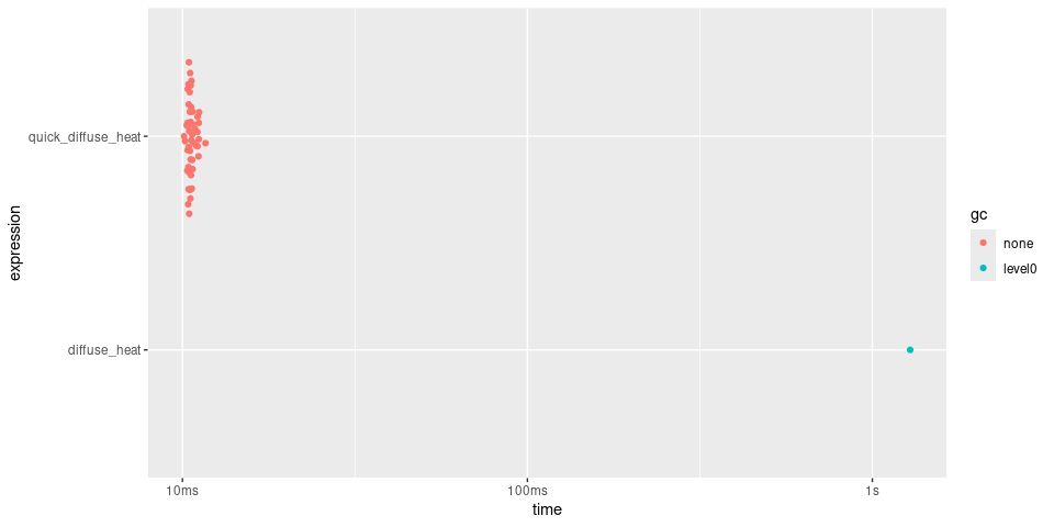

Simulate how heat spreads over time across a 2D grid, using the finite difference method applied to the Heat Equation.
Here, quick() returns a function over 100 time
faster.
diffuse_heat = diffuse_heat(nx, ny, dx, dy, dt, k, steps),
quick_diffuse_heat = quick_diffuse_heat(nx, ny, dx, dy, dt, k, steps)
#> Warning: Some expressions had a GC in every iteration; so filtering is
#> disabled.
summary(timings, relative = TRUE)
#> disabled.
#> <bch:expr> <dbl> <dbl> <dbl> <dbl> <dbl>
#> 1 diffuse_heat 127. 122. 1 1014. Inf
#> 2 quick_diffuse_heat 1 1 121. 1 NaN
plot(timings)

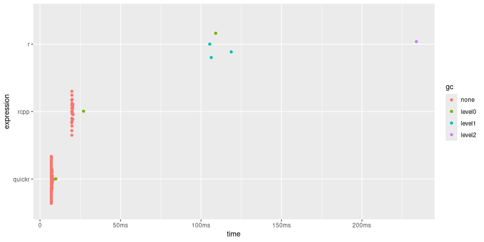

Here is quickr used to calculate a rolling mean. Note that the CRAN package RcppRoll already provides a highly optimized rolling mean, which we include in the benchmarks for comparison.
r = slow_roll_mean(x, weights),
rcpp = RcppRoll::roll_mean(x, weights = weights),
quickr = quick_roll_mean(x, weights = weights)
#> disabled.
timings
#> 1 r 105.4ms 109.13ms 7.42 124.31MB 22.3
#> 2 rcpp 19.7ms 19.84ms 49.4 4.44MB 1.98
#> 3 quickr 7ms 7.09ms 138. 781.35KB 2.00
timings$expression <- factor(names(timings$expression), rev(names(timings$expression)))
