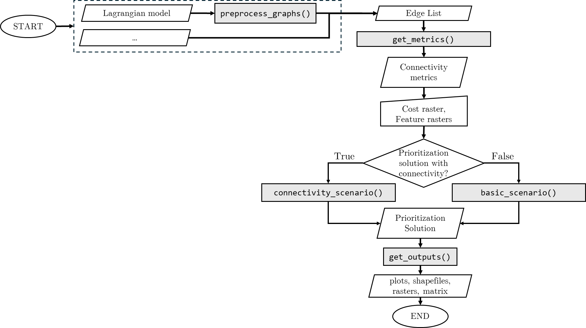

This workflow is shown on Fig. 1.
Fig. 1: Flow chart of the priorCON prioritization analysis. priorCON functions are indicated in grey boxes

The package provides 4 steps to perform the analysis:
Preprocessing (Optional): Function
preprocess_graphs() is built in order to create edge lists
from various inputs formats.
Connectivity metrics estimation: Function
get_metrics() is built to calculate the following graph
metrics: degree, eigenvector centrality, betweenness centrality, louvain
clustering, walktrap clustering, s-core, PageRank.
Prioritization: Functions basic_scenario() and
connectivity_scenario() are used to insert the data to
prioritizr run the prioritization problem and obtain
the optimum solutions.
Post-processing: Function get_outputs() is used in
order to plot interactive maps and export tables, shapefiles and rasters
of the results

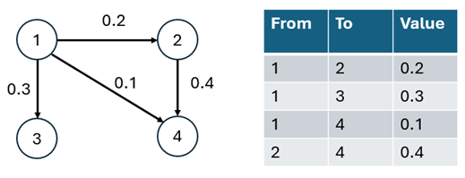

The input of an edge list is required in most graph theoretic
approaches. Fig. 2 represents a typical
directed weighted graph. In the edge list, the first two columns utilize
the nodes IDs to represent edges and the last column corresponds to the
value of the edges. This value actually represents the connectivity
value between the corresponding nodes and may represent for instance
values resulting from particle drift models, migration probabilities or
other. This preprocessing step can be conducted using the function
preprocess_graphs() and serves in reading and transforming
the initial input data into an edge list. Further details on the initial
data formats are given below. In case that an edge list is available,
this step can be skipped.
Fig. 2: Weighted directed graph (left): Circles represent nodes and arrows represent weighted edges. The tabular representation of the graph represents the edge list (right).

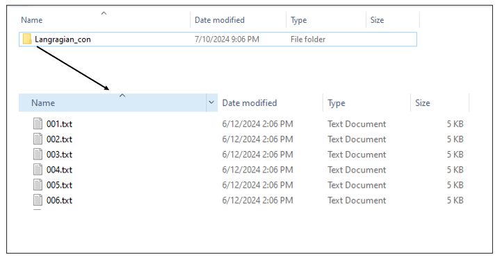

Function preprocess_graphs() takes as input a list of
.txt/.csv objects. Each object represents the connections between a node
and all the other nodes. For the model to read the data, it is necessary
to have all the .txt/.csv objects in one folder. There are two ways to
incorporate connectivity data, based on their linkage to features:
Case 1: the connectivity data correspond to specific biodiversity features. If a biodiversity feature has its own connectivity dataset then the file including the edge lists needs to have the same name as the corresponding feature. For example, consider having 5 species (f1, f2, f3, f4, f5) and 5 connectivity datasets. Then the connectivity datasets need to be in separate folders named: f1,f2,f3,f4,f5 and the algorithm will understand that they correspond to the species.
Case 2: the connectivity dataset represents a spatial pattern that is not directly connected with a specific biodiversity feature. Then the connectivity data need to be included in a separate folder named in a different way than the species. For example consider having 5 species (f1,f2,f3,f4,f5) and 1 connectivity dataset. This dataset can be included in a separate folder (e.g. “Langragian_con”).
In our example we use connectivity values that are not directly connected with a specific species, therefore we illustrate Case 2. Fig. 3 represents the structure used in the tutorial. The data need to be stored in this way in order for the algorithm to read them properly.
Fig. 3: Connectivity folder

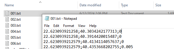

A typical Lagrangian output is a set of files representing the likelihood of a point moving from an origin (source) to a destination (target). This can be represented using a list of .txt files (as many as the origin points) including information for the destination probability. The .txt files need to be named in an increasing order. The name of the files need to correspond to the numbering of the points, in order for the algorithm to match the coordinates with the points (Fig. 4).
Fig. 4: The 001.txt file contains the following information: Each row represents the probability of movement between point 001 and any other destination points.
As long as the data are set in this way, the preprocessing algorithm can run and transform the format of the inputs to an edge list. If an edge list dataset is available, this preprocessing step can be skipped.

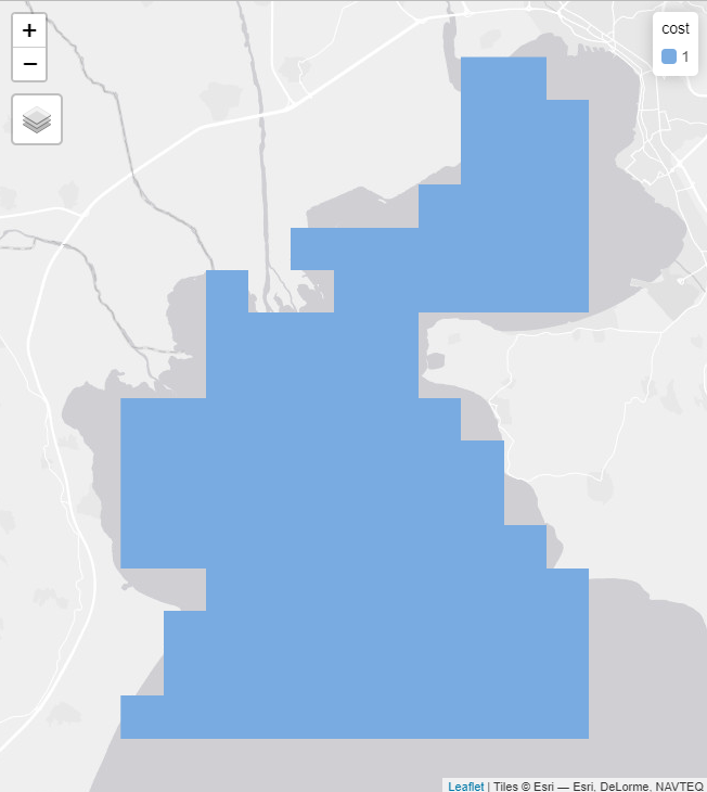

The first input that can be given to the algorithm is a typical cost layer representing the cost of protecting each single planning unit. This cost layer is inserted to prioritizr. If such a cost layer is not available, a cost layer with all planning units having equal cost can be inserted (Fig. 5. The algorithm needs a cost layer, in order to determine the planning units.
# Set tmap to “view” mode
tmap_mode("view")
# Read the cost raster
cost_raster <- get_cost_raster()
# Plot the cost raster with tmap
tm_shape(cost_raster) +
tm_raster(col.legend = tm_legend(title = "cost",
position = c("right", "top")))## The visual variable "col" of the layer "raster" contains a unique value. Therefore a discrete scale is applied (tm_scale_discrete).
Fig. 5: Cost raster

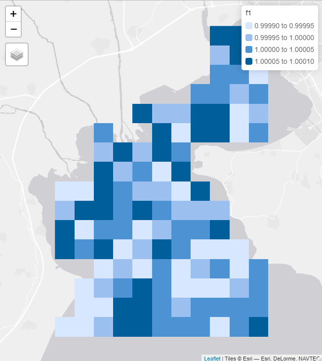

The second input are the features rasters. In case such rasters are not available, a raster with equal values can be given to the algorithm. In this case we have used such a pseudo-raster, adding some noise to improve the performance of the algorithm.
# Read the features raster
features <- get_features_raster()
# Plot the features raster with tmap
tm_shape(features) +
tm_raster(col.legend = tm_legend(title = "f1",
Fig. 6: Features raster

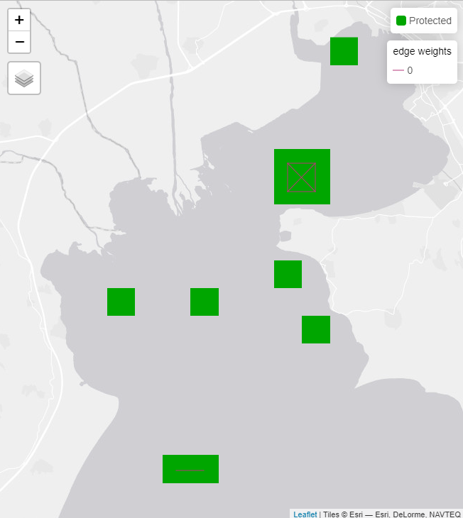

# Get outputs from basic_scenario function for feature “f1”
basic_outputs <- get_outputs(solution = basic_solution,
feature = "f1",
pre_graphs = pre_graphs)
basic_outputs$tmapThe visual variable "col" of the layer "lines" contains a unique value. Therefore a discrete scale is applied (tm_scale_discrete).
Fig. 7: Basic solution with connections shown
# Print summary of features and connections held
# percentages for basic scenario
print(basic_outputs$connectivity_table)## feature relative_held connections(%)

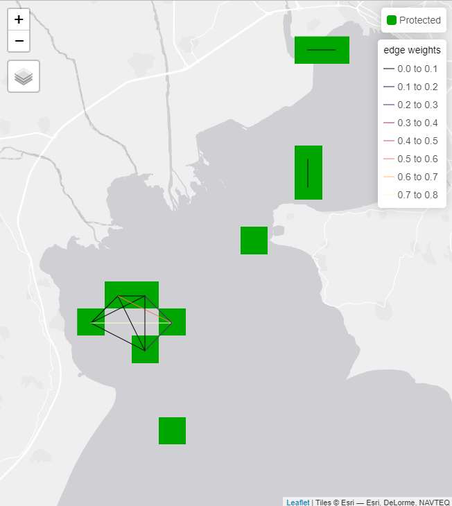

## 1 f1 0.178563 0# Get outputs from connectivity_scenario function for feature “f1”
connectivity_outputs <- get_outputs(solution = connectivity_solution,
feature = "f1",
connectivity_outputs$tmap
Fig. 8: Connectivity solution with connections shown
# Print summary of features and connections held percentages
# for connectivity scenario
print(connectivity_outputs$connectivity_table)## feature relative_held connections(%)
## 1 f1 0.1637209 0.3339886Csárdi, Gábor, and Tamás Nepusz. 2006. “The igraph software package for complex network research.” InterJournal Complex Systems: 1695. https://igraph.org
