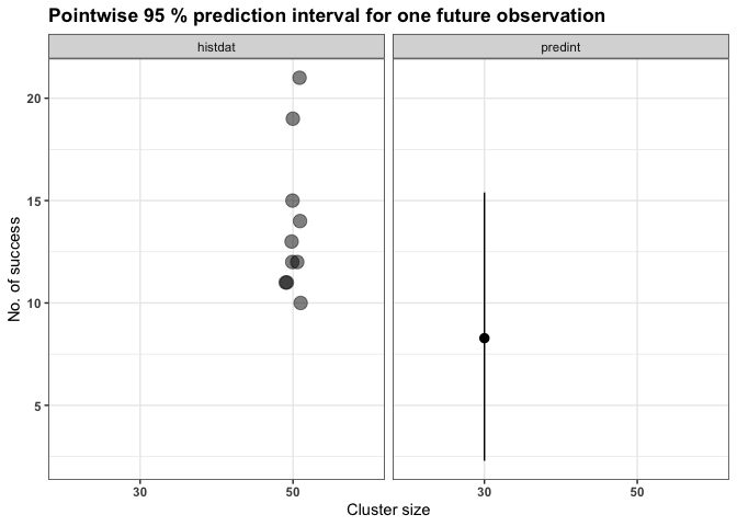

# PI for one future control group comprised of 30 mice
pi_m1 <- quasi_bin_pi(histdat=mortality_HCD,
newsize=30,
traceplot = FALSE,
alpha=0.05,
algorithm="MS22mod")
pi_m1
#> Pointwise 95 % prediction interval for one future observation
#> lower upper newsize
#> 1 2.288892 15.39607 30The mortality of a concurrent control group is in line with the historical knowledge, if it is not lower than 2.289 or higher than 2.289.
A graphical overview about the prediction interval can be given with
