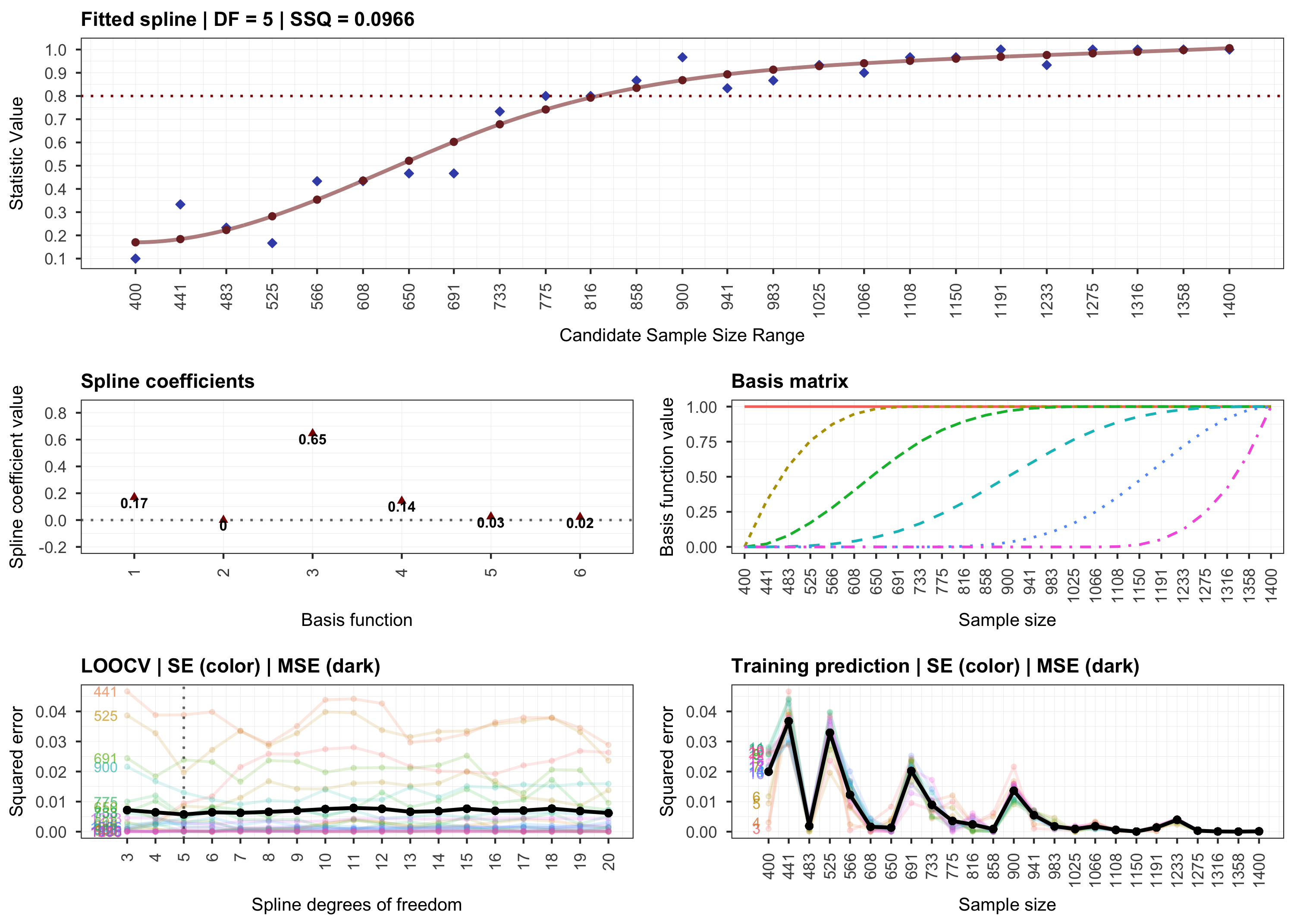

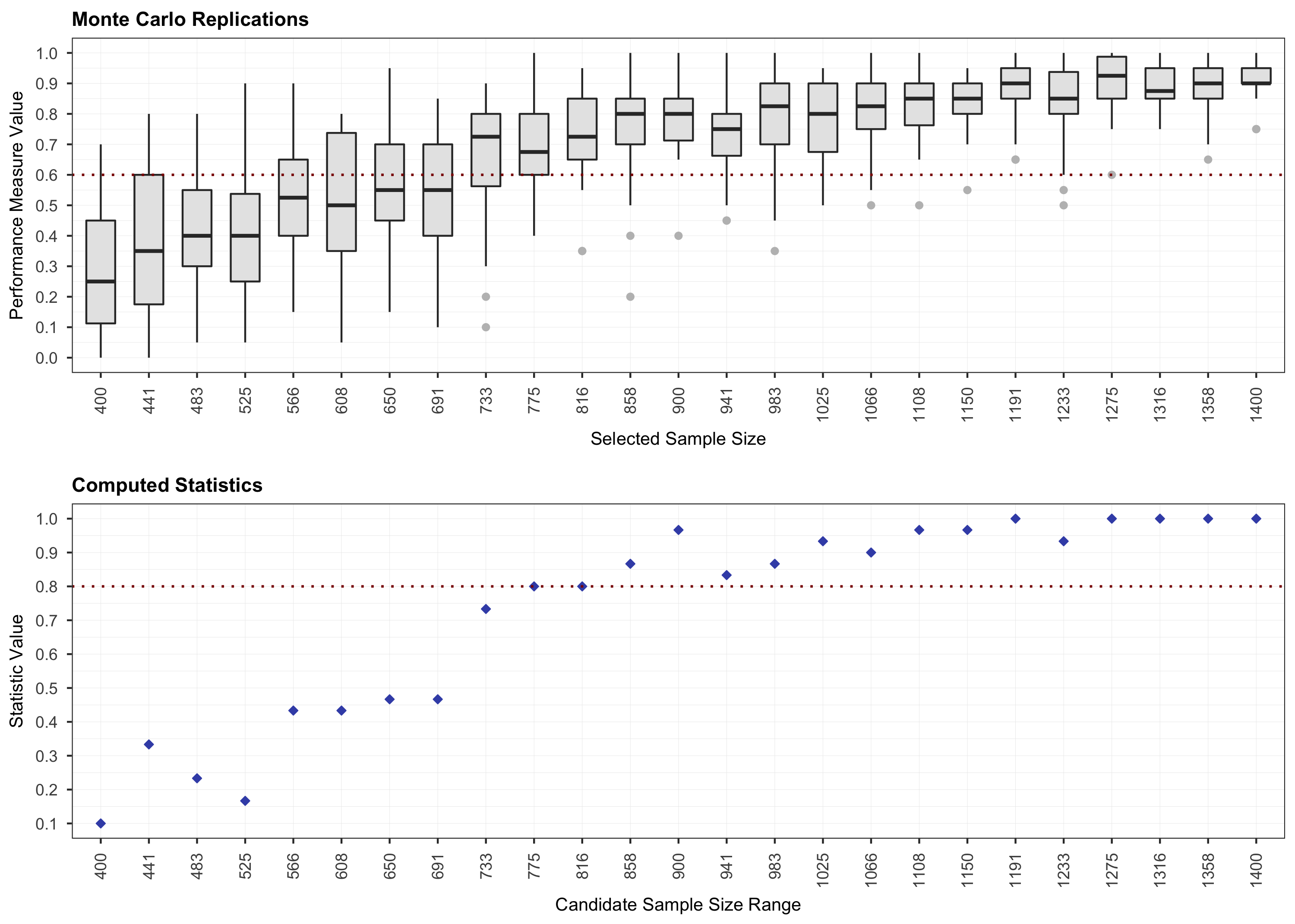

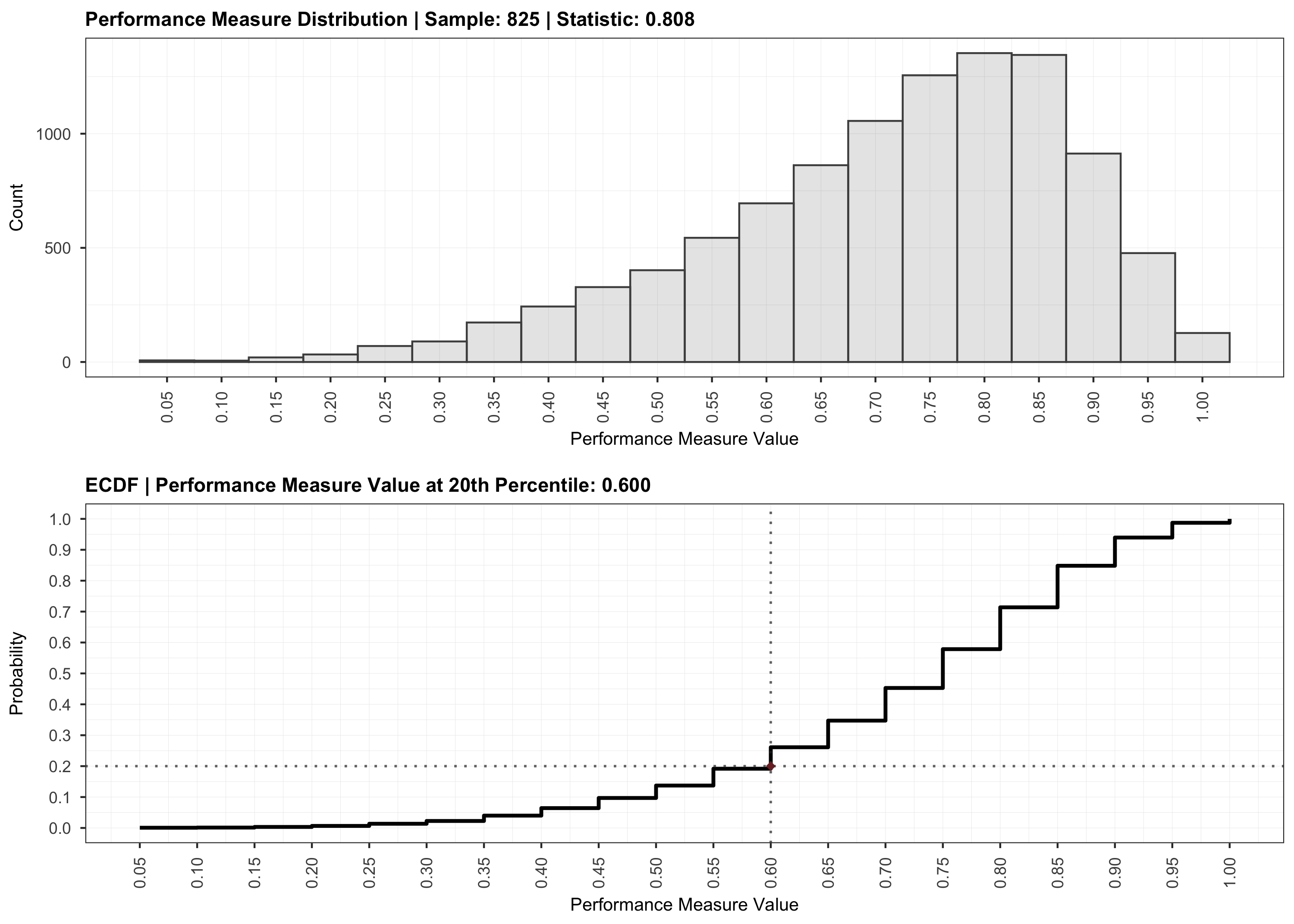

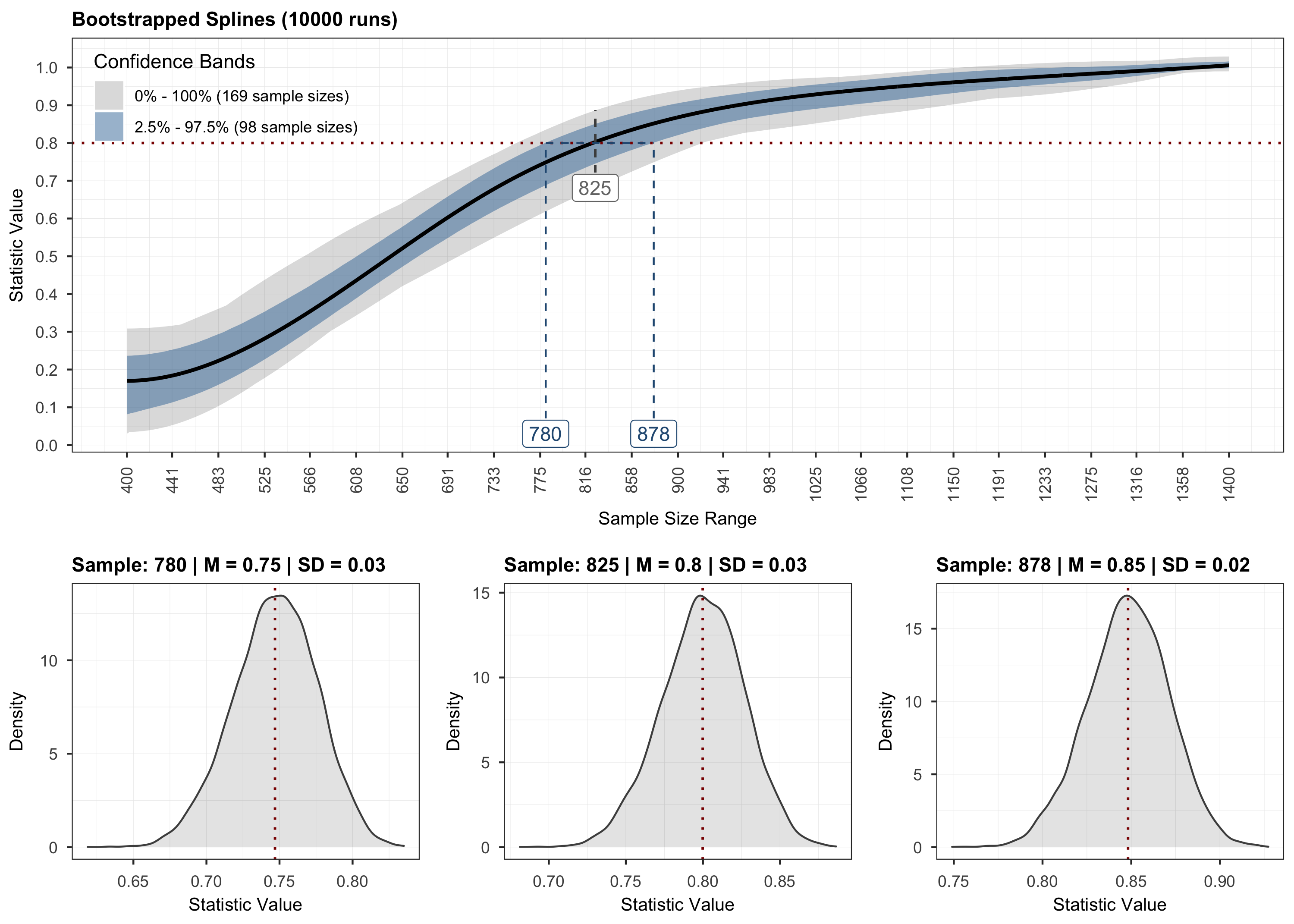

validation <- validate(results)To visualize the results, we can use the plot function
and indicate the step that should be plotted.
# Step 1.
plot(results, step = 1)
# Step 2.
plot(results, step = 2)
# Step 3.
plot(results, step = 3)
# Validation.
plot(validation)
