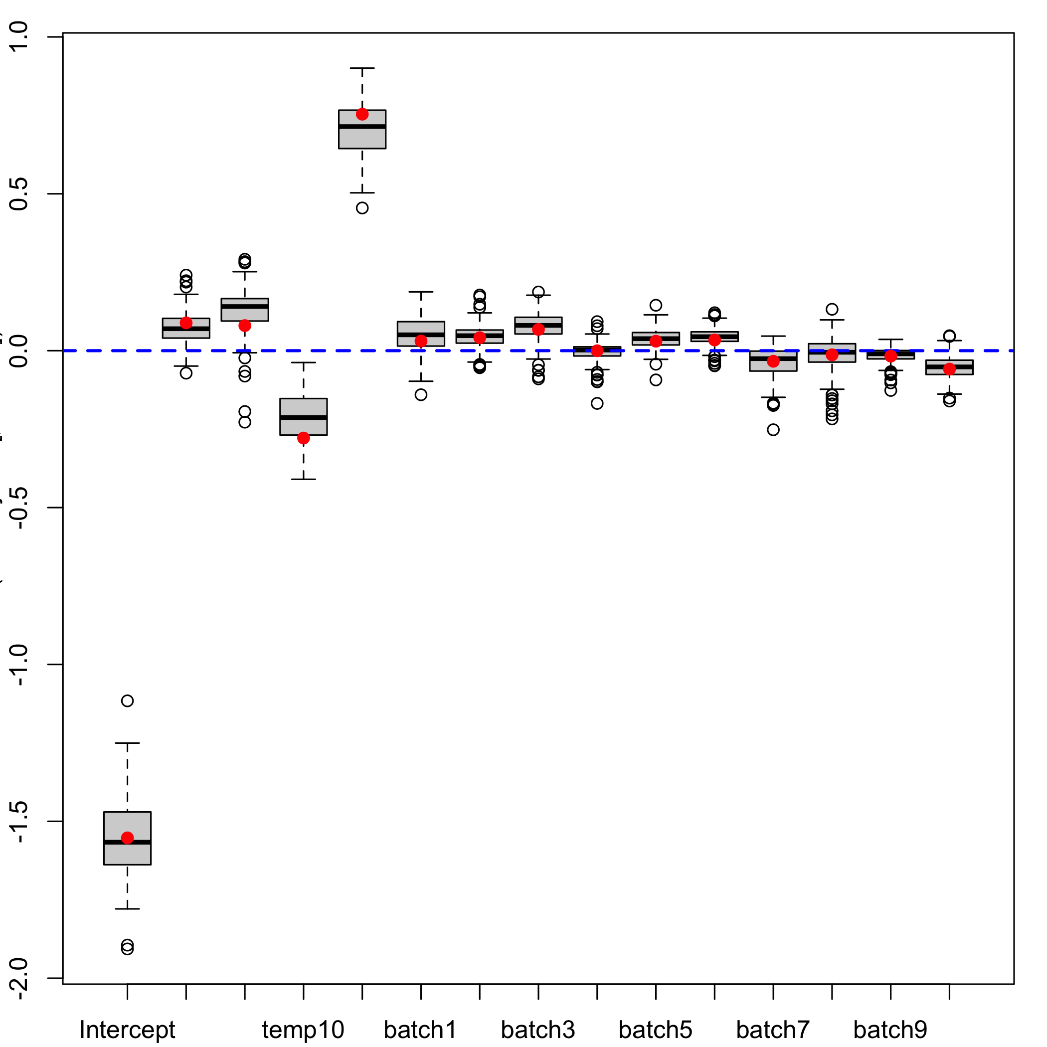

Computing bootstrap distributions
data("GasolineYield",package="betareg")
set.seed(1)
GazYield.boot <- bootplsbeta(modpls, sim="ordinary", stype="i", R=250)Boxplots of the bootstrap distributions
plsRglm::boxplots.bootpls(GazYield.boot)

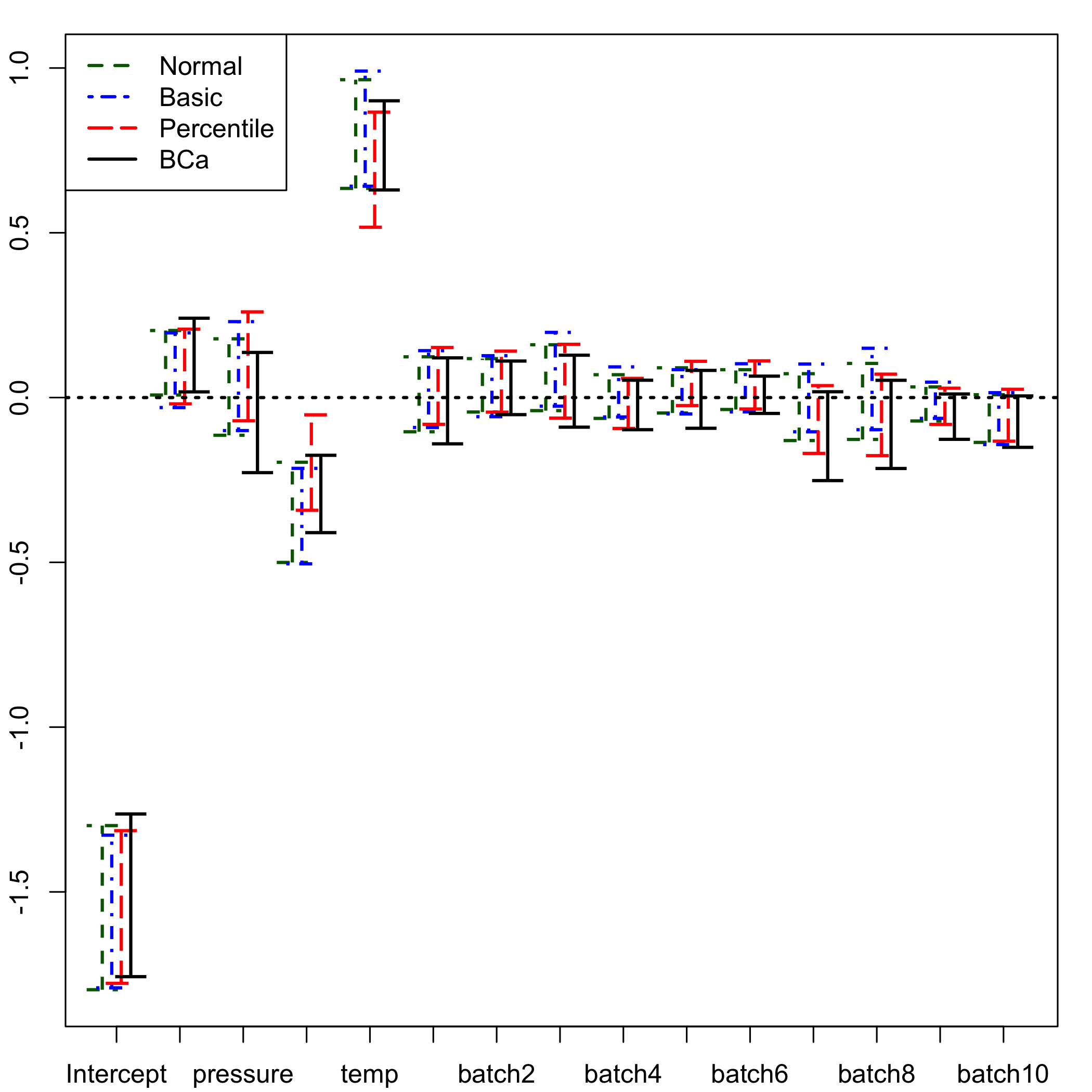

Confidence intervals for the coefficients of the model based on the bootstrap distributions
plsRglm::confints.bootpls(GazYield.boot)
#> Intercept -1.796887447 -1.298797470 -1.79109655
#> gravity 0.007803426 0.203529463 -0.03031919
#> pressure -0.114413178 0.178241939 -0.10016933
#> temp10 -0.500300165 -0.196296503 -0.50450721
#> temp 0.634667387 0.964477695 0.64140043
#> batch1 -0.103808147 0.123669771 -0.09078670
#> batch2 -0.043844906 0.118181125 -0.05804124
#> batch3 -0.039650496 0.160223180 -0.02620071
#> batch4 -0.063189142 0.069329059 -0.05878901
#> batch5 -0.046868693 0.090317880 -0.04970864
#> batch6 -0.036189372 0.084497622 -0.04342852
#> batch7 -0.130445774 0.072421206 -0.10384760
#> batch8 -0.127087903 0.103619226 -0.09754607
#> batch9 -0.070998169 0.032240075 -0.06309787
#> batch10 -0.136043809 0.008565401 -0.14272981
#> Intercept -1.32785762 -1.77750018 -1.31426124 -1.75724986
#> gravity 0.19625824 -0.01907056 0.20750687 0.01728695
#> pressure 0.23040737 -0.07051412 0.26006259 -0.22781373
#> temp10 -0.21483215 -0.34203983 -0.05236477 -0.40987882
#> temp 0.99074204 0.51679514 0.86613674 0.62994281
#> batch1 0.14234706 -0.08117396 0.15195980 -0.14041823
#> batch2 0.12705691 -0.04422306 0.14087509 -0.05179246
#> batch3 0.19773676 -0.06227605 0.16166141 -0.08981571
#> batch4 0.09310470 -0.09365068 0.05824304 -0.09749153
#> batch5 0.08458056 -0.02424531 0.11004389 -0.09315423
#> batch6 0.10265439 -0.03466126 0.11142165 -0.04818180
#> batch7 0.10180298 -0.16937270 0.03627788 -0.25198453
#> batch8 0.14968985 -0.17621892 0.07101700 -0.21517753
#> batch9 0.04674180 -0.08148215 0.02835751 -0.12674384
#> batch10 0.01478130 -0.13233313 0.02517798 -0.15107466
#> Intercept -1.263641413
#> gravity 0.240794215
#> pressure 0.136939906
#> temp10 -0.175141922
#> temp 0.900503031
#> batch1 0.120479458
#> batch2 0.110789411
#> batch3 0.128573856
#> batch4 0.052650981
#> batch5 0.082446108
#> batch6 0.065003348
#> batch7 0.017661871
#> batch8 0.052435236
#> batch9 0.010888555
#> batch10 0.004957851
#> attr(,"typeBCa")
#> [1] TRUEPlot of the confidence intervals for the coefficients of the model based on the bootstrap distributions
plsRglm::plots.confints.bootpls(plsRglm::confints.bootpls(GazYield.boot))
