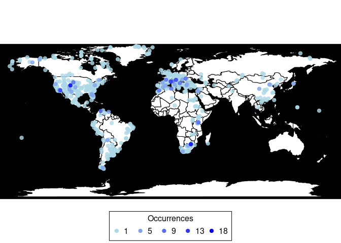

pbdb_mapPlots a map showing fossil occurrences and invisibly returns a data frame with the number of occurrences per coordinate.
#> lng lat Occur
#> -70.583885.-52.415833 -70.583885 -52.415833 1
#> -69.583336.-52.166668 -69.583336 -52.166668 1
#> -70.060555.-52.054722 -70.060555 -52.054722 1
#> -70.174446.-51.74778 -70.174446 -51.747780 1
#> -72.599998.-51.051388 -72.599998 -51.051388 1
#> 22.033333.46.966667 22.033333 46.966667 11
#> 11.25.45.416668 11.250000 45.416668 12
#> -117.33.900002 -117.000000 33.900002 13
#> 5.395.43.686111 5.395000 43.686111 14
#> -105.699997.39.299999 -105.699997 39.299999 15
#> 27.7208.-26.016701 27.720800 -26.016701 18

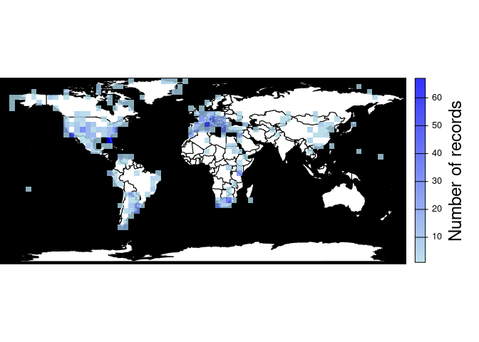

pbdb_map_occurReturns a map and a raster object with the sampling effort (number of fossil records per cell). The user can change the resolution of the cells.
#> class : SpatRaster
#> dimensions : 34, 74, 1 (nrow, ncol, nlyr)
#> resolution : 5, 5 (x, y)
#> extent : -180, 190, -85.19218, 84.80782 (xmin, xmax, ymin, ymax)
#> coord. ref. : lon/lat WGS 84
#> source(s) : memory
#> name : sum
#> min value : 1
#> max value : 67

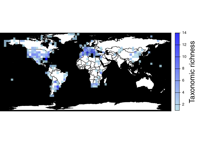

pbdb_map_richnessReturns a map and a raster object with the number of different species, genera, family, etc. per cell. As with pbdb_map_occur(), the user can change the resolution of the cells.
#> name : sum
#> min value : 1
#> max value : 14
If you do not need the plot and you are only interested in obtaining a richness raster for some other purposes, you could use the argument do_plot = FALSE. For instance, this returns the same raster object as above (a SpatRaster object from the terra package) without plotting it:
pbdb_map_richness(canidae, res = 5, rank = "species", do_plot = FALSE)
#> name : sum
#> min value : 1
#> max value : 14The do_plot argument is available in all the functions in the package that produce a plot and return an object. This means that the plot is optional in all the other plotting functions that are described here. Check their documentation for more details.

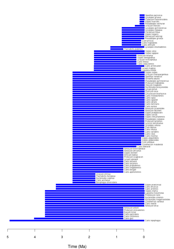

pbdb_temp_rangeReturns a data frame and a plot with the time span of the species, genera, families, etc. in your query. Make sure that enough vertical space is provided in the graphics device used to do the plotting if there are many taxa of the specified rank in your data set.
#> max min
#> Canis lepophagus 4.900 0.0120
#> Canis gezi 4.000 0.7810
#> Canis chihliensis 3.600 0.7810
#> Canis palmidens 3.600 0.7810
#> Eucyon minor 3.600 0.7810
#> Urocyon littoralis 0.300 0.0000
#> Pseudalopex sechurae 0.126 0.0117
#> Vulpes macrotis 0.126 0.0117
#> Cubacyon transversidens 0.126 0.0000
#> Lycalopex griseus 0.126 0.0000
#> Speothos pacivorus 0.126 0.0000

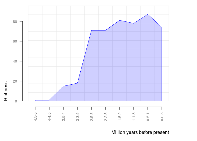

pbdb_richnessReturns a data frame and a plot with the number of species (or genera, families, etc.) across time. You should set the temporal extent and the temporal resolution for the steps.
#> temporal_intervals richness
#> 1 0-0.5 74
#> 2 0.5-1 87
#> 3 1-1.5 78
#> 4 1.5-2 81
#> 5 2-2.5 71
#> 6 2.5-3 71
#> 7 3-3.5 18
#> 8 3.5-4 15
#> 9 4-4.5 1
#> 10 4.5-5 1

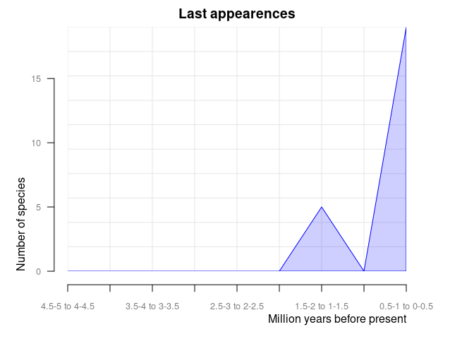

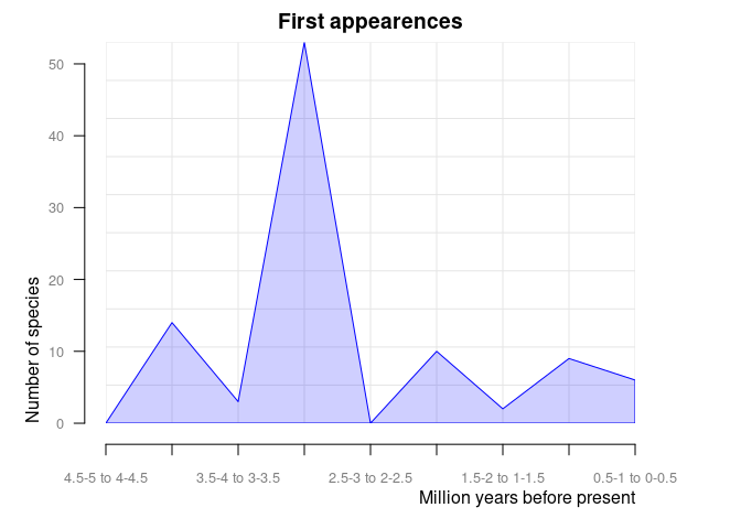

pbdb_orig_extReturns a data frame and a plot with the number of appearances and dissapearances of taxa between consecutive time intervals in the data you provide. These time intervals are defined by the temporal extent (temporal_extent) and resolution (res) arguments. This is another way of visualizing the same information that is shown in the pbdb_temp_range() plot. orig_ext = 1 plots new appearances:
#> new ext
#> 0.5-1 to 0-0.5 6 19
#> 1-1.5 to 0.5-1 9 0
#> 1.5-2 to 1-1.5 2 5
#> 2-2.5 to 1.5-2 10 0
#> 2.5-3 to 2-2.5 0 0
#> 3-3.5 to 2.5-3 53 0
#> 3.5-4 to 3-3.5 3 0
#> 4-4.5 to 3.5-4 14 0
#> 4.5-5 to 4-4.5 0 0
And orig_ext = 2 plots disappearances of taxa between time intervals in the provided data frame.

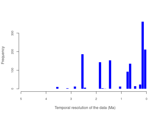

pbdb_temporal_resolutionReturns a plot and a list with a summary of the temporal resolution of the fossil records.
#> $summary
#> Min. 1st Qu. Median Mean 3rd Qu. Max.
#> 0.0117 0.1143 0.6550 0.9617 1.8070 4.8880
#> $temporal_resolution
#> [1] 0.7693 1.5000 1.5000 1.5000 0.7820 0.7820 0.7820 0.7820 1.5000 1.5000
#> [1331] 1.8070 1.8070 1.8070 1.8070 1.8070 2.8190 2.8190 2.8190 2.8190 2.8190
#> [1341] 0.1260 2.5763 1.8070 0.4190 0.4190 0.4190 0.4190 0.4190 3.2190 0.7690
#> [1351] 0.0117 0.0117 0.0117 2.5880 2.5763 2.5763 0.7690 0.7690 0.7690 0.1143
#> [1361] 0.4190 0.1143 0.7690 2.5763 0.1143 0.7690 0.1143 2.5763 0.7690 0.6550
#> [1371] 0.6550 1.8070 2.8190 1.5000 2.5763 2.5763 2.5763 0.1143 2.5763 2.5763
#> [1381] 2.5763 2.5763 0.0117 0.0117
