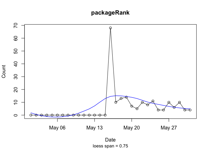

For example, ‘packageRank’ was first published on CRAN on 2019-05-16
- you can verify this via packageHistory("packageRank").
But if you use cranlogs::cran_downloads() or
cranDownloads(pro.mode = TRUE) before that date, you’ll see
zero downloads for dates before 2019-05-16:
cranDownloads("packageRank", from = "2019-05-10", to = "2019-05-16", pro.mode = TRUE)
> date count cumulative package
> 1 2019-05-10 0 0 packageRank
> 2 2019-05-11 0 0 packageRank
> 3 2019-05-12 0 0 packageRank
> 4 2019-05-13 0 0 packageRank
> 5 2019-05-14 0 0 packageRank
> 6 2019-05-15 0 0 packageRank
> 7 2019-05-16 68 68 packageRankYou’ll notice this particularly when one of the packages you’re including newer packages in cranDownloads().

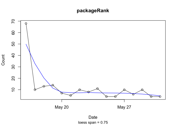

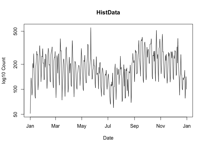

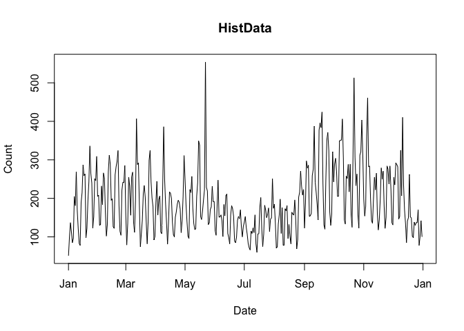

cranDownloads() makes visualizing package downloads easy
by using plot():
plot(cranDownloads(packages = "HistData", from = "2019", to = "2019"))

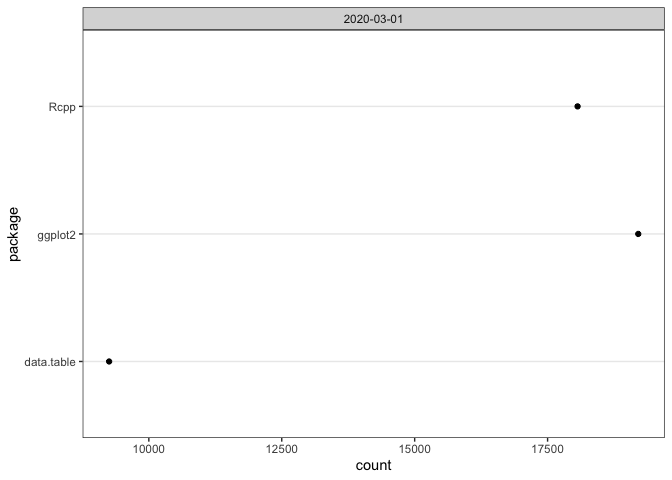

If you pass a vector of package names for a single day,
plot() returns a dotchart:
plot(cranDownloads(packages = c("ggplot2", "data.table", "Rcpp"),
from = "2020-03-01", to = "2020-03-01"))

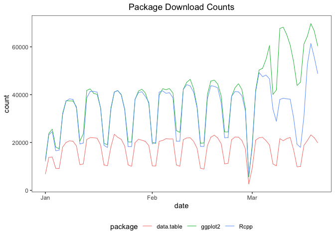

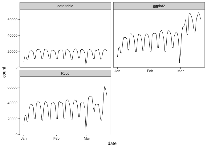

If you pass a vector of package names for multiple days,
plot() uses ‘ggplot2’
facets:
from = "2020", to = "2020-03-20"))
To plot those data in a single frame, set
multi.plot = TRUE:
from = "2020", to = "2020-03-20"), multi.plot = TRUE)

plot(cranDownloads(packages = "HistData", from = "2019", to = "2019"),
log.y = TRUE)

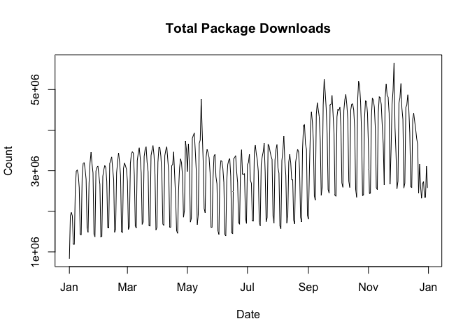

packages = NULLcranlogs::cran_download(packages = NULL) computes the
total number of package downloads from CRAN. You can plot these data by
using:
plot(cranDownloads(from = 2019, to = 2019))

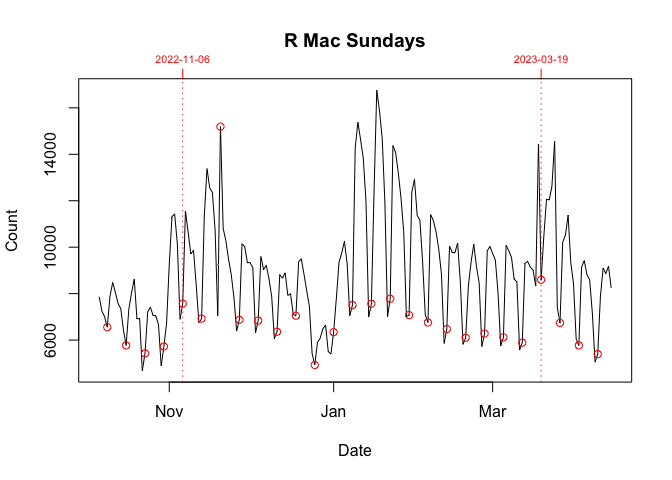

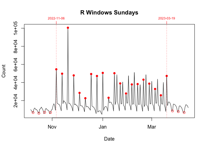

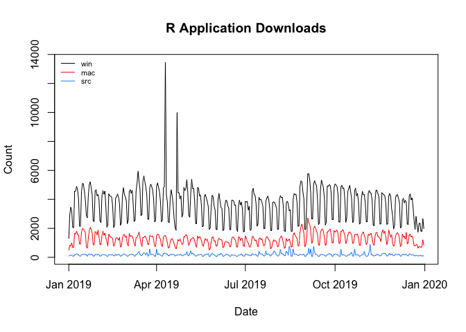

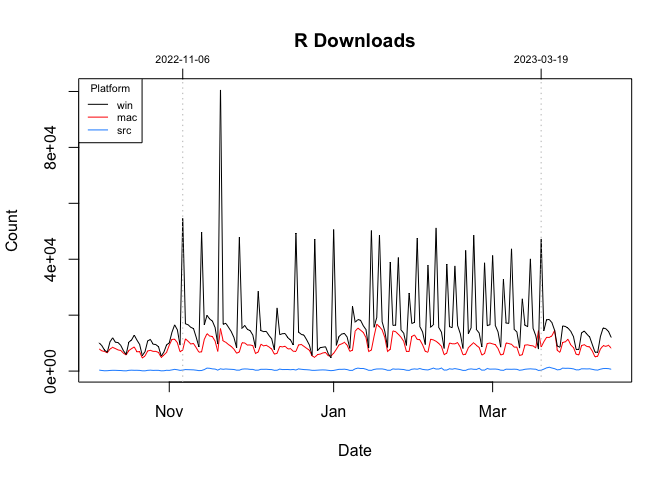

packages = "R"cranlogs::cran_download(packages = "R") computes the
total number of downloads of the R application (note that you can only
use “R” or a vector of packages names, not both!). You can plot these
data by using:
plot(cranDownloads(packages = "R", from = 2019, to = 2019))
If you want the total count of R downloads, set
r.total = TRUE:
plot(cranDownloads(packages = "R", from = 2019, to = 2019), r.total = TRUE)Note that since Sunday 06 November 2022 and Wednesday, 18 January 2023, there’ve been spikes of downloads of the Windows version of R on Sundays and Wednesdays (details below in R Windows Sunday and Wednesday downloads).

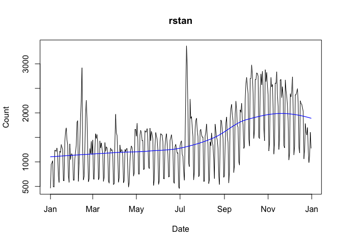

To add a smoother to your plot, use smooth = TRUE:
plot(cranDownloads(packages = "rstan", from = "2019", to = "2019"),
smooth = TRUE)

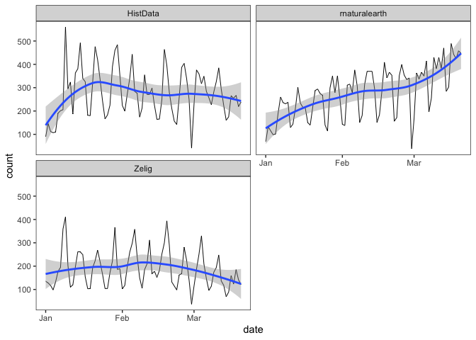

With graphs that use ‘ggplot2’, se = TRUE will add a
confidence interval:
plot(cranDownloads(packages = c("HistData", "rnaturalearth", "Zelig"),
from = "2020", to = "2020-03-20"), smooth = TRUE, se = TRUE)
In general, loess is the chosen smoother. Note that with base
graphics, lowess is used when there are 7 or fewer observations. Thus,
to control the degree of smoothness, you’ll typically use the
span argument (the default is span = 0.75). With base
graphics with 7 or fewer observations, you control the degree of
smoothness using the f argument (the default is f =
2/3):

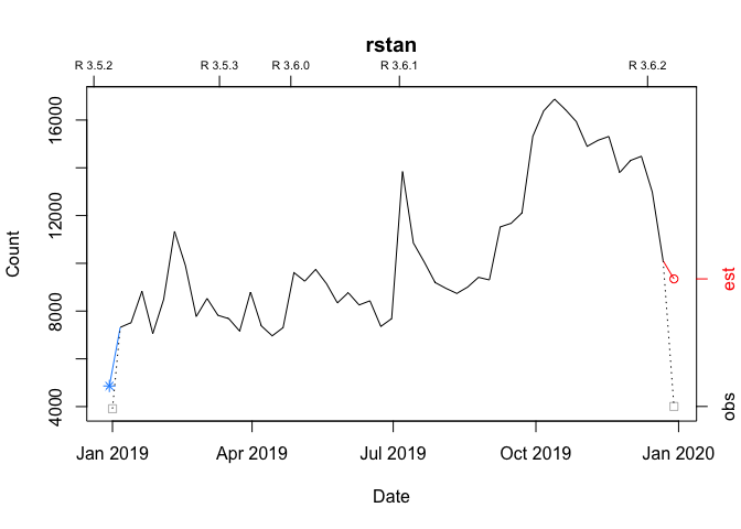

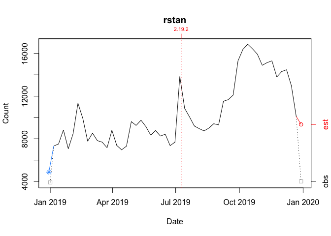

span = 0.33)To annotate a graph with a package’s release dates:
package.version = TRUE, unit.observation = "week")
To annotate a graph with R release dates:
r.version = TRUE, unit.observation = "week")

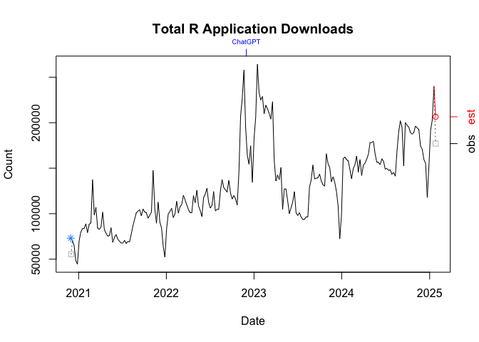

To annotate a graph with ChatGPT release date, 2022-11-30:
plot(cranDownloads(packages = "R", from = "2020-12", to = "2025-01"),
chatgpt = TRUE, r.total = TRUE, unit.observation = "week")

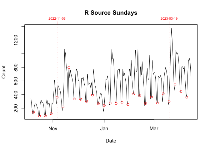

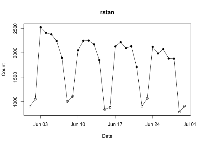

With unit.observation = “day”, you can highlight weekends with an empty circle by setting weekend = TRUE:
plot(cranDownloads(packages = "rstan", from = "2024-06", to = "2024-06"), weekend = TRUE)

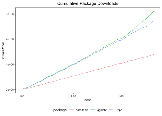

To plot growth curves, set statistic = "cumulative":
from = "2020", to = "2020-03-20"), statistic = "cumulative",
multi.plot = TRUE, points = FALSE)

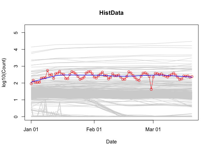

To visualize a package’s downloads relative to “all” other packages over time:
plot(cranDownloads(packages = "HistData", from = "2020", to = "2020-03-20"),
population.plot = TRUE)
This longitudinal view plots the date (x-axis) against the base 10 logarithm of the selected package’s download counts (y-axis). To get a sense of how the selected package’s performance stacks up against “all” other packages, a set of smoothed curves representing a stratified random sample of packages is plotted in gray in the background (this is the “typical” pattern of downloads on CRAN for the selected time period).1

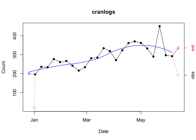

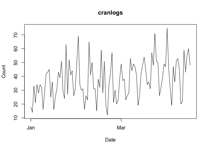

The default unit of observation for both cranDownloads()
and cranlogs::cran_dowanlods() is the day. The graph below
plots the daily downloads for ‘cranlogs’ from
01 January 2022 through 15 April 2022.
plot(cranDownloads(packages = "cranlogs", from = 2022, to = "2022-04-15"))

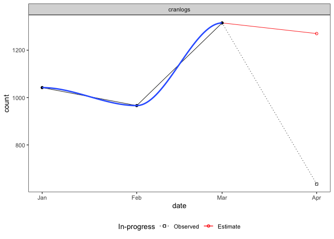

To view the data from a less granular perspective, change
plot.cranDownloads()’s unit.observation argument from “day”
to “week”, “month”, or “year”.
unit.observation = "month"The graph below plots the data aggregated by month (with an added smoother):
plot(cranDownloads(packages = "cranlogs", from = 2022, to = "2022-04-15"),
unit.observation = "month", smooth = TRUE, graphics = "ggplot2")
Three things to note. First, if the last/current month (far right) is still in-progress (it’s not yet the end of the month), that observation will be split in two: one point for the in-progress total (empty black square), another for the estimated total (empty red circle). The estimate is based on the proportion of the month completed. In the example above, the 635 observed downloads from April 1 through April 15 translates into an estimate of 1,270 downloads for the entire month (30 / 15 * 635). Second, if a smoother is included, it will only use “complete” observations, not in-progress or estimated data. Third, all points are plotted along the x-axis on the first day of the month.

Four things to note. First, if the first week (far left) is incomplete (the ‘from’ date is not a Sunday), that observation will be split in two: one point for the observed total on the start date (gray empty square) and another point for the backdated total. Backdating involves completing the week by pushing the nominal start date back to include the previous Sunday (blue asterisk). In the example above, the nominal start date (01 January 2022) is moved back to include data through the previous Sunday (26 December 2021). This is useful because with a weekly unit of observation the first observation is likely to be truncated and would not give the most representative picture of the data. Second, if the last week (far right) is in-progress (the ‘to’ date is not a Saturday), that observation will be split in two: the observed total (gray empty square) and the estimated total based on the proportion of week completed (red empty circle). Third, just like the monthly plot, smoothers only use complete observations, including backdated data but excluding in-progress and estimated data. Fourth, with the exception of first week’s observed count, which is plotted at its nominal date, points are plotted along the x-axis on Sundays, the first day of the week.
For what it’s worth, below are my go-to commands for graphs. They
take advantage of RStudio IDE’s plot history panel, which allows you to
cycle through and compare graphs. Typically, I’ll look at the data for
the last year or so at the three available units of observation: day,
week and month. I use base graphics, via graphics = "base",
to take advantage of prompts and “nicer” axes annotation. This also
allows me to easily add graphical elements afterwards as needed, e.g.,
abline(h = 100, lty = "dotted").
plot(cranDownloads(packages = c("cholera", "packageRank"), from = 2023),
graphics = "base", package.version = TRUE, smooth = TRUE,
unit.observation = "day")
# Note that I disable smoothing for monthly data
graphics = "base", package.version = TRUE, smooth = FALSE,
unit.observation = "month")Perhaps the biggest downside of using cranDownloads(pro.mode = TRUE) is that you might draw mistaken inferences from plotting the data since it adds false zeroes to your data.
Using the example of ‘packageRank’, which was published on 2019-05-16:
plot(cranDownloads("packageRank", from = "2019-05", to = "2019-05",
pro.mode = TRUE), smooth = TRUE)
pro.mode = FALSE), smooth = TRUE)

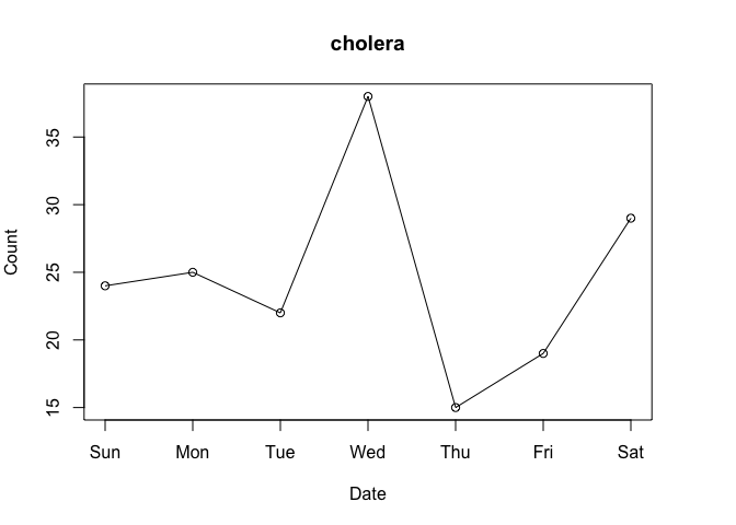

After spending some time with nominal download counts, the “compared to what?” question will come to mind. For instance, consider the data for the ‘cholera’ package from the first week of March 2020:
plot(cranDownloads(packages = "cholera", from = "2020-03-01",
to = "2020-03-07"))
Do Wednesday and Saturday reflect surges of interest in the package or surges of traffic to CRAN? To put it differently, how can we know if a given download count is typical or unusual?

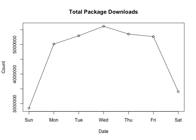

To answer these questions, we can start by looking at the total number of package downloads:
plot(cranDownloads(from = "2020-03-01", to = "2020-03-07"))
Here we see that there’s a big difference between the work week and the weekend. This seems to indicate that the download activity for ‘cholera’ on the weekend seems high. Moreover, the Wednesday peak for ‘cholera’ downloads seems higher than the mid-week peak of total downloads.

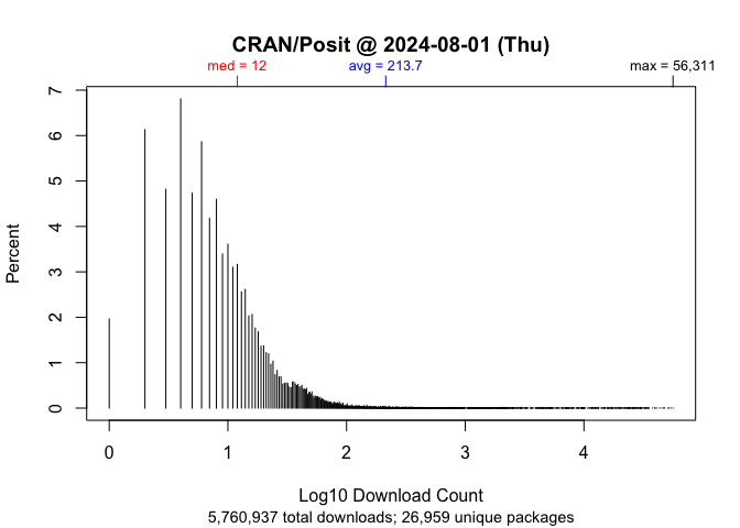

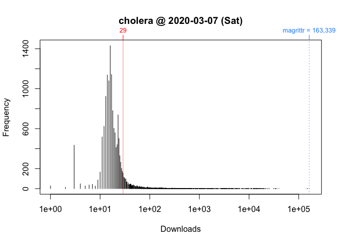

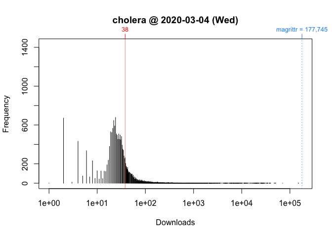

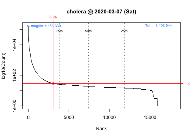

One way to better address these observations is to locate your
package’s download counts in the overall frequency distribution of
download counts. ‘cholera’ allows you to do so via
packageDistribution(). Below are the distributions of
logarithm of download counts for Wednesday and Saturday. Each vertical
segment (along the x-axis) represents a download count. The height of a
segment represents that download count’s frequency. The location of ‘cholera’ in the
distribution is highlighted in red.
plot(packageDistribution(package = "cholera", date = "2020-03-04"))
plot(packageDistribution(package = "cholera", date = "2020-03-07"))
While these plots give us a better picture of where ‘cholera’ is located, comparisons between Wednesday and Saturday are still impressionistic: all we can confidently say is that the download counts for both days were greater than the mode.

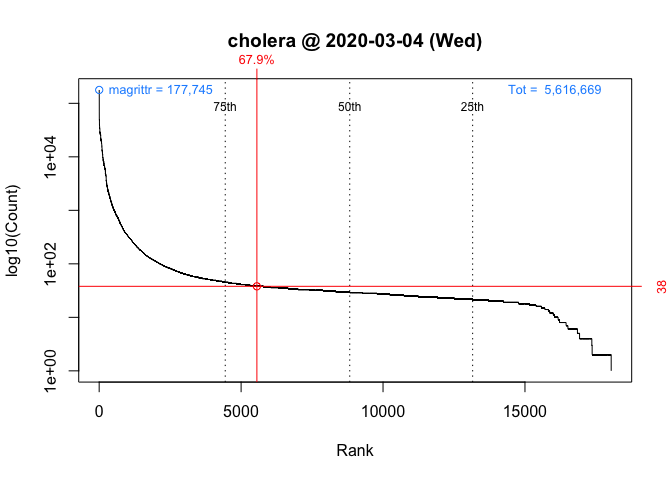

To facilitate interpretation and comparison, I use the percentile rank of a download count instead of the simple nominal download count. This nonparametric statistic tells you the percentage of packages that had fewer downloads. In other words, it gives you the location of your package relative to the locations of all other packages. More importantly, by rescaling download counts to lie on the bounded interval between 0 and 100, percentile ranks make it easier to compare packages within and across distributions.
For example, we can compare Wednesday (“2020-03-04”) to Saturday (“2020-03-07”):
packageRank(package = "cholera", date = "2020-03-04")
> date package count rank percentile
> 1 2020-03-04 cholera 38 5,788 of 18,038 67.9On Wednesday, we can see that ‘cholera’ had 38 downloads, came in 5,788th place out of the 18,038 different packages downloaded, and earned a spot in the 68th percentile.
packageRank(package = "cholera", date = "2020-03-07")
> 1 2020-03-07 cholera 29 3,189 of 15,950 80On Saturday, we can see that ‘cholera’ had 29 downloads, came in 3,189st place out of the 15,950 different packages downloaded, and earned a spot in the 80th percentile.
So contrary to what the nominal counts tell us, one could say that the interest in ‘cholera’ was actually greater on Saturday than on Wednesday.

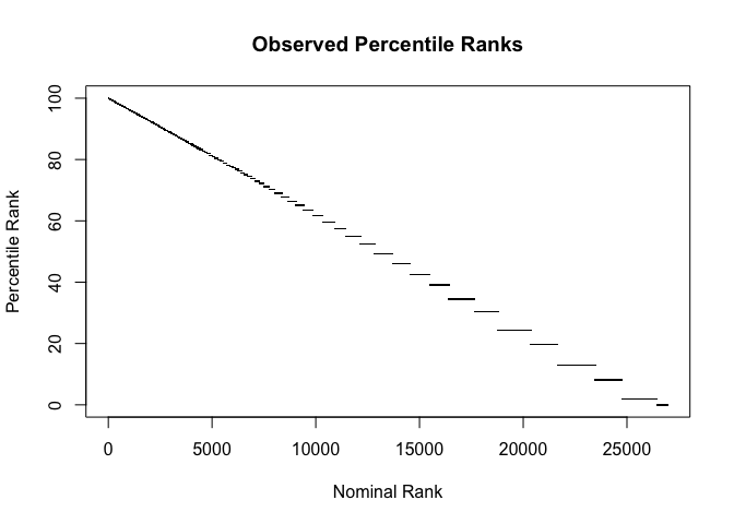

> [1] 67.9In the example above, 38 downloads puts ‘cholera’ in 5,788th place if we allow for ties using competition (i.e., “1224” ranking) and 5,556th place if we don’t by using nominal/ordinal (i.e., “1234” ranking).
Prior to v0.9.2.9008, only nominal/ordinal ranking was available.
Competition ranking is now the default via
packageRank(rank.ties = TRUE). If you want ordinal ranking,
use packageRank(rank.ties = FALSE).
To visualize packageRank(), use plot().
plot(packageRank(packages = "cholera", date = "2020-03-04"))
plot(packageRank(packages = "cholera", date = "2020-03-07"))
These graphs above, which are customized here to be on the same scale, plot the rank order of packages’ download counts (x-axis) against the logarithm of those counts (y-axis). It then highlights (in red) a package’s position in the distribution along with its percentile rank and download count. In the background, the 75th, 50th and 25th percentiles are plotted as dotted vertical lines. The package with the most downloads, ‘magrittr’ in both cases, is at top left (in blue). The total number of downloads is at the top right (in blue).

counts, your choice of percentile may not be available because they may
fall in the vertical gaps in the observed data:
For this reason, queryPercentile() rounds you selection
to whole numbers. Also, the default value, which is set to 50, uses
median()to guarantee a result.

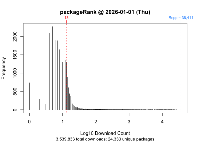

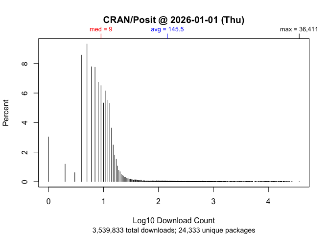

The above functions leverage cranDistribution(), which
computes the ranks and the distribution of download counts for a given
day’s log.
Its print method provides the date, the number of unique packages downloaded, the total number of downloads (the total number of rows/observations in the log) and the count and rank data for the top 20 packages:
cranDistribution()> $date
> [1] "2024-08-01 Thursday"
> $unique.packages.downloaded
> [1] "26,959"
> $total.downloads
> [1] "5,760,937"
> $top.n
> package count rank nominal.rank percentile
> 1 rlang 56311 1 1 100.0
> 2 ggplot2 53981 2 2 100.0
> 3 withr 51577 3 3 100.0
> 4 cli 51509 4 4 100.0
> 5 lifecycle 47771 5 5 100.0
> 6 dplyr 46734 6 6 100.0
> 7 vctrs 45173 7 7 100.0
> 8 jsonlite 43280 8 8 100.0
> 9 Rcpp 40935 9 9 100.0
> 10 tibble 39908 10 10 100.0
> 11 glue 39430 11 11 100.0
> 12 pillar 37875 12 12 100.0
> 13 magrittr 35133 13 13 100.0
> 14 bslib 35106 14 14 99.9
> 15 colorspace 34707 15 15 99.9
> 16 xfun 34442 16 16 99.9
> 17 scales 34052 17 17 99.9
> 18 R6 33516 18 18 99.9
> 19 fansi 33111 19 19 99.9
> 20 stringr 33041 20 20 99.9
Note that if you want to specify the number of top N packages, you’ll have to explicitly use the print() and the ‘top.n’ argument:
print(cranDistribution(), top.n = 7)Alternatively, you can use queryRank():
queryRank(1:7)The summary method provides the number of unique packages downloaded, the total number of downloads and the five number summary (plus the arithmetic mean):
summary(cranDistribution())> $unique.packages.downloaded
> [1] 26959
> $total.downloads
> [1] 5760937
> $download.summary
> Min. 1st Qu. Median Mean 3rd Qu. Max.
> 1.0 6.0 12.0 213.7 28.0 56311.0
The plot method graphs the distribution of base 10 logarithm of download counts. Each plot is annotated with the median, mean and maximum download counts, as well as the total number of downloads and the total number of unique packages observed.
plot(cranDistribution())

Functions that rely on cranlogs::cran_download() (e.g.,
‘packageRank::cranDownloads()’,
‘adjustedcranlogs’
and ‘dlstats’)
are susceptible to the first error - duplicate names. My understanding
is that this is because ‘cranlogs’ uses
the date in a log rather than the filename/URL to retrieve logs. To put
it differently, ‘cranlogs’ can’t
detect multiple instances of logs with the same date. I found 3 logs
with duplicate filename/URLs, and 5 additional instances of overcounting
(including one of tripling). ‘fixCranlogs()’
addresses this overcounting problem behind the scenes by recomputing the
download counts using the actual log(s) when any of the eight
problematic dates are requested. Details about the 8 days and
fixCranlogs() can be found here.

The second data problem is of more recent vintage. From 2023-09-13
through 2023-10-02, the download counts for the R application returned
by cranlogs::cran_downloads(packages = "R"), is, with two
exceptions, twice what one would expect when looking at the actual
log(s). The two exceptions are: 1) 2023-09-28 where the counts are
identical but for a “rounding error” possibly due to NAs and 2)
2023-09-30 where there is actually a three-fold difference.
Here are the relevant ratios of counts comparing ‘cranlogs’ results with counts based on the underlying logs:
2023-09-12 2023-09-13 2023-09-14 2023-09-15 2023-09-16 2023-09-17 2023-09-18 2023-09-19
osx 1 2 2 2 2 2 2 2
src 1 2 2 2 2 2 2 2
win 1 2 2 2 2 2 2 2
2023-09-20 2023-09-21 2023-09-22 2023-09-23 2023-09-24 2023-09-25 2023-09-26 2023-09-27
osx 2 2 2 2 2 2 2 2
src 2 2 2 2 2 2 2 2
win 2 2 2 2 2 2 2 2
2023-09-28 2023-09-29 2023-09-30 2023-10-01 2023-10-02 2023-10-03
osx 1.000000 2 3 2 2 1
src 1.000801 2 3 2 2 1
win 1.000000 2 3 2 2 1
Details and code for replication can be found in issue #69. fixRCranlogs()
corrects the problem

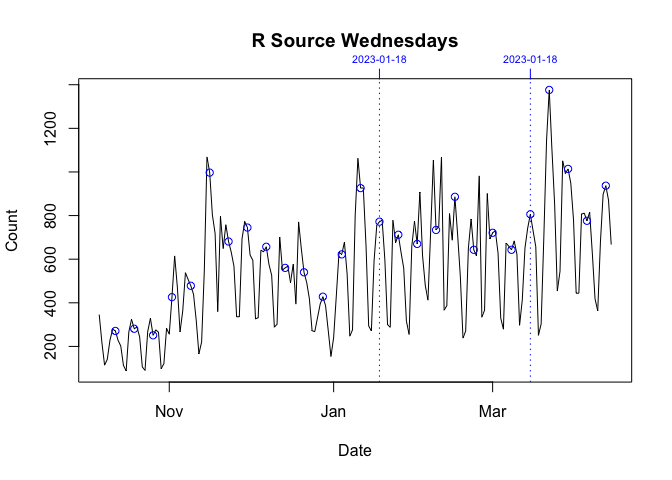

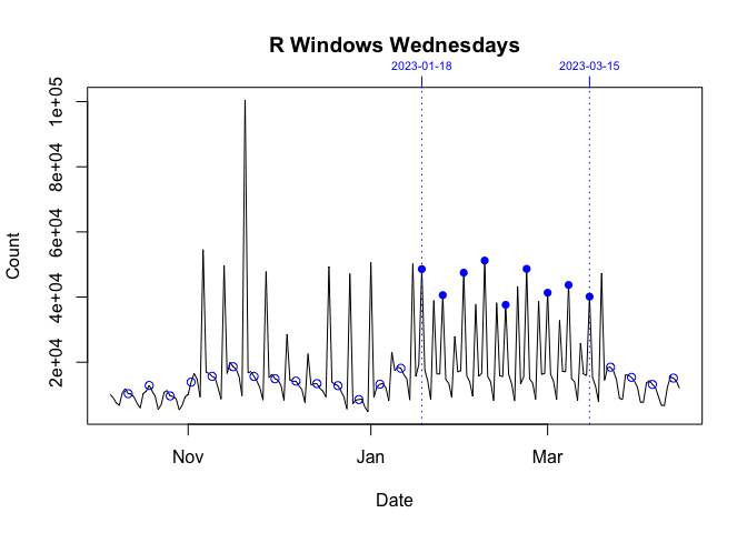

Note that there was a similar issue for package download counts around the same period but that is now fixed in ‘cranlogs’. For details, see issue #68

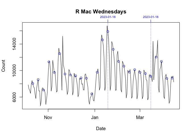

The graph above for R downloads shows the daily downloads of the R application broken down by platform (Mac, Source, Windows). In it, you can see the typical pattern of mid-week peaks and weekend troughs.
Between 06 November 2022 and 19 March 2023, this pattern was broken. On Sundays (06 November 2022 - 19 March 2023) and Wednesdays (18 January 2023 - 15 March 2023), there were noticeable, repeated orders-of-magnitude spikes in the daily downloads of the Windows version of R.
plot(cranDownloads("R", from = "2022-10-06", to = "2023-04-14"))
axis(3, at = as.Date("2022-11-06"), labels = "2022-11-06", cex.axis = 2/3,
padj = 0.9)
axis(3, at = as.Date("2023-03-19"), labels = "2023-03-19", cex.axis = 2/3,
padj = 0.9)
abline(v = as.Date("2022-11-06"), col = "gray", lty = "dotted")
abline(v = as.Date("2023-03-19"), col = "gray", lty = "dotted")
These download spikes did not seem to affect either the Mac or Source versions. I show this in the graphs below. Each plot, which is individually scaled, breaks down the data in the graph above by day (Sunday or Wednesday) and platform.
The key thing is to compare the data in the period bounded by vertical dotted lines with the data before and after. If a Sunday or Wednesday is orders-of-magnitude unusual, I plot that day with a filled rather than an empty circle. Only Windows, the final two graphs below, earn this distinction.
