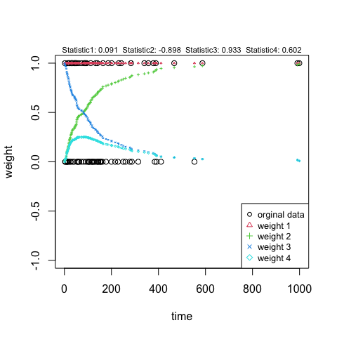

This is a basic example which shows you how to perform maximum weighted logrank test.
Load the lung data and only keep columns for analysis.
lung <- nphPower::lung
tmpd <- with(lung, data.frame(time = SurvTime, stat = 1-censor, grp = Treatment))Generate the weight functions for maxcombo test
Perform the test using pooled Kaplan-Meier estimate of CDF as base function and visualize the weight functions
