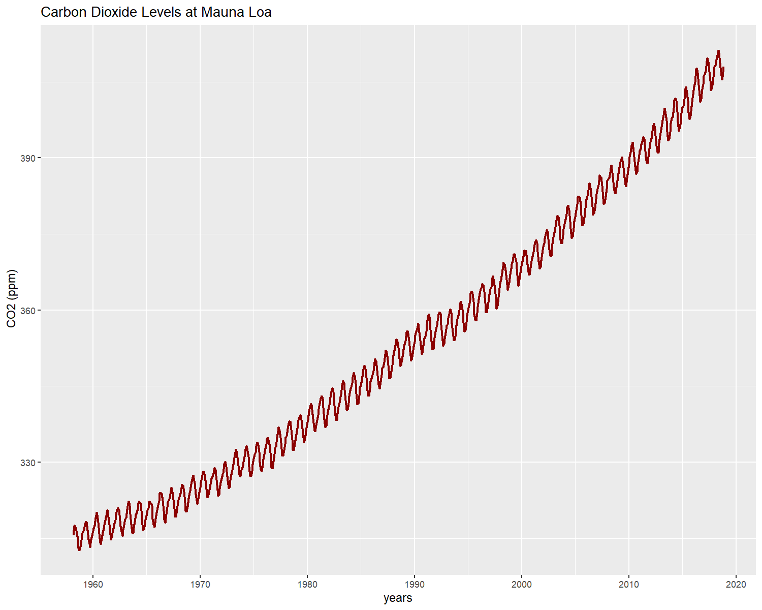

#> alternative hypothesis: w = (y, x) does not follow a Gaussian Processcardox dataAs an example, we analyze the monthly mean carbon dioxide (in ppm) from the astsa package, measured at Mauna Loa Observatory, Hawaii. from March, 1958 to November 2018. The carbon dioxide data measured as the mole fraction in dry air, on Mauna Loa constitute the longest record of direct measurements of CO2 in the atmosphere. They were started by C. David Keeling of the Scripps Institution of Oceanography in March of 1958 at a facility of the National Oceanic and Atmospheric Administration.
library(astsa)
data("cardox")
autoplot(cardox,xlab = "years",ylab = " CO2 (ppm)",color = "darkred",
size = 1,main = "Carbon Dioxide Levels at Mauna Loa")
The time series clearly has trend and seasonal components, for analyzing the cardox data we proposed a Gaussian linear state space model. We use the model’s implementation from the forecast package as follows:

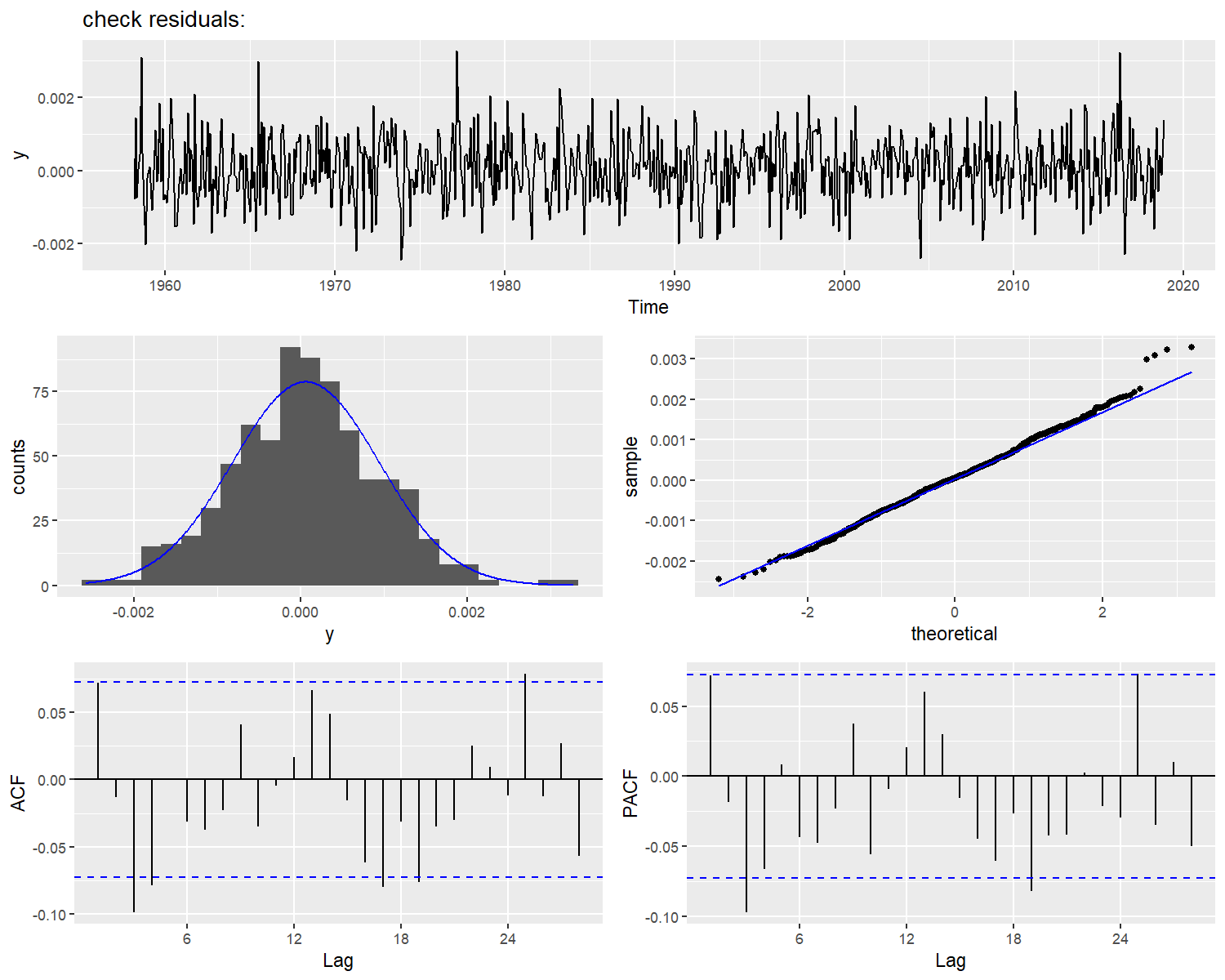

#> Training set 0.07275949The best fitted model is a multiplicative level, additive trend and seasonality state space model. If the model’s assumptions are satisfied, then the model’s errors behave like a Gaussian stationary process. These assumptions can be checked using our check_residuals functions.
In this case, we use an Augmented Dickey-Fuller test for stationary assumption, and a random projections test for normality.
check_residuals(model,unit_root = "adf",normality = "rp",plot = TRUE)
#> Unit root test for stationarity:
#> Augmented Dickey-Fuller Test
#> data: y
#> Dickey-Fuller = -9.7249, Lag order = 8, p-value = 0.01
#> alternative hypothesis: stationary
#> Conclusion: y is stationary
#> Goodness of fit test for Gaussian Distribution:
#> k random projections test
#> data: y
#> k = 2, lobato = 3.8260, epps = 1.3156, p-value = 0.3328
#> alternative hypothesis: y does not follow a Gaussian Process
#> Conclusion: y follows a Gaussian Process

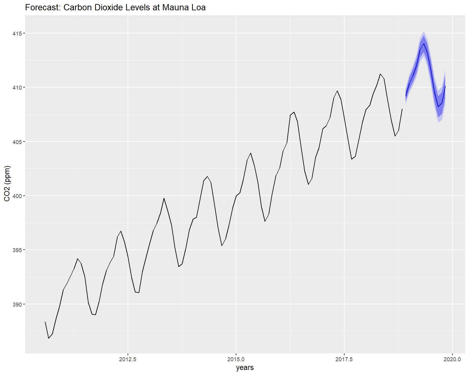

After all the model’s assumptions are checked, the model can be used to forecast.
autoplot(forecast(model,h = 12),include = 100,xlab = "years",ylab = " CO2 (ppm)",
main = "Forecast: Carbon Dioxide Levels at Mauna Loa")
