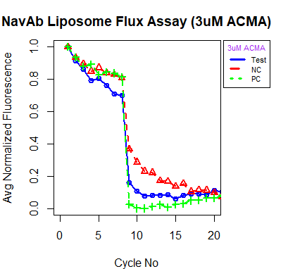

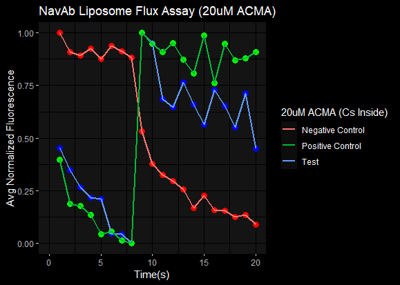

The most common experimental issues arise when ACMA concentrations are out of the tolerated range. Based on my experience, ACMA concentrations between 2 and 5 Micromolar will suffice to get fluorescence values within the tolerance threshold.
ACMA concentrations as low as 0.2 Micromolar or as high as 20 Micromolar have proven problematic based on my research experience. These ACMA concentrations have proven NOISY and provide the basis for determining the noise-signal regions.
Another issue linked to the FLUOstar instrument revolves around setting the right “gain” to ensure the right level of sensitivity in machine readings. A very high “gain” setting results in increased machine sensitivity even at the right ACMA concentrations and vice versa. In short, we want the machine to be primed to read exactly what we feed it, no more, no less.
This program boasts of a quality control function to help new researchers avoid pitfalls that can mar their experience performing experiments.
Within this package, a QC function is designed to check that fluorescence values do not exceed the upper limit (2^15 or 32768) OR fall below the lower limit (2^11 or 2048). Fluorescence values that exceed these thresholds are considered noisy and can lead to incorrect interpretation of analysis results.
The images presented below represent results obtained when experiments are conducted within the noise region. The X-axis is actually “Cycle_No” but seemed to have been mislabeled due to the tedious nature of my previous coding approach.
