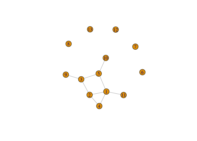

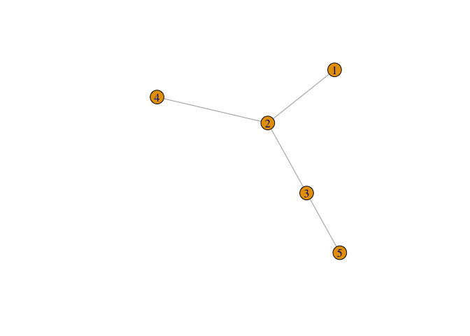

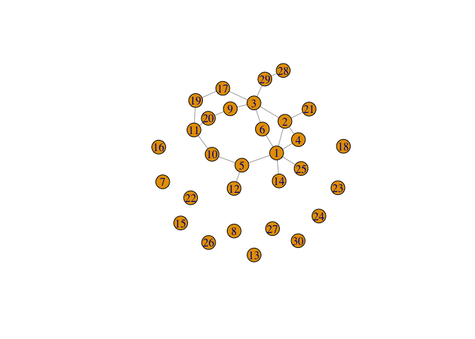

plot(graphlist[[1]])
plot(graphlist[[8]])
plot(graphlist[[15]])

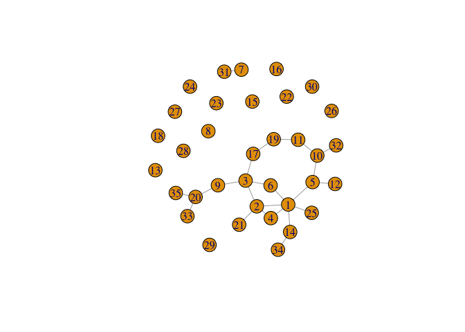

Predicting the next graph
Let’s predict the next graph. The argument \(h = 1\) specifies we want to predict the graph at the next time point.
grpred <- predict_graph(graphlist[1:15],h = 1)
#> Warning: 2 errors (1 unique) encountered for arima
#> [2] missing value where TRUE/FALSE needed
#> Registered S3 method overwritten by 'quantmod':
#> method from
#> as.zoo.data.frame zoo
grpred
#> $graph_mean
#> IGRAPH 4ff4848 U--- 35 23 --
#> + edges from 4ff4848:
#> [1] 17--19 11--19 10--11 9--20 5--12 5--10 3--17 3-- 9 3-- 6 2--21
#> [11] 2-- 4 2-- 3 1--25 1--14 1-- 6 1-- 5 1-- 4 1-- 2 7--31 10--32
#> [21] 20--33 14--34 20--35
#> $graph_lower
#> NULL
#> $graph_upper
#> NULL
plot(grpred$graph_mean)
ecount(grpred$graph_mean)
#> [1] 23
vcount(grpred$graph_mean)

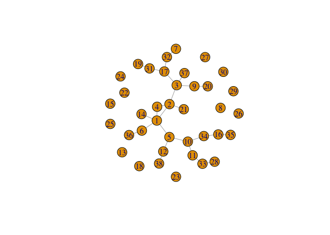

#> [1] 35Now let us predict the graph at 2 time steps ahead with \(h=2\).
grpred2 <- predict_graph(graphlist[1:15], h = 2)
grpred2
#> $graph_mean
#> IGRAPH a99ea21 U--- 38 26 --
#> + edges from a99ea21:
#> [1] 10--11 9--20 5--12 5--10 3--17 3-- 9 2--21 2-- 4 2-- 3 1--14
#> [11] 1-- 6 1-- 5 1-- 4 1-- 2 19--31 17--31 17--32 7--32 11--33 28--33
#> [21] 16--34 10--34 16--35 6--36 3--37 12--38
#> $graph_lower
#> NULL
#> $graph_upper
#> NULL
plot(grpred2$graph_mean)
ecount(grpred2$graph_mean)
#> [1] 26
vcount(grpred2$graph_mean)
#> [1] 38We see the predicted graph at \(h=2\) has more vertices and edges than the graph at \(h=1\).

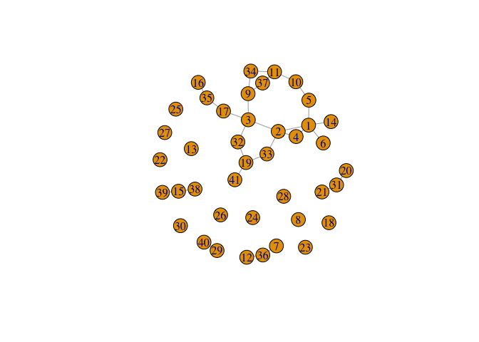

Similarly, we can predict the graph at 3 time steps ahead. We don’t have a limit on \(h\). But generally, as we get further into the future, the predictions are less accurate. This is with everything, not just graphs.
grpred3 <- predict_graph(graphlist[1:15], h = 3)
grpred3
#> $graph_mean
#> IGRAPH dff11cd U--- 41 29 --
#> + edges from dff11cd:
#> [1] 10--11 5--10 3--17 3-- 9 2-- 4 2-- 3 1--14 1-- 6 1-- 5 1-- 4
#> [11] 1-- 2 21--31 20--31 19--32 3--32 19--33 2--33 9--34 11--34 17--35
#> [21] 16--35 12--36 7--36 9--37 11--37 15--38 15--39 29--40 19--41
#> $graph_lower
#> NULL
#> $graph_upper
#> NULL
plot(grpred3$graph_mean)
ecount(grpred3$graph_mean)
#> [1] 29
vcount(grpred3$graph_mean)
#> [1] 41
