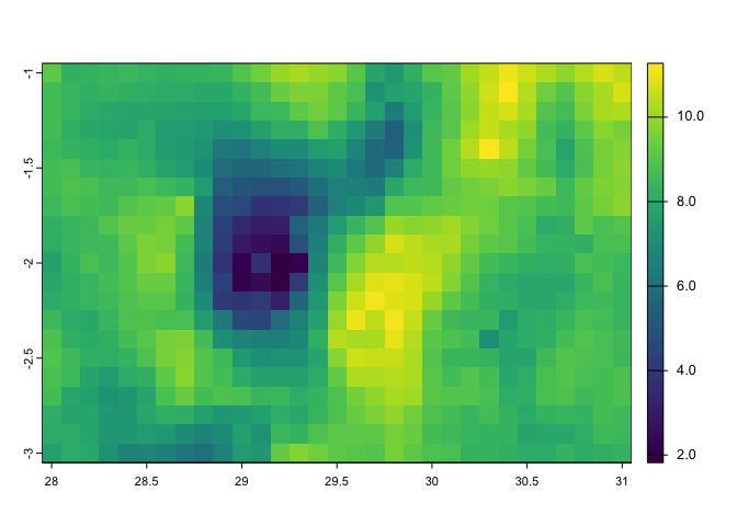

#install.packages("terra")
suppressMessages(library(terra))
(r <- stats[["diurnal_range"]]$terra())
#> class : SpatRaster
#> dimensions : 21, 31, 1 (nrow, ncol, nlyr)
#> resolution : 0.1, 0.1 (x, y)
#> extent : 27.95, 31.05, -3.05, -0.95 (xmin, xmax, ymin, ymax)
#> coord. ref. : lon/lat WGS 84 (EPSG:4326)
#> source(s) : memory
#> name : 2016-01-01T12:00:00
#> min value : 1.819982
#> max value : 11.273690
terra::plot(r)
