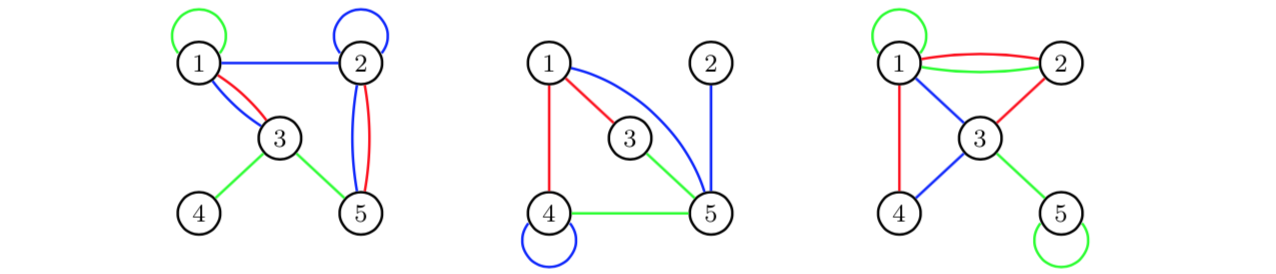

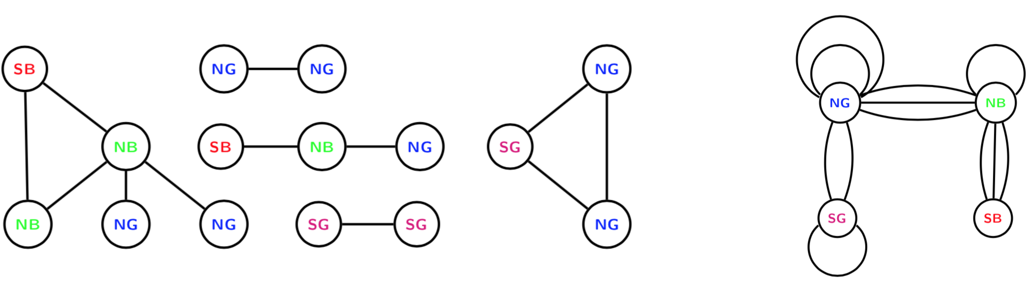

Multigraphs are network representations in which multiple edges and edge loops (self edges) are permitted. These data structures can be either directly observed or aggregated by classifying or cross-classifying node attributes into meta nodes. For the latter case, within group edges correspond to self-edges. See example below where the original graph with 15 nodes and 12 edges (left) is aggregated based on node categories into a small multigraph with 4 nodes (right).

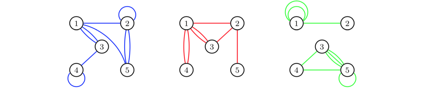

Edge aggregation can also be used to obtain multigraphs. Assume that we study a graph with three different types of relations over three periods of time:
If we aggregate over time periods, we obtain for each edge category a multigraph for the total time period of three days:

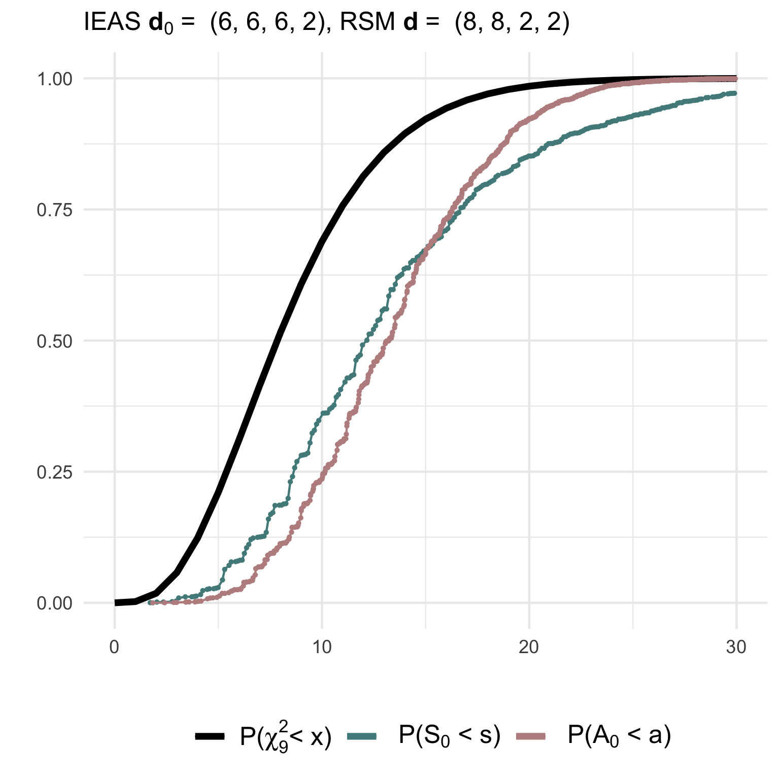

Simulated goodness of fit tests for multigraphs with n=4 nodes and m=10 edges.
(1) Testing a simple IEAS hypothesis with degree sequence (6,6,6,2) against a RSM model with degrees (8,8,2,2):

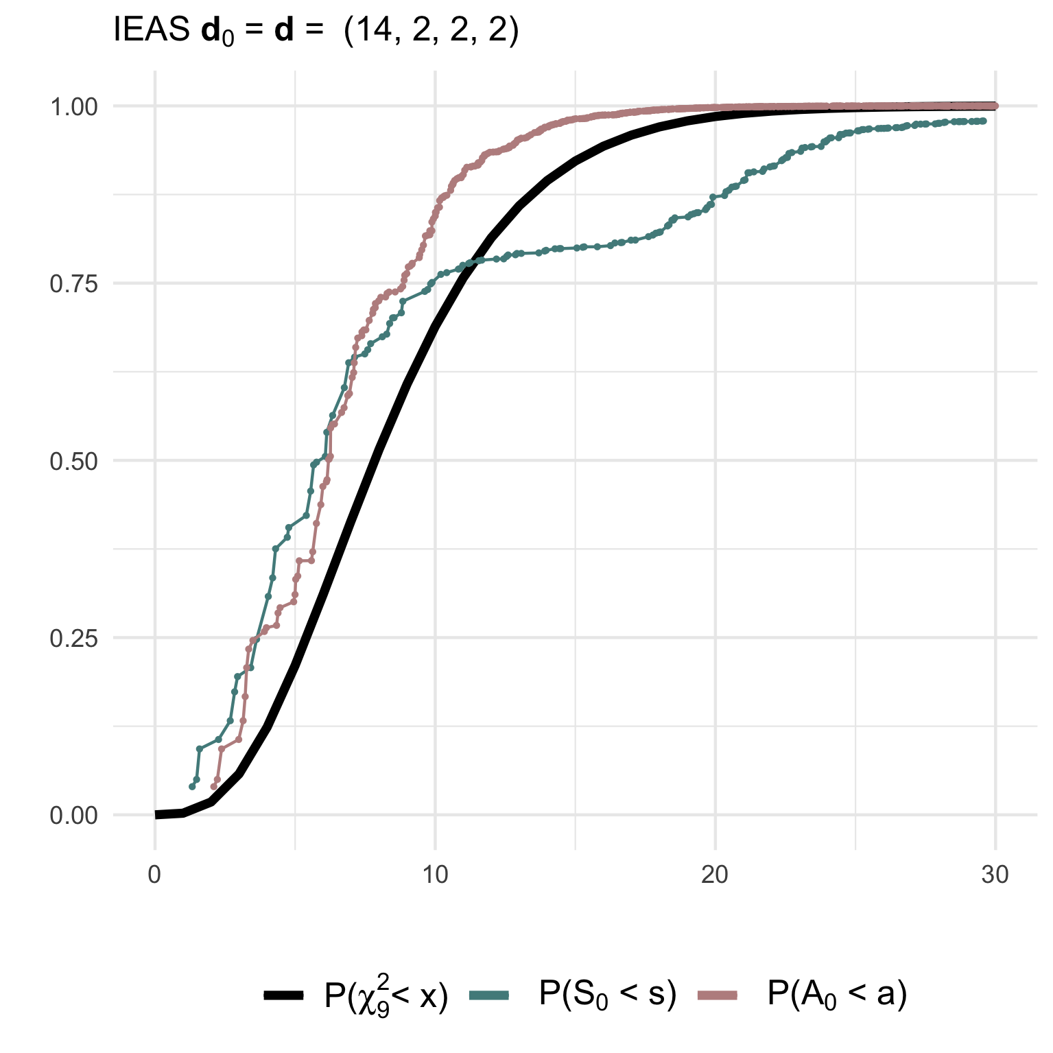

(2) Testing a correctly specified simple IEAS hypothesis with degree sequence (14,2,2,2):
The non-null (gof1) and null (gof2) distributions of the test statistics together with their asymptotic chi2-distribution can be visualised using ggplot2:

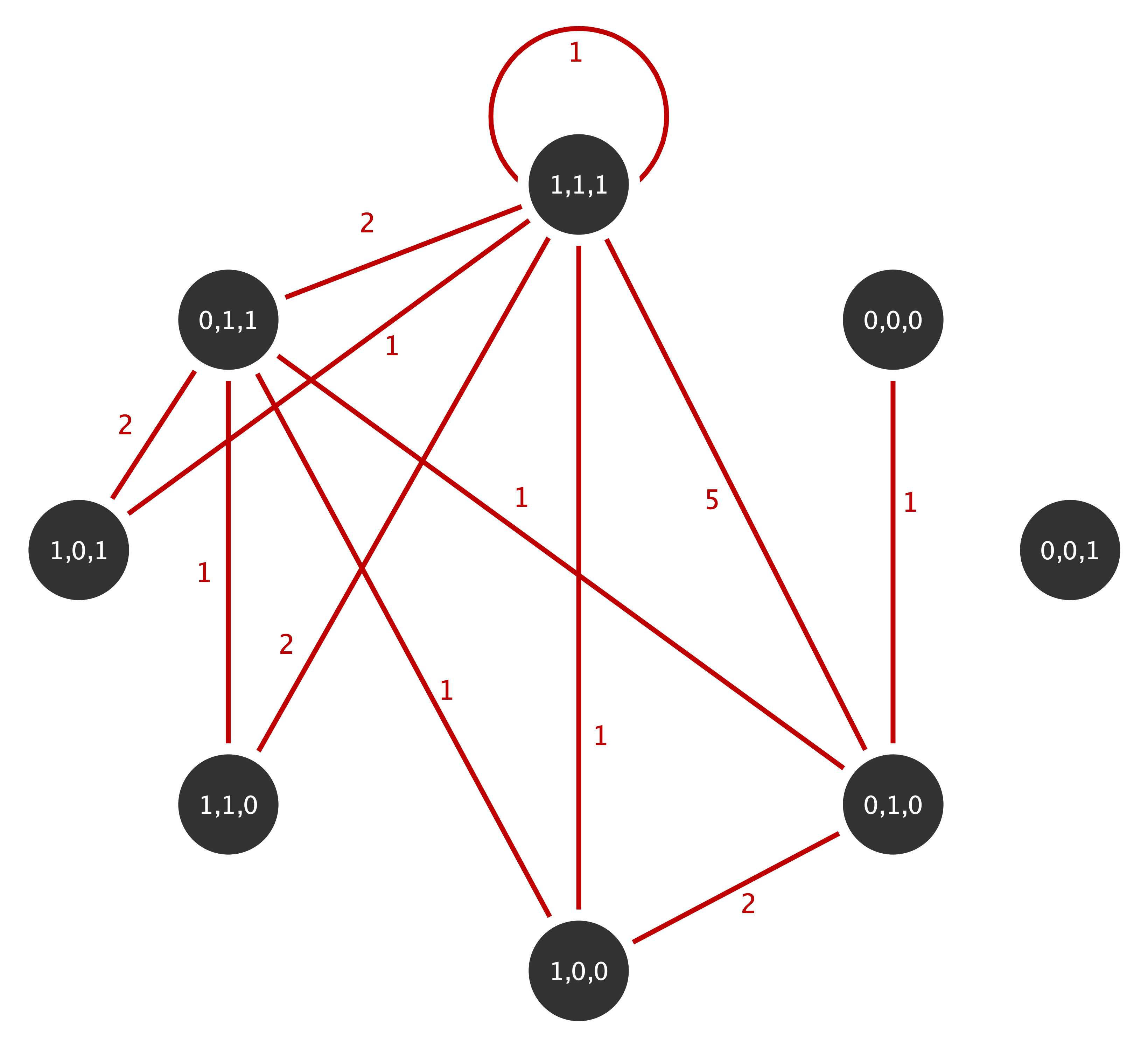

Non-rejection of the null implies that the approximations fit the data, thus implying that above statistics under the IEA models can be used to further analyze the observed network. Consider the following multigraph from the well known Florentine family network with marital. This multigraphs is aggregated based on the three actor attributes wealth (W), number of priorates (P) and total number of ties (T) which are all dichotomised to reflect high or low economic, political and social influence (details on the aggregation can be found in Shafie, 2015):
The multiplicity sequence represented as an upper triangular matrix for this mutigrpah is given by
flor_m <- t(matrix(c (0, 0, 1, 0, 0, 0, 0, 0,
0, 0, 0, 0, 0, 0, 0, 0,
0, 0, 0, 2, 0, 0, 1, 5,
0, 0, 0, 0, 0, 0, 1, 1,
0, 0, 0, 0, 0, 0, 1, 2,
0, 0, 0, 0, 0, 0, 2, 1,
0, 0, 0, 0, 0, 0, 0, 2,
0, 0, 0, 0, 0, 0, 0, 1), nrow= 8, ncol=8))The equivalence of adjacency matrix for the multigraph is given by
flor_adj <- flor_m+t(flor_m)
flor_adj
#> [,1] [,2] [,3] [,4] [,5] [,6] [,7] [,8]
#> [1,] 0 0 1 0 0 0 0 0
#> [2,] 0 0 0 0 0 0 0 0
#> [3,] 1 0 0 2 0 0 1 5
#> [4,] 0 0 2 0 0 0 1 1
#> [5,] 0 0 0 0 0 0 1 2
#> [6,] 0 0 0 0 0 0 2 1
#> [7,] 0 0 1 1 1 2 0 2
#> [8,] 0 0 5 1 2 1 2 2with the diagonal representing the loops double counted (Shafie, 2016). The function get_degree_seq can now be used to find the degree sequence for this multigraph:
Now we test whether the observed network fits the IEAS or the ISA model. The \(p\)-values for testing whether there is a significant difference between observed and expected edge multiplicity values according to the two approximate IEA models are given in the output tables below. Note that the asymptotic χ²-distribution has \(r-1 = (n(n+1)/2) - 1 =35\) degrees of freedom.
flor_ieas_test <- gof_test(flor_adj, 'multigraph', 'IEAS', flor_d, 35)
flor_ieas_test
#> Stat dof Stat(obs) p-value
#> 1 S 35 15.762 0.998
#> 2 A 35 18.905 0.988flor_isa_test <- gof_test(flor_adj, 'multigraph', 'ISA', flor_d, 35)
flor_isa_test
#> 1 S 35 16.572 0.997
#> 2 A 35 19.648 0.983The results show that we have strong evidence for the null such that we fail to reject it. Thus, there is not a significant difference between the observed and the expected edge multiplicity sequence according on the two IEA models. Statistics derived under these models presented above can thus be used to analyze the structure of these multigraphs.
