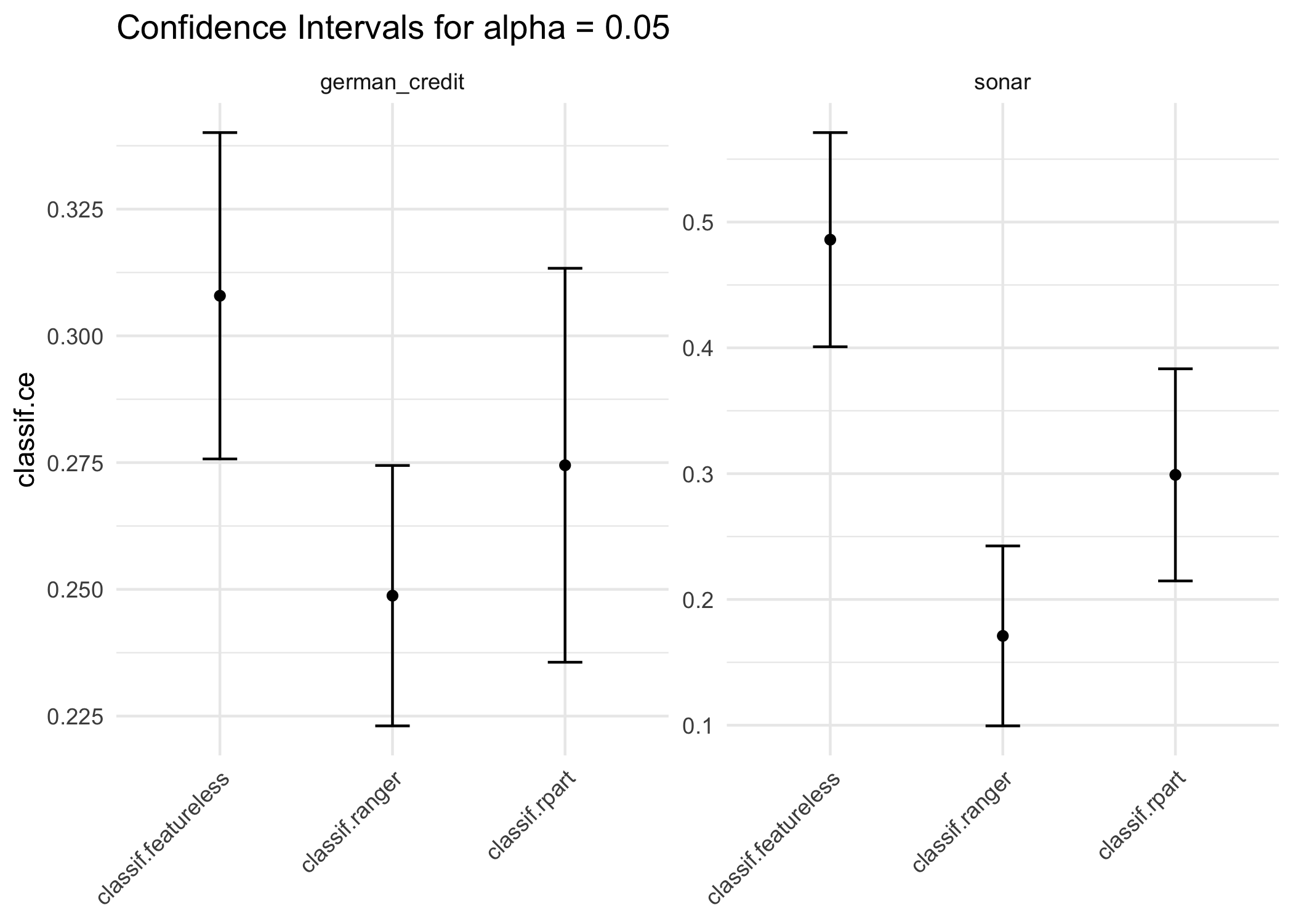

#> 0.7391304 0.6347628 0.8434981With mlr3viz,
it is also possible to visualize multiple confidence intervals. Below,
we compare a random forest with a decision tree and a featureless
learner:
library(mlr3learners)
library(mlr3viz)
bmr = benchmark(benchmark_grid(
tsks(c("sonar", "german_credit")),
lrns(c("classif.rpart", "classif.ranger", "classif.featureless")),
rsmp("subsampling")
autoplot(bmr, "ci", msr("ci", "classif.ce"))
Note that:
