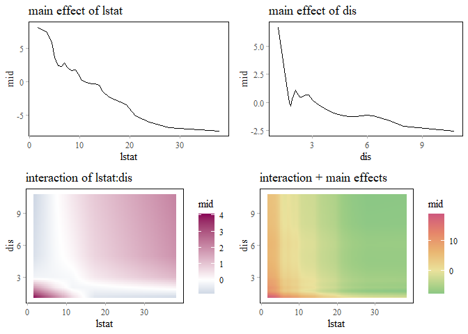

#> RMSE: 3.306111To visualize the main and interaction effects of the variables, apply
ggmid() or plot() to the fitted MID model.
# visualize the main and interaction effects of the MID model
grid.arrange(
ggmid(mid, "lstat") +
ggtitle("main effect of lstat"),
ggmid(mid, "dis") +
ggtitle("main effect of dis"),
ggmid(mid, "lstat:dis") +
ggtitle("interaction of lstat:dis"),
ggmid(mid, "lstat:dis", main.effects = TRUE, theme = "Temps") +
ggtitle("interaction + main effects")

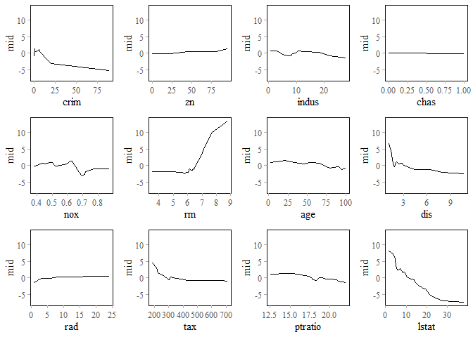

# visualize all main effects
grid.arrange(grobs = mid.plots(mid), nrow = 3)

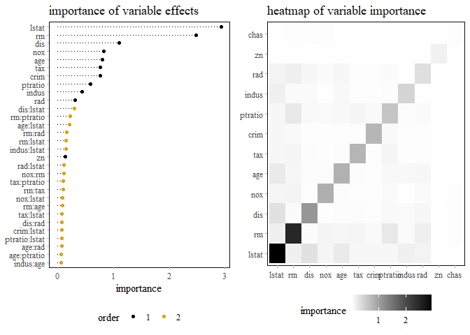

mid.importance() helps to compute and compare the
importance of main and interaction effects.
# visualize the MID importance of the component functions
imp <- mid.importance(mid)
grid.arrange(nrow = 1L,
ggmid(imp, "dotchart", theme = "Okabe-Ito") +
theme(legend.position = "bottom") +
ggtitle("importance of variable effects"),
ggmid(imp, "heatmap") +
ggtitle("heatmap of variable importance")

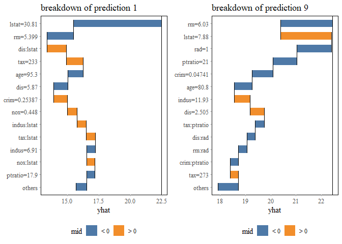

mid.breakdown() provides a way to analyze individual
predictions by decomposing the differences between the intercept and the
predicted value into variable effects.
# visualize the MID breakdown of the model predictions
bd1 <- mid.breakdown(mid, data = train[1L, ])
bd9 <- mid.breakdown(mid, data = train[9L, ])
ggmid(bd1, "waterfall", theme = "Tableau 10", max.bars = 14L) +
ggtitle("breakdown of prediction 1"),
ggmid(bd9, "waterfall", theme = "Tableau 10", max.bars = 14L) +
ggtitle("breakdown of prediction 9")

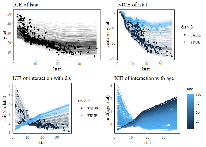

mid.conditional() can be used to compute the ICE curves
(Goldstein et al. 2015) of the fitted MID model, as well as the
breakdown of the ICE curves by main and interaction effects.
# visualize the ICE curves of the MID model
ice <- mid.conditional(mid, "lstat")
grid.arrange(
ggmid(ice, alpha = .1) +
ggtitle("ICE of lstat"),
ggmid(ice, "centered", alpha = .1, var.color = dis > 3) +
ggtitle("c-ICE of lstat"),
ggmid(ice, term = "lstat:dis", var.color = dis > 3, alpha = .1) +
ggtitle("ICE of interaction with dis"),
ggmid(ice, term = "lstat:age", var.color = age, dots = FALSE) +
ggtitle("ICE of interaction with age")
