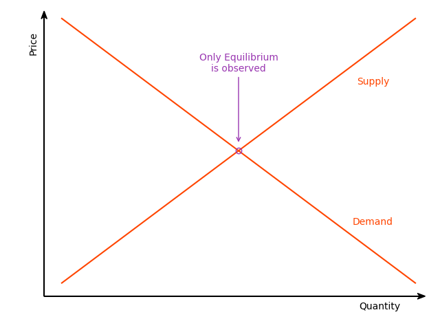

The equilibrium model adds the market-clearing condition to the demand and supply equations of the system. For the system to be identifiable, at least one variable on the demand side must not be present on the supply side and vice versa. This model assumes that the market observations always represent equilibrium points in which the demanded and supplied quantities are equal. The model can be estimated using two-stage least squares (Theil 1953) or full information maximum likelihood (Karapanagiotis, n.d.). Asymptotically, these methods are equivalent (Balestra and Varadharajan-Krishnakumar 1987).

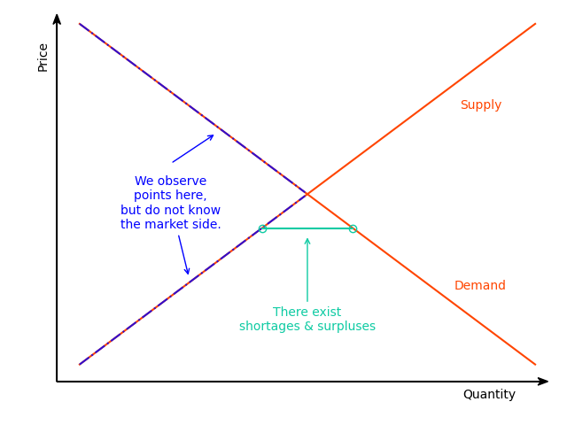

The basic model is the simplest disequilibrium model of the package as it basically imposes no assumption on the market structure regarding price movements (Fair and Jaffee 1972; Maddala and Nelson 1974). In contrast with the equilibrium model, the market-clearing condition is replaced by the short-side rule, which stipulates that the minimum between the demanded and supplied quantities is observed. The econometrician does not need to specify whether an observation belongs to the demand or the supply side since the estimation of the model will allocate the observations on the demand or supply side so that the likelihood is maximized.

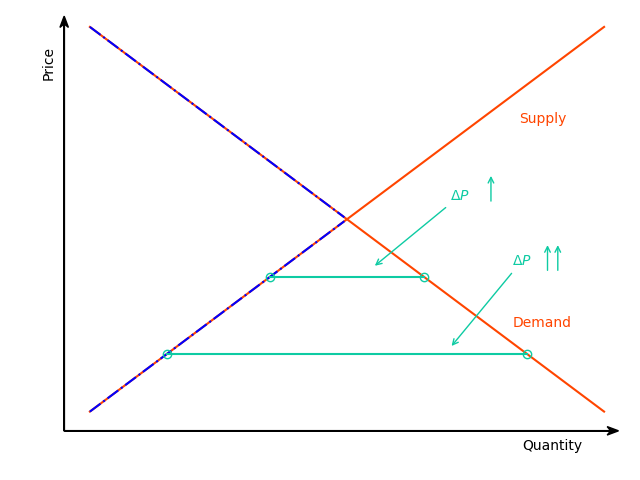

The separation rule of the directional model classifies observations on the demand- or supply-side based in a binary fashion, which is not always flexible, as observations that correspond to large shortages/surpluses are treated the same as observations that correspond to small shortages/ surpluses. The deterministic adjustment model of the package replaces this binary separation rule with a quantitative one (Fair and Jaffee 1972; Maddala and Nelson 1974). The magnitude of the price movements is analogous to the magnitude of deviations from the market-clearing condition. This model offers a flexible estimation alternative, with one extra degree of freedom in the estimation of price dynamics, that accounts for market forces that are in alignment with standard economic reasoning. By letting approach zero, the equilibrium model can be obtained as a limiting case of this model.

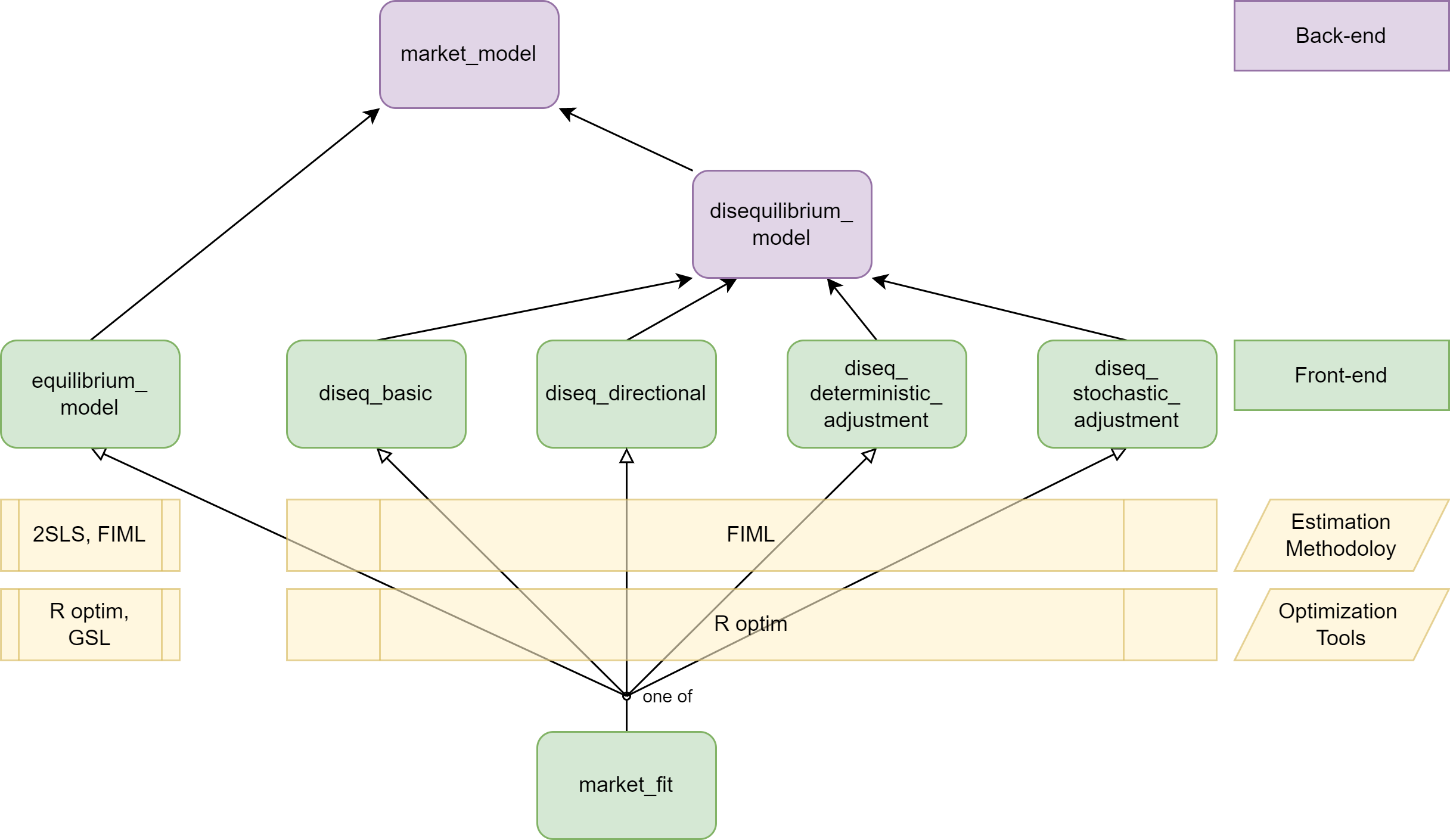

The equilibrium model can be estimated either using two-stage least squares or full information maximum likelihood. The two methods are asymptotically equivalent. The class for which both of these estimation methods are implemented is
equilibrium_model.In total, there are four disequilibrium models, which are all estimated using full information maximum likelihood. By default, the estimations use analytically calculated gradient expressions, but the user can override this behavior. The classes that implement the four disequilibrium models are
diseq_basic,diseq_directional,diseq_deterministic_adjustment, anddiseq_stochastic_adjustment.The package organizes these classes in a simple object-oriented hierarchy.
