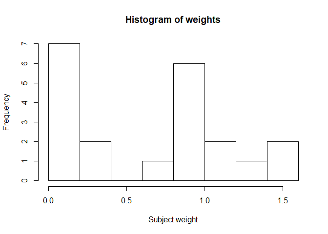

ipmat <- createMAICInput(
index = stackloss,
target = target,
dictionary = dict,
matching.variables =
c("airflow", "watertemp",
"acidconc", "min.airflow"))
wts <- maicWeight(ipmat)plot(wts)
