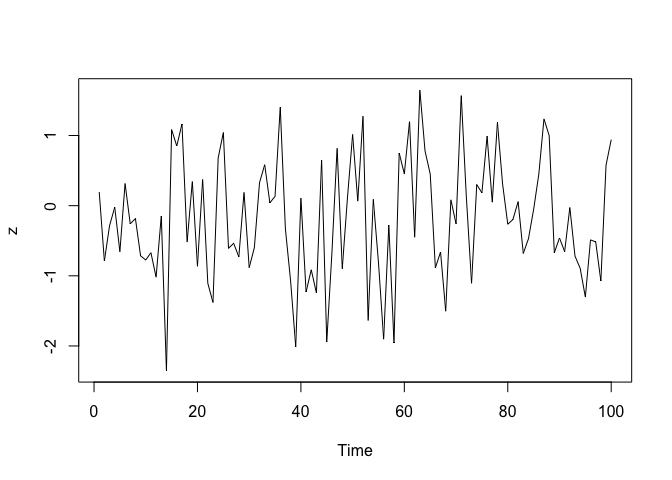

data.frame(z = rnorm(100)) %$%
ts.plot(z)
