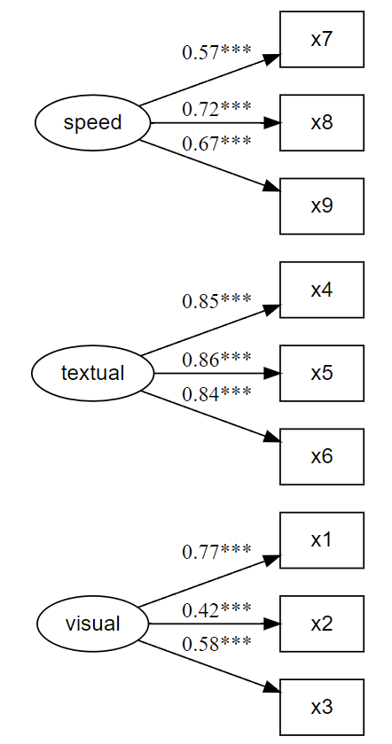

# Fit the model fit and plot with `lavaanExtra::cfa_fit_plot`
# to get the factor loadings visually (optionally as PDF)
fit.cfa <- cfa_fit_plot(cfa.model, HolzingerSwineford1939)

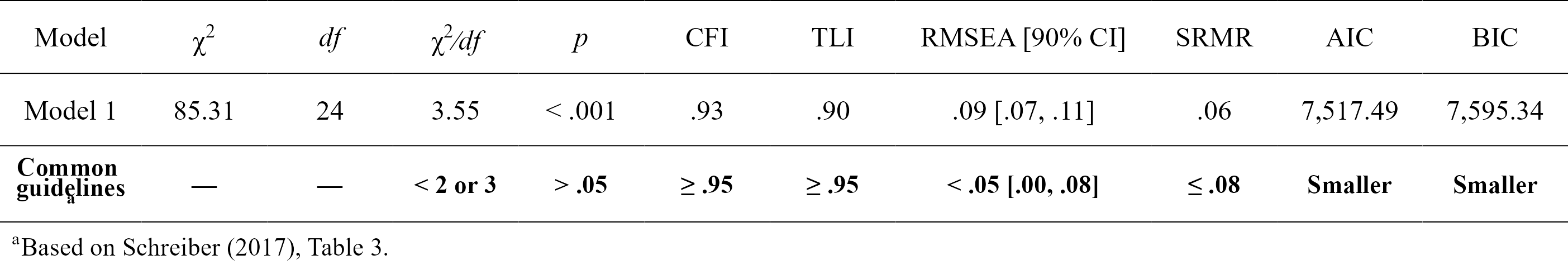

# Get nice fit indices with the `rempsyc::nice_table` integration
nice_fit(fit.cfa, nice_table = TRUE)

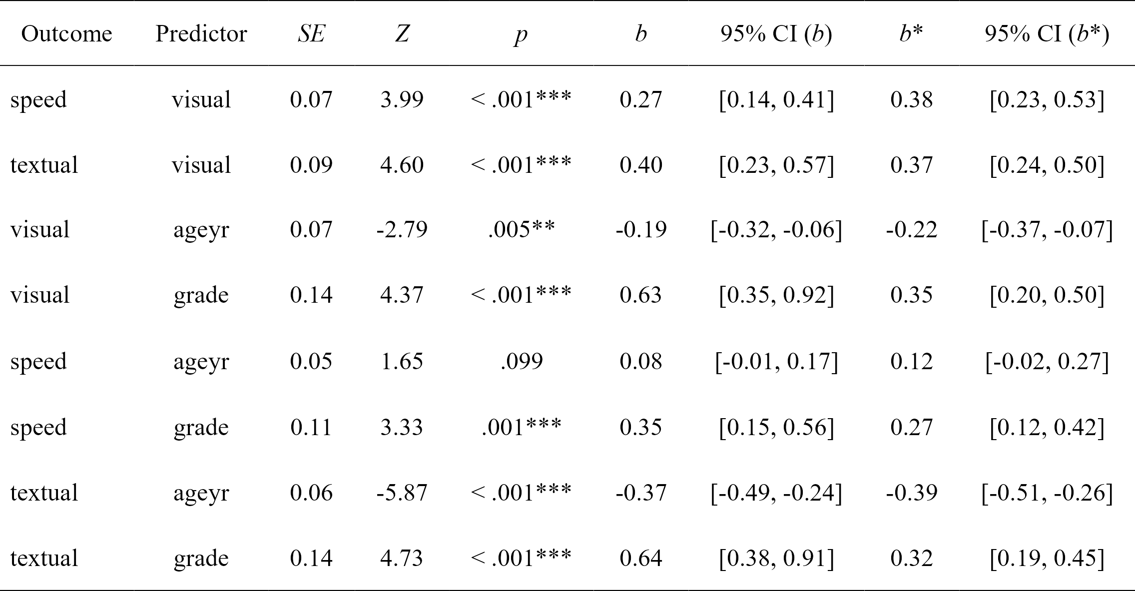

fit.sem <- sem(model, data = HolzingerSwineford1939)# Get regression parameters and make pretty with `rempsyc::nice_table`
lavaan_reg(fit.sem, nice_table = TRUE, highlight = TRUE)

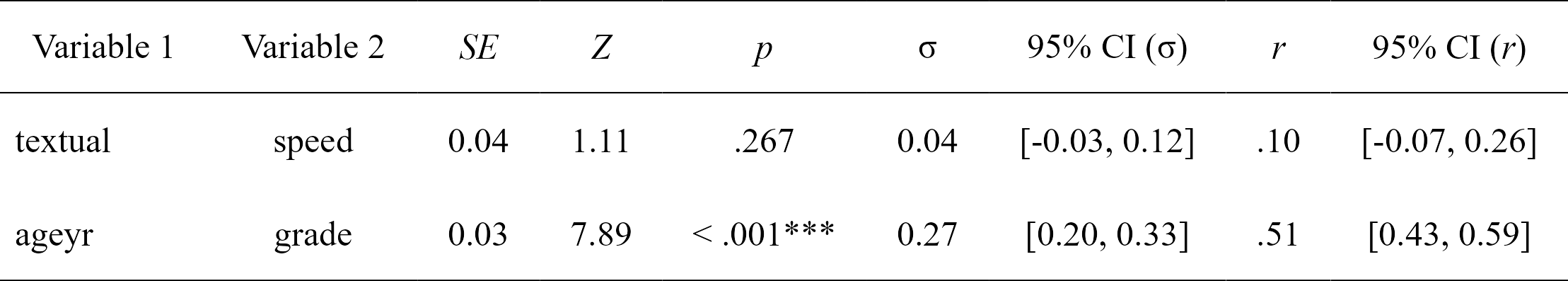

# Get covariances/correlations and make them pretty with
# the `rempsyc::nice_table` integration
lavaan_cor(fit.sem, nice_table = TRUE)

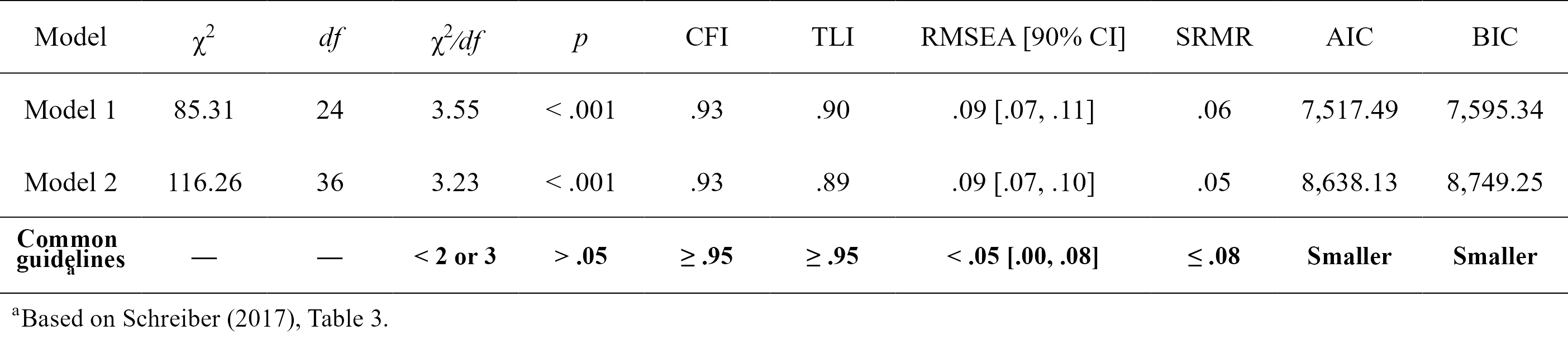

fit_table <- nice_fit(list(fit.cfa, fit.sem), nice_table = TRUE)
fit_table
# Save fit table to Word!
flextable::save_as_docx(fit_table, path = "fit_table.docx")

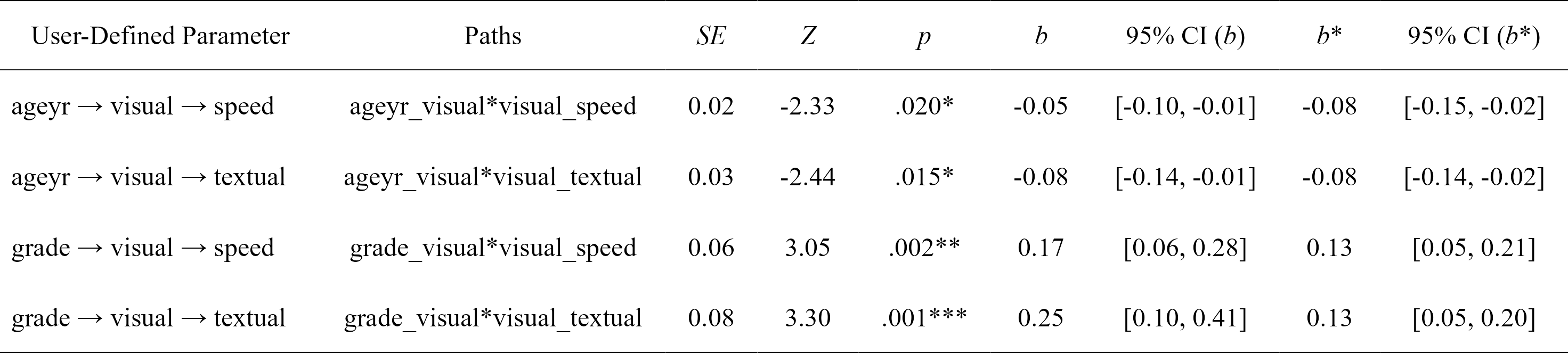

# Let's get the user-defined (e.g., indirect) effects only and make it pretty
# with the `rempsyc::nice_table` integration
lavaan_defined(fit.sem, nice_table = TRUE)

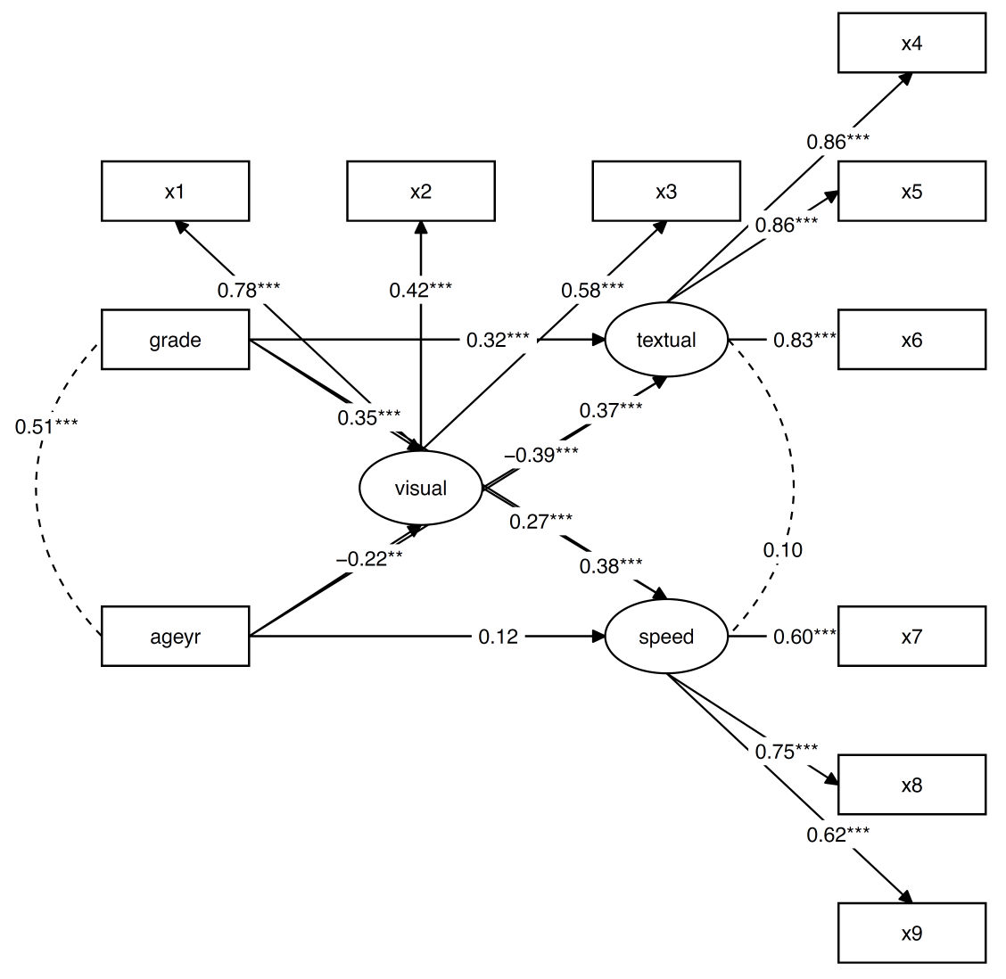

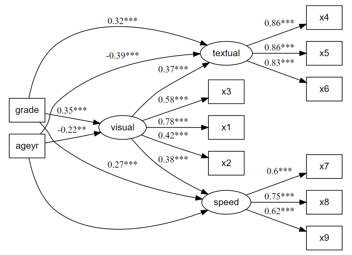

# Plot our model
nice_lavaanPlot(fit.sem)
# Alternative way to plot
mylayout <- data.frame(
IV = c("", "x1", "grade", "", "ageyr", "", ""),
M = c("", "x2", "", "visual", "", "", ""),
DV = c("", "x3", "textual", "", "speed", "", ""),
DV.items = c(paste0("x", 4:6), "", paste0("x", 7:9))
as.matrix()
mylayout
#> IV M DV DV.items
#> [1,] "" "" "" "x4"
#> [2,] "x1" "x2" "x3" "x5"
#> [3,] "grade" "" "textual" "x6"
#> [4,] "" "visual" "" ""
#> [5,] "ageyr" "" "speed" "x7"
#> [6,] "" "" "" "x8"
#> [7,] "" "" "" "x9"nice_tidySEM(fit.sem, layout = mylayout, label_location = 0.7)
ggplot2::ggsave("my_semPlot.pdf", width = 6, height = 6, limitsize = FALSE)
