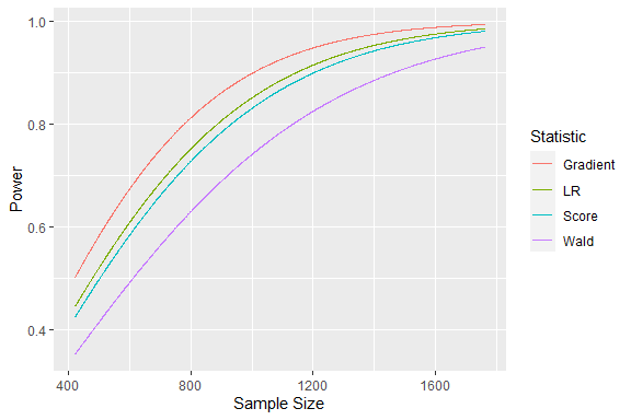

#> Method: AnalyticalHere we see that the gradient statistic would be the most efficient to test our hypothesis: We would need a sample size of 778 to reach our desired power.
We can also plot the power curves to get a more detailed look on the relationships between sample size and power:
