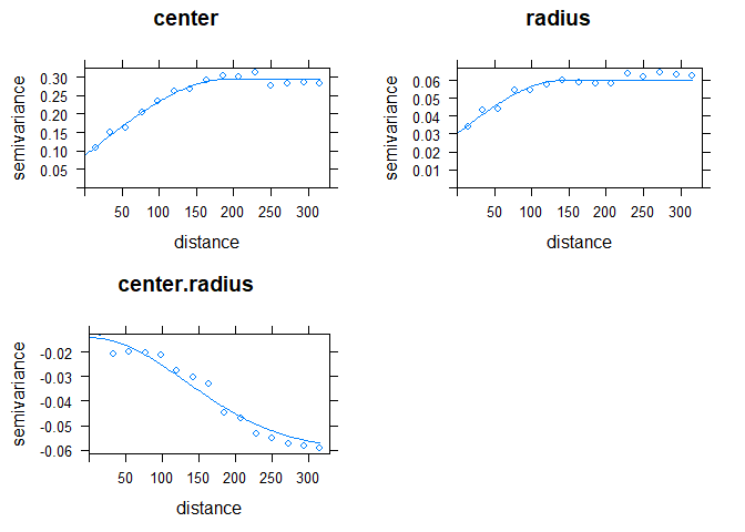

interval(utsnow.sp) <- log(interval(utsnow.sp))Next, we demonstrate how to create and fit empirical variograms. The functions that accomplish this task are fairly shallow wrappers to the functions in the gstat package. These function in the intkrige package simplify the workflow by fitting the center, radius, and center/radius variograms using the information contained in the interval slot. The intvariogram function defines the empirical variograms, while the fit.intvariogram function automatically fits variograms to the output of intvariogram. Note that intvariogram defines an intvariogram class which is the only class that fit.intvariogram will accept. This new class designation is intended to ensure that intvariogram and fit.intvariogram are always used in tandem. These particular variograms first account for the effect of elevation on ground snow loads before calculating the empirical variograms.
# Define the formulas we will use to define the intervals.
temp_formulas <- list(center ~ ELEVATION,
radius*(ELEVATION/median(ELEVATION)) ~ 1)
# Define, fit and check the variogram fits.
varios <- intvariogram(utsnow.sp,
formulas = temp_formulas)
varioFit <- fit.intvariogram(varios, models = gstat::vgm(c("Sph", "Sph", "Gau")))
intvCheck(varios, varioFit)
