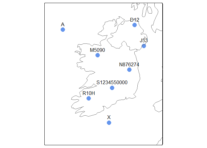

# Converting to an sf object of POINT features
st_igr_as_sf(igrs_df, "igr")
#> Simple feature collection with 8 features and 1 field
#> Geometry type: POINT
#> Dimension: XY
#> Bounding box: xmin: 0 ymin: 0 xmax: 350000 ymax: 420000
#> Projected CRS: TM75 / Irish Grid
#> igr geometry
#> 1 A POINT (0 4e+05)
#> 2 D12 POINT (310000 420000)
#> 3 J53 POINT (350000 330000)
#> 4 M5090 POINT (150000 290000)
#> 5 N876274 POINT (287600 227400)
#> 6 S1234550000 POINT (212345 150000)
#> 7 R10H POINT (112000 104000)
#> 8 X POINT (2e+05 0)

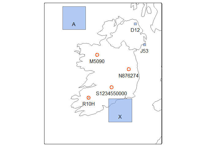

# Converting to an sf object of POLYGON features
st_igr_as_sf(igrs_df, "igr", polygon = TRUE)
#> Geometry type: POLYGON
#> Dimension: XY
#> Bounding box: xmin: 0 ymin: 0 xmax: 360000 ymax: 5e+05
#> igr geometry
#> 1 A POLYGON ((1e+05 5e+05, 1e+0...
#> 2 D12 POLYGON ((320000 430000, 32...
#> 3 J53 POLYGON ((360000 340000, 36...
#> 4 M5090 POLYGON ((151000 291000, 15...
#> 5 N876274 POLYGON ((287700 227500, 28...
#> 6 S1234550000 POLYGON ((212346 150001, 21...
#> 7 R10H POLYGON ((114000 106000, 11...
#> 8 X POLYGON ((3e+05 1e+05, 3e+0...
