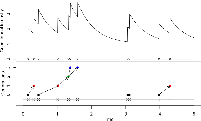

Hawkes processes can be simulated by the function hawkes:
where end denotes the end of the interval . This function uses the cluster representation:
First, the immigrants are drawn according to a (potentially inhomogeneous) Poisson process with intensity measure fun.
Second, the number of offsprings of an immigrant are drawn from a Poisson distribution with intensity repr.
Third, these offsprings are distributed according to the family distribution.
Then, further offsprings are generated according to the last two steps.
The argument fun can take a numeric value or be specified as a function, in which case the argument M must be specified as an upper bound on fun (to allow simulation of the immigration process by thinning). The argument family can either be specified as a string name corresponding to a distribution with random generation function rname (for example exp for rexp), or directly as a random generation function. The optional arguments ... are passed to the random generation function specified by family.
This returns a list of class hawkes, whose realisations are stored in the member p. Other members of the list are mainly used for support functions.
x <- hawkes(10, fun=function(y) {1+sin(y)}, M=2, repr=0.25,
family=function(n) {1 - sqrt(1 - runif(n))})plot.hawkes:plot.hawkes(x, intensity = FALSE, precision = 1e3, fun = NULL, repr = NULL, family = NULL,
M = NULL, ...)If x is of class hawkes, as for objects returned by the function hawkes, arguments fun through M can be ignored. If intensity is set to FALSE, this plots the genealogy of the simulated Hawkes process (as in preceding figure, bottom panel). If it is set to TRUE, this plots the conditional intensity of the process (as in preceding figure, top panel).
