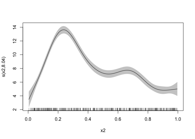

## show partial residuals
plot(mgcv_fit, scheme = 1, shift = coef(mgcv_fit)[1])

#> 5 5.057305Now let’s compare the mgcv model fit to the
greta.gam fit:
# add in a line for each posterior sample
apply(draws[[1]], 1, lines, x = pred_dat$x2,
col = adjustcolor("firebrick", alpha.f = 0.1))
#> NULL
# plot the data
points(dat$x2, dat$y, pch = 19, cex = 0.2)
The mgcv predictions are in the grey ribbon, and the
greta.gam ones are in red - we can see that the greta
predictions are within the range of the mgcv, which is good news!
