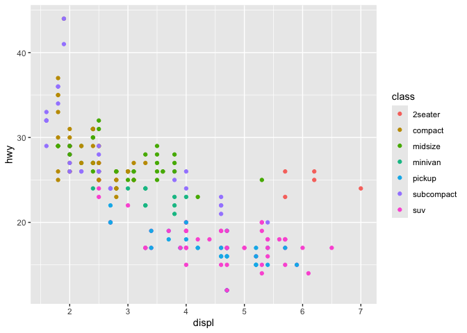

library(ggplot2)
ggplot(mpg, aes(displ, hwy, colour = class)) +
geom_point()
