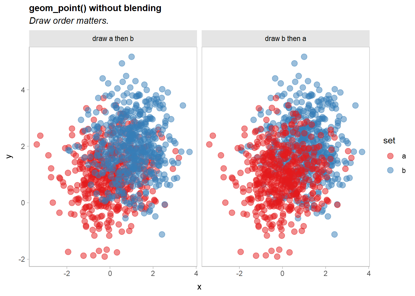

df = rbind(df_ab, df_ba)A typical scatterplot of such data suffers from the problem that how many points appear to be in each group depends on the drawing order (a then b versus b then a):
df |>
ggplot(aes(x, y, color = set)) +
geom_point(size = 3, alpha = 0.5) +
scale_color_brewer(palette = "Set1") +
facet_grid(~ order) +
labs(title = "geom_point() without blending", subtitle = "Draw order matters.")

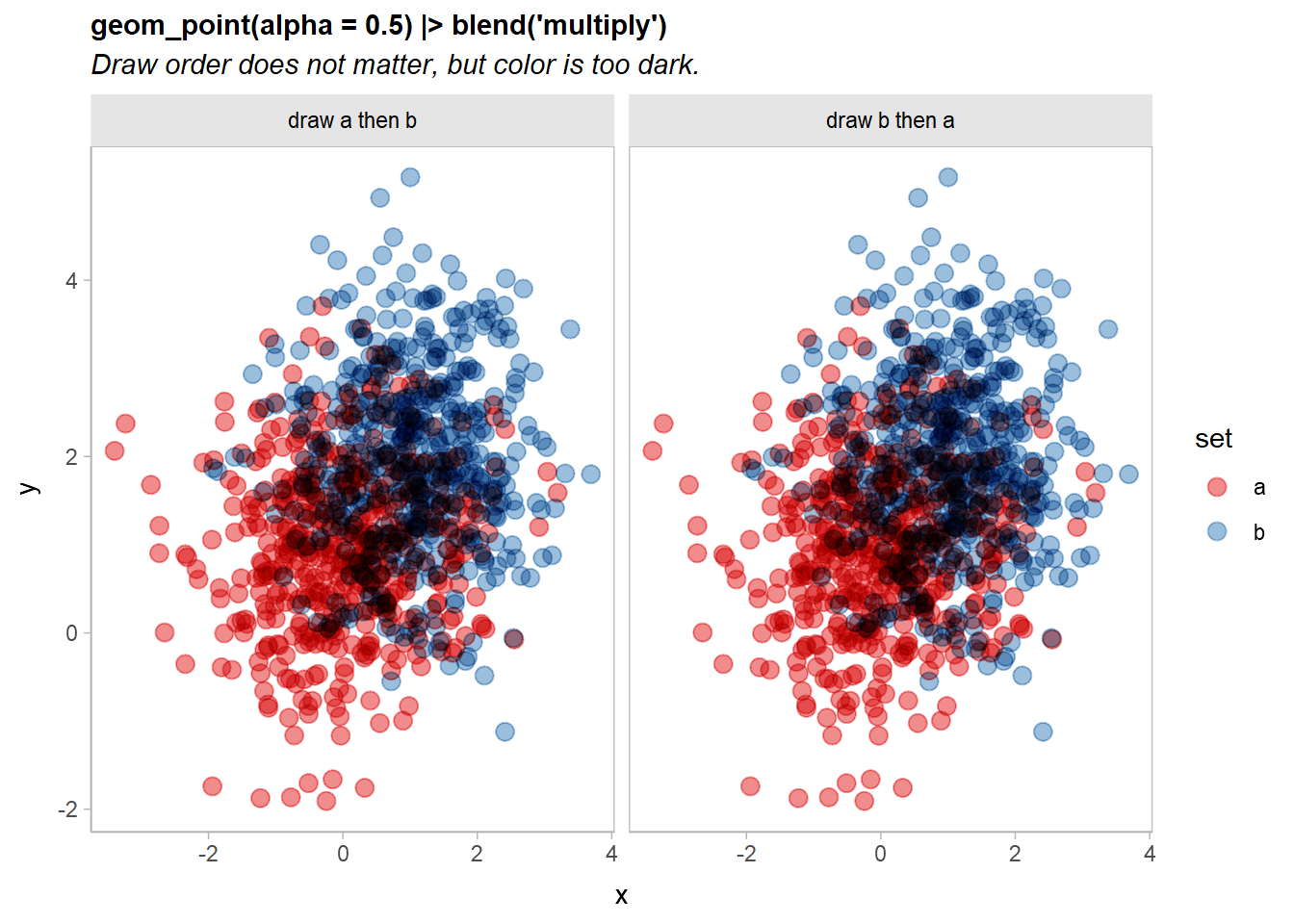

df |>
geom_point(size = 3, alpha = 0.5) |> blend("multiply") +
labs(
title = "geom_point(alpha = 0.5) |> blend('multiply')",
subtitle = "Draw order does not matter, but color is too dark."
Now the output is identical no matter the draw order, although the output is quite dark.

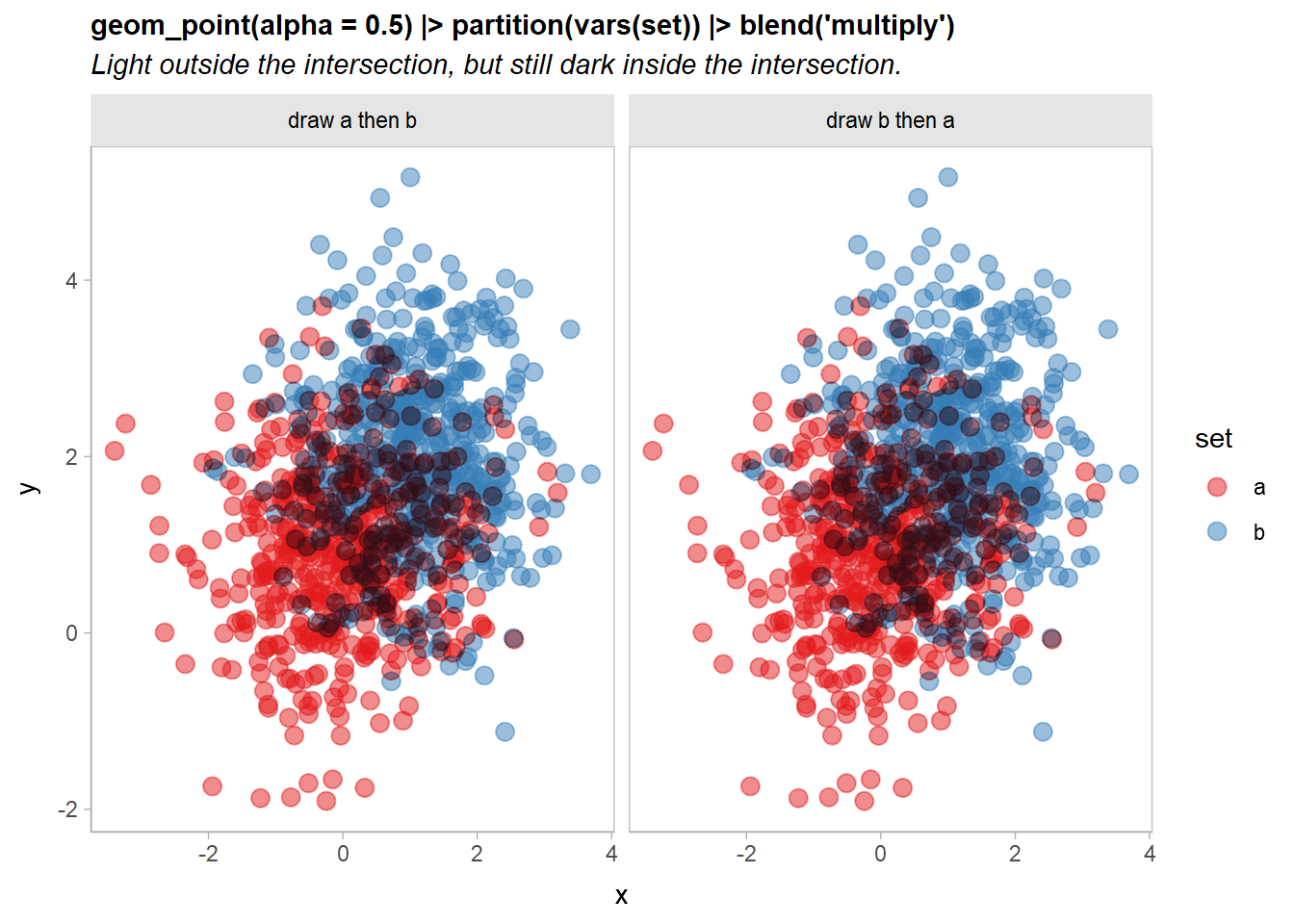

Part of the reason the output is very dark above is that all of the points are being multiply-blended together. When many objects (here, individual points) are multiply-blended on top of each other, the output tends to get dark very quickly.
However, we really only need the two sets to be multiply-blended with
each other. Within each set, we can use regular alpha blending. To do
that, we can partition the geometry by set and then blend.
Each partition will be blended normally within the set, and then the
resulting sets will be multiply-blended together just once:
df |>
geom_point(size = 3, alpha = 0.5) |> partition(vars(set)) |> blend("multiply") +
labs(
title = "geom_point(alpha = 0.5) |> partition(vars(set)) |> blend('multiply')",
subtitle = "Light outside the intersection, but still dark inside the intersection."
That’s getting there: points outside the intersection of the two sets look good, but the intersection is still a bit dark.

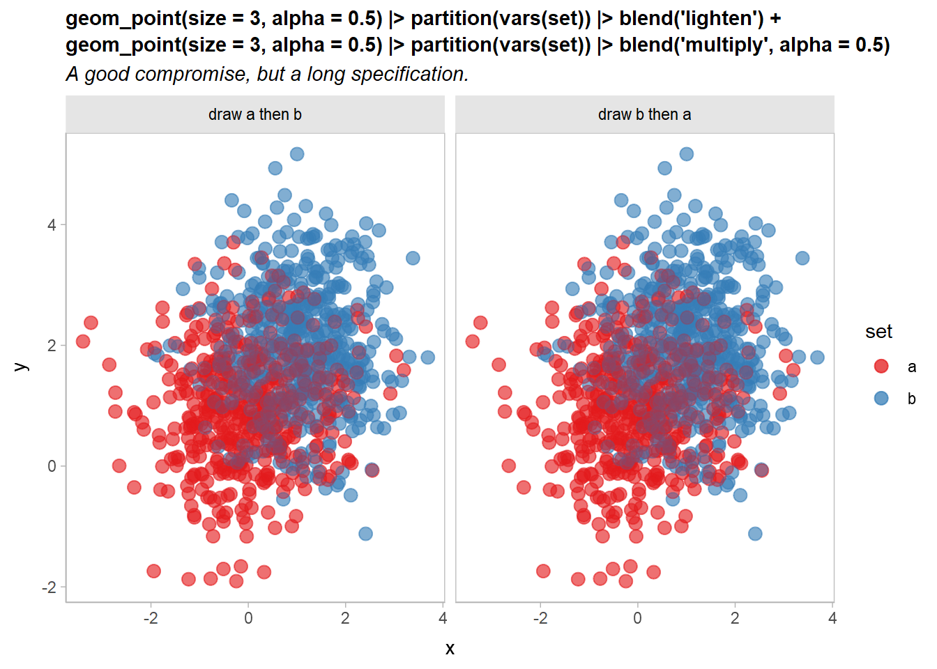

Let’s try combining two blend modes to address this: we’ll use a
"lighten" blend mode (which is also commutative) to make
the overlapping regions lighter, and then draw the
"multiply"-blended version on top at an alpha
of less than 1:
df |>
geom_point(size = 3, alpha = 0.5) |> partition(vars(set)) |> blend("lighten") +
geom_point(size = 3, alpha = 0.5) |> partition(vars(set)) |> blend("multiply", alpha = 0.5) +
labs(
title =
"geom_point(size = 3, alpha = 0.5) |> partition(vars(set)) |> blend('lighten') + \ngeom_point(size = 3, alpha = 0.5) |> partition(vars(set)) |> blend('multiply', alpha = 0.5)",
subtitle = 'A good compromise, but a long specification.'
theme(plot.subtitle = element_text(lineheight = 1.2))
Now it’s a little easier to see both overlap and density, and the output remains independent of draw order.
However, it is a little verbose to need to copy out a layer multiple times:
geom_point(size = 3, alpha = 0.5) |> partition(vars(set)) * blend("lighten") +
geom_point(size = 3, alpha = 0.5) |> partition(vars(set)) * blend("multiply", alpha = 0.5) +We can simplify this is two ways: first,

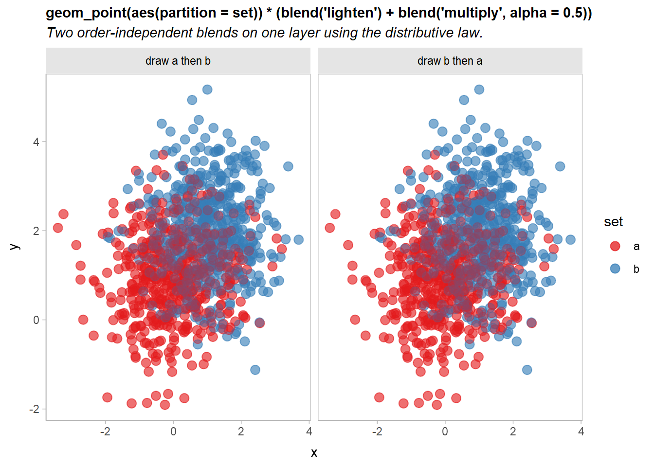

Thus, we can “factor out”
geom_point(size = 3, alpha = 0.5) from the above
expression, yielding this:
geom_point(size = 3, alpha = 0.5) * (blend("lighten") + blend("multiply", alpha = 0.5))Both expressions are equivalent. Thus we can rewrite the previous example like so:
df |>
ggplot(aes(x, y, color = set, partition = set)) +
geom_point(size = 3, alpha = 0.5) * (blend("lighten") + blend("multiply", alpha = 0.5)) +
labs(
title = "geom_point(aes(partition = set)) * (blend('lighten') + blend('multiply', alpha = 0.5))",
subtitle = "Two order-independent blends on one layer using the distributive law."

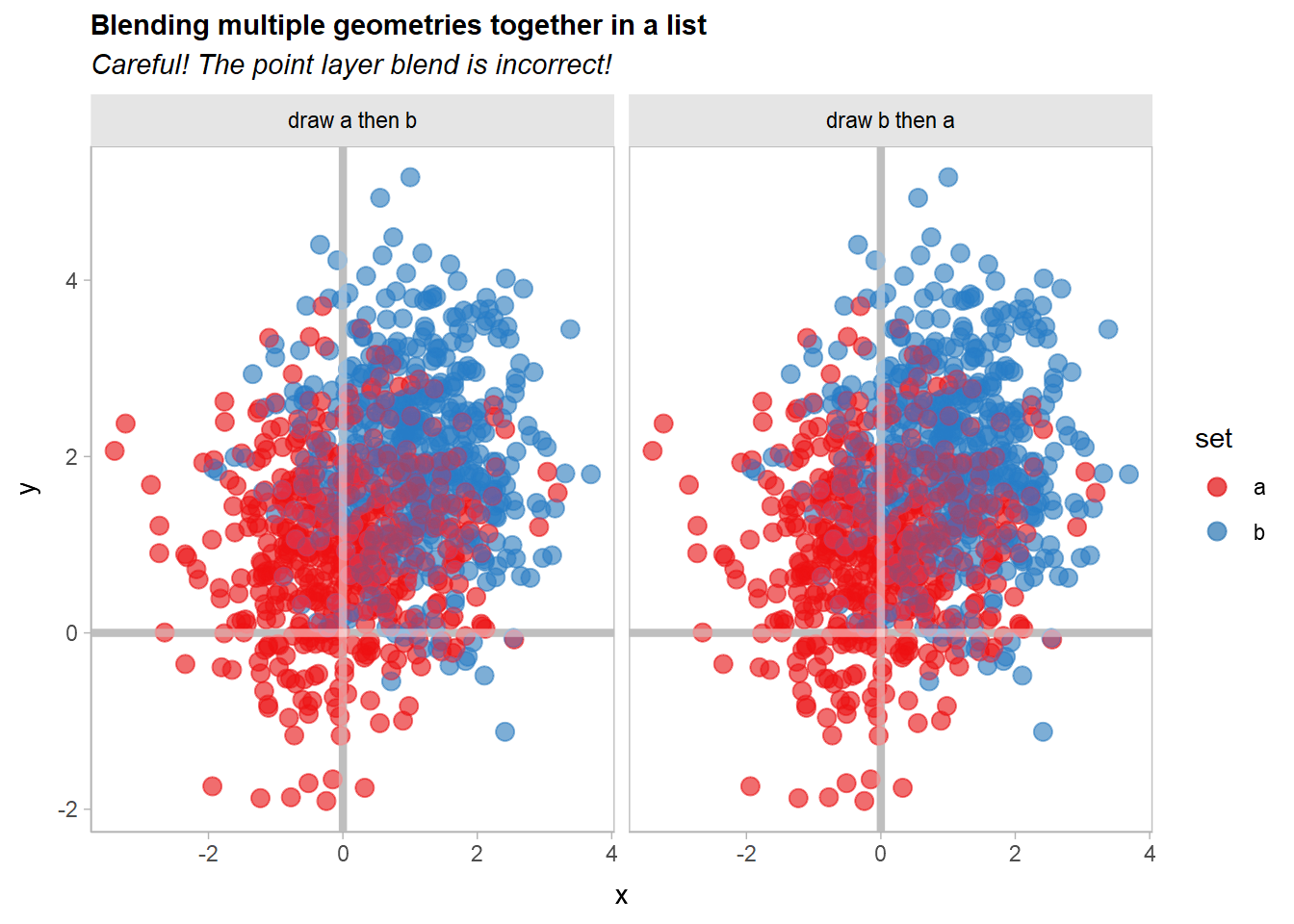

We can also blend geometries together by passing a list of geometries
to blend(). These lists can include already-blended
geometries:
df |>
list(
geom_point(size = 3, alpha = 0.5) * (blend("lighten") + blend("multiply", alpha = 0.5)),
geom_vline(xintercept = 0, color = "gray75", linewidth = 1.5),
geom_hline(yintercept = 0, color = "gray75", linewidth = 1.5)
) |> blend("hard.light") +
labs(
title = "Blending multiple geometries together in a list",
subtitle = "Careful! The point layer blend is incorrect!"
Whoops!! If you look closely, the blending of the
geom_point() layers appears to have changed. Recall that
this expression:
geom_point(size = 3, alpha = 0.5) * (blend("lighten") + blend("multiply", alpha = 0.5))Is equivalent to specifying two separate layers, one with
blend("lighten") and the other with
blend("multiply", alpha = 0.65)). Thus, when you apply
|> blend("hard.light") to the list() of
layers, it will use a hard light blend mode to blend these two layers
together, when previously they would be blended using the normal (or
"over") blend mode.

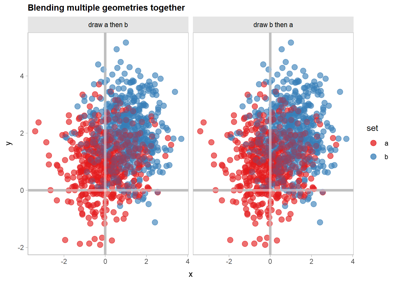

df |>
list(
geom_point(size = 3, alpha = 0.5) * (blend("lighten") + blend("multiply", alpha = 0.5)) |> blend(),
labs(title = "Blending multiple geometries together")

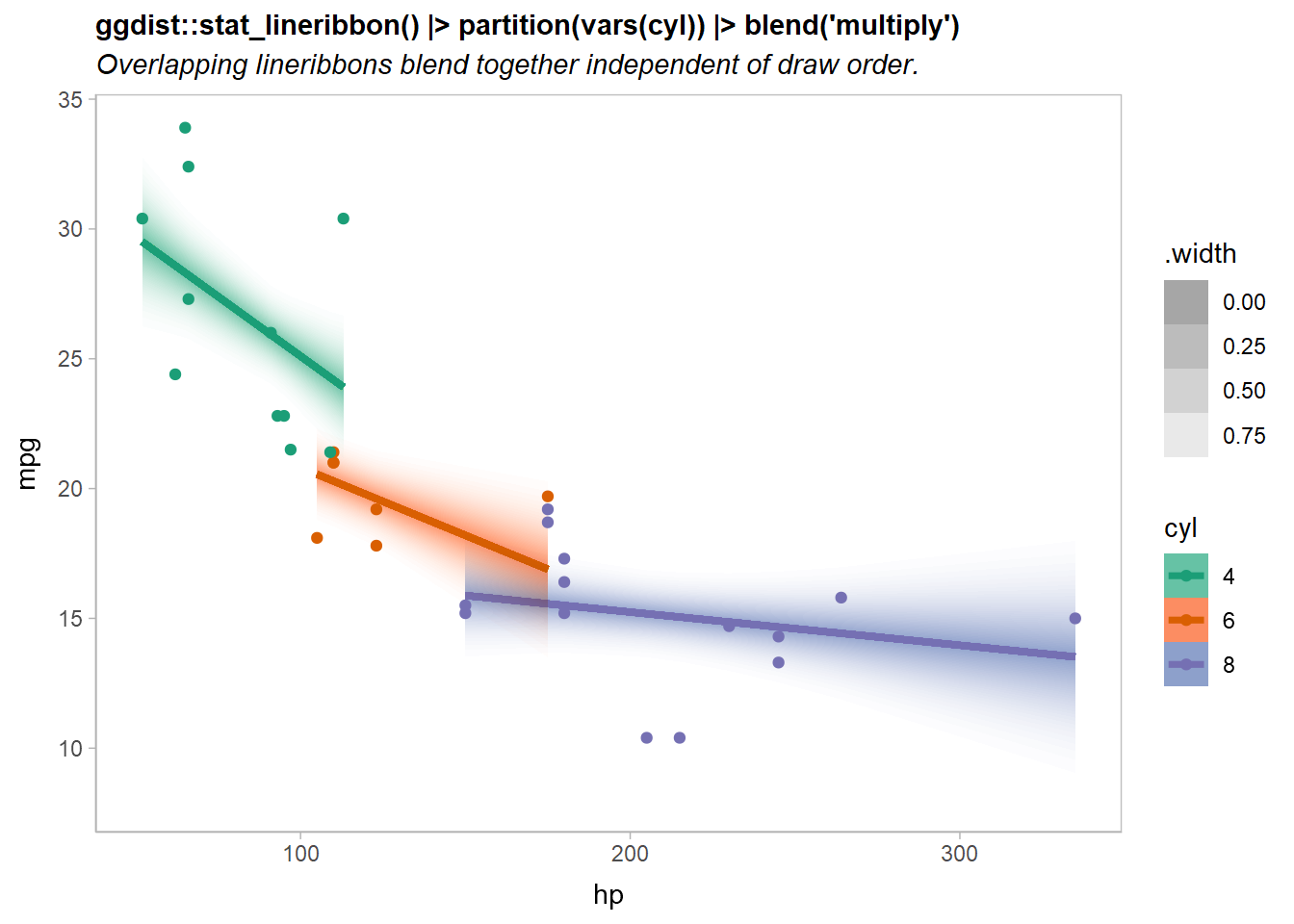

A basic plot based on examples in
vignette("freq-uncertainty-vis", package = "ggdist") and
vignette("lineribbon", package = "ggdist") may have issues
when lineribbons overlap:
predictions |>
ggplot(aes(x = hp, fill = ordered(cyl), color = ordered(cyl))) +
ggdist::stat_lineribbon(
aes(ydist = mu_hat, fill_ramp = after_stat(.width)),
.width = ppoints(40)
geom_point(aes(y = mpg), data = mtcars) +
scale_fill_brewer(palette = "Set2") +
scale_color_brewer(palette = "Dark2") +
ggdist::scale_fill_ramp_continuous(range = c(1, 0)) +
labs(
title = "ggdist::stat_lineribbon()",
subtitle = "Overlapping lineribbons obscure each other.",
color = "cyl", fill = "cyl", y = "mpg"
Notice the overlap of the orange (cyl = 6) and purple
(cyl = 8) lines.
If we add a partition = cyl aesthetic mapping, we can
blend the geometries for the different levels of cyl
together with a blend() call around
ggdist::stat_lineribbon().
There are many ways we could add the partition to the plot:
partition = cyl to the existing
aes(...) call. However, this leaves the partitioning
information far from the call to blend(), so the
relationship between them is less clear.aes(partition = cyl) to the
stat_lineribbon(...) call. This is a more localized change

call to vars().Let’s try the fourth approach:
predictions |>
) |> partition(vars(cyl)) |> blend("multiply") +
labs(
title = "ggdist::stat_lineribbon() |> partition(vars(cyl)) |> blend('multiply')",
subtitle = "Overlapping lineribbons blend together independent of draw order.",
Now the overlapping ribbons are blended together.

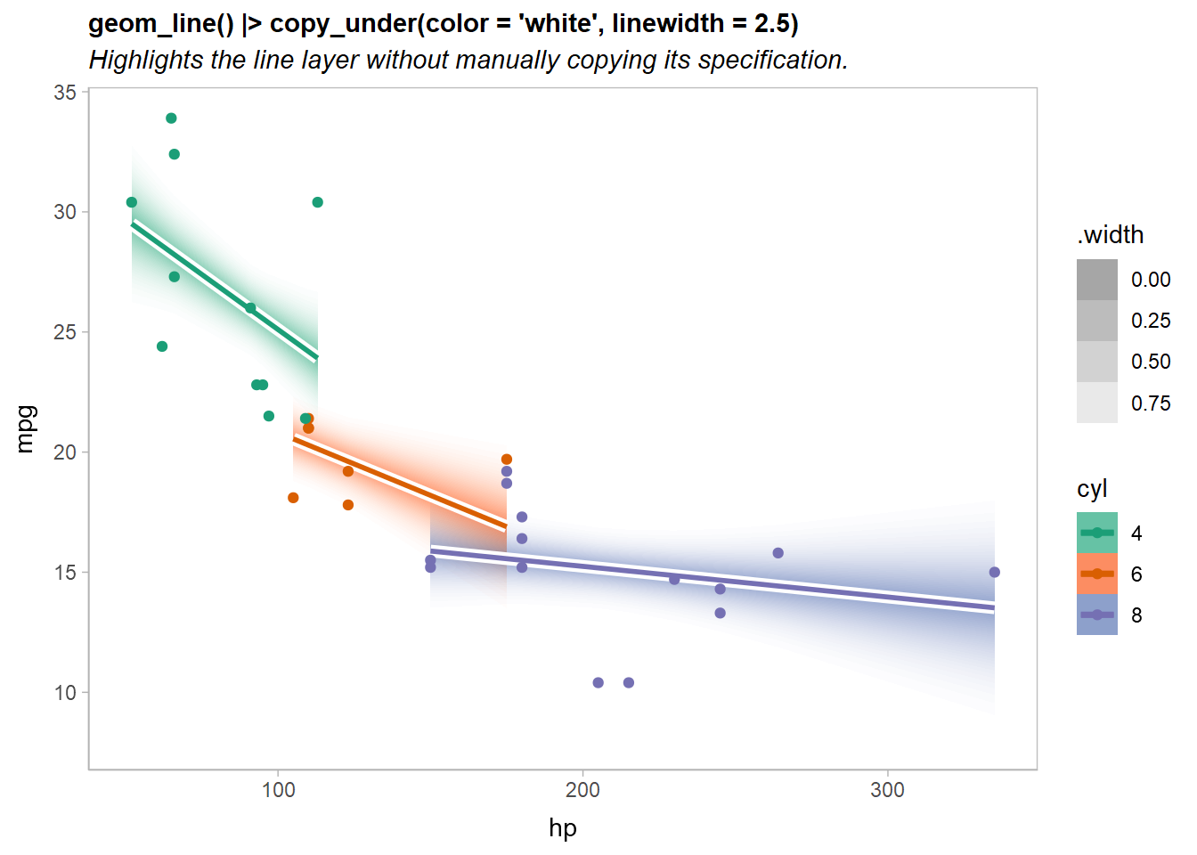

geom_line(linewidth = 1) * (adjust(color = "white", linewidth = 2.5) + 1)The copy_under(...) operation, which is a synonym for
adjust(...) + 1, also implements this pattern:
geom_line(linewidth = 1) * copy_under(color = "white", linewidth = 2.5)Here’s an example highlighting the fit lines from our previous lineribbon example:
predictions |>
ggdist::stat_ribbon(
geom_line(aes(y = median(mu_hat)), linewidth = 1) |> copy_under(color = "white", linewidth = 2.5) +
labs(
title = "geom_line() |> copy_under(color = 'white', linewidth = 2.5)",
subtitle = "Highlights the line layer without manually copying its specification.",
Note that the implementation of copy_under(...) is
simply a synonym for adjust(...) + 1; we can see this if we
look at copy_under() itself:
copy_under()## <operation>: (adjust() + 1)

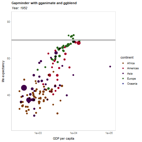

As a hard test, here is all three features applied to a modified version of the Gapminder example used in the gganimate documentation:
library(gganimate)
library(gapminder)
p = ggplot(gapminder, aes(gdpPercap, lifeExp, size = pop, color = continent, partition = continent)) +
list(
geom_point(show.legend = c(size = FALSE)) |> blend("multiply"),
geom_hline(yintercept = 70, linewidth = 2.5, color = "gray75")
scale_color_manual(values = continent_colors) +
scale_size(range = c(2, 12)) +
scale_x_log10() +
labs(
title = 'Gapminder with gganimate and ggblend',
subtitle = 'Year: {frame_time}',
x = 'GDP per capita',
y = 'life expectancy'
transition_time(year) +
ease_aes('linear')
animate(p, type = "cairo")
