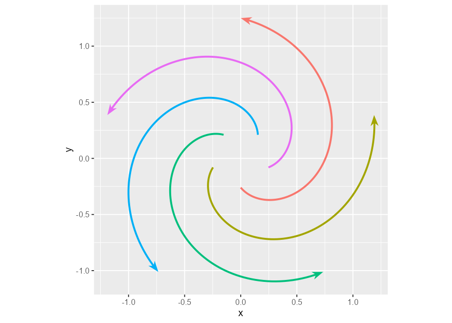

p <- ggplot(whirlpool(5), aes(x, y, colour = group)) +
coord_equal() +
guides(colour = "none")
p + geom_arrow()

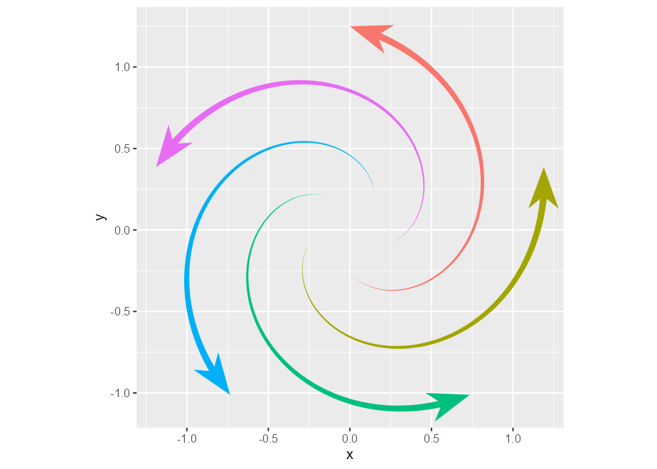

Arrows, in contrast to vanilla lines, can have variable widths.
p + geom_arrow(aes(linewidth = I(arc))) # Identity scale for linewidth

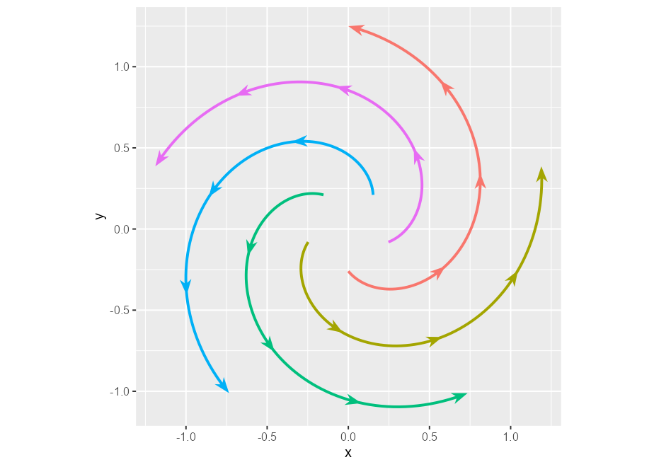

Besides varying linewidths, there is also an option to place arrows along the path. You could draw arbitrarily many of these, but I doubt that will look pretty.
p + geom_arrow(arrow_mid = "head_wings", mid_place = c(0.25, 0.5, 0.75))

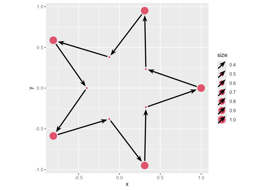

Aside from these, there is also geom_arrow_chain(),
which has no equivalent in vanilla ggplot2. It adds arrows in between
points, and dodges the endpoints a bit so that they don’t seem to touch.
In the example below, we can see that we can dodge points of different
sizes.
t <- seq(0, 2 * pi, length.out = 11)
l <- rep(c(1, 0.4), length.out = 11)
df <- data.frame(
x = cos(t) * l,
y = sin(t) * l,
size = l
ggplot(df, aes(x, y, size = size)) +
geom_point(colour = 2) +
geom_arrow_chain() +
coord_equal()

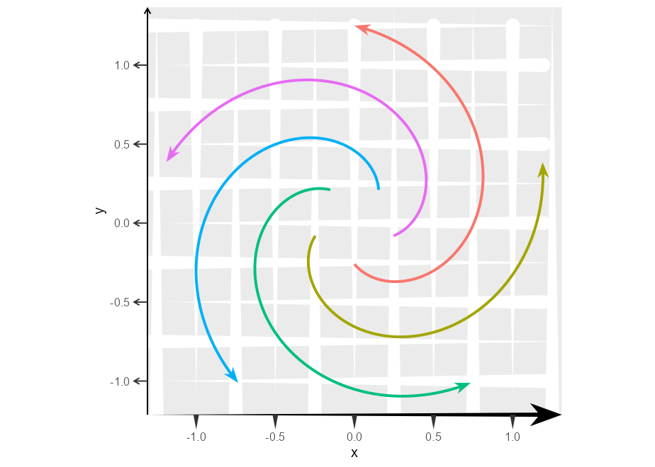

Because arrows are almost drop-in replacements for lines, I also
included element_arrow() as a theme element. With function,
you can set any line element in the theme to an arrow, with similar
customisation options as the layers.
p + geom_arrow() +
theme(
axis.line.x = element_arrow(
arrow_head = "head_wings", linewidth_head = 1.5, linewidth_fins = 0
axis.line.y = element_arrow(arrow_head = "head_line"),
axis.ticks.length = unit(0.4, "cm"),
axis.ticks.x = element_arrow(linewidth_fins = 0, linewidth_head = 2),
axis.ticks.y = element_arrow(arrow_fins = "head_line"),
panel.grid.major = element_arrow(
linewidth_head = 5, linewidth_fins = 0,
resect_head = 5, resect_fins = 5, lineend = "round"
panel.grid.minor = element_arrow(
linewidth_head = 0, linewidth_fins = 5

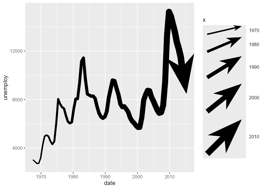

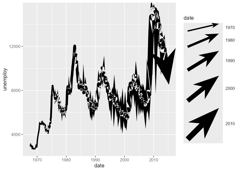

The current limitation is that variable width paths don’t lend themselves well to jagged paths with short segments. This is because I had to implement linejoins for variable width paths and I barely have high-school level understanding of trigonometry. Consequently, the linejoins look bad with short jagged segments.
ggplot(economics, aes(date, unemploy)) +
geom_arrow(aes(linewidth = date))
The best advice I can give for the jagged linejoins is to smooth the data beforehand.
