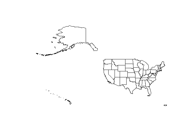

In United States Census Bureau we find layers at various levels of detail, including state. We get a geographic layer for state level (layer_us_state). For this example we obtain it from the package itself (we could read it from a GeoPackage or in any other format using the sf package).
library(geodimension)
layer_us_state <- gd_us |>
get_level_layer("state")
plot(sf::st_shift_longitude(sf::st_geometry(layer_us_state)))
From it we can define all the levels. From each layer, we define a geolevel.

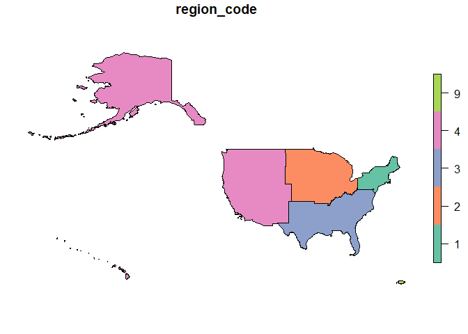

ll <- gd |>
get_level_layer(level_name = "region",
only_key = TRUE)
plot(sf::st_shift_longitude(ll))
