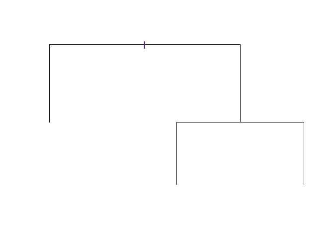

remotes::install_github("JeroenGoedhart/fusedTree")We illustrate the model for a continuous response. The simulated data has a nonlinear relationship with clinical variables and a linear relationship with omics variables.
library(fusedTree)
if (!requireNamespace("rpart", quietly = TRUE)) install.packages("rpart")
library(rpart)set.seed(10)
p <- 5 # Number of omics variables
p_Clin <- 5 # Number of clinical variables
N <- 100 # Sample size
# Nonlinear function of clinical variables
g <- function(z) {
15 * sin(pi * z[,1] * z[,2]) +
10 * (z[,3] - 0.5)^2 +
2 * exp(z[,4]) +
2 * z[,5]
# Clinical and omics covariates
Z <- as.data.frame(matrix(runif(N * p_Clin), nrow = N))
X <- matrix(rnorm(N * p), nrow = N)
betas <- c(1, -1, 3, 2, -2)
# Response: nonlinear clinical + linear omics + noise
Y <- as.vector(g(Z) + X %*% betas + rnorm(N))Thus, the response is generated by a nonlinear clinical part and a separate linear omics part. Therefore, the omics variables do not vary with the clinical variables. The omics regressions in the different nodes of the tree should therefore benefit from strong fusion.

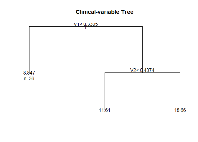

dat <- cbind.data.frame(Y, Z)
rp <- rpart(
Y ~ ., data = dat,
control = rpart.control(xval = 5, minbucket = 10),
model = TRUE
# poste-prune the tree
cp <- rp$cptable[which.min(rp$cptable[, "xerror"]), "CP"]
Treefit <- prune(rp, cp = cp)
plot(Treefit, main = "Clinical-variable Tree")
text(Treefit, use.n = TRUE)

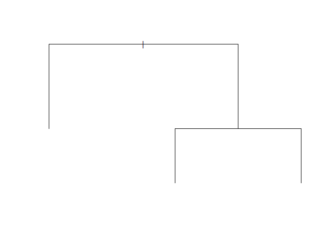

# Fit tree using only clinical variables
dat <- data.frame(Y = Y, Z)
rp <- rpart::rpart(Y ~ ., data = dat,
control = rpart::rpart.control(xval = 10, minbucket = 10),
method = "class", model = TRUE)
cp <- rp$cptable[,1][which.min(rp$cptable[,4])]
Treefit <- rpart::prune(rp, cp = cp)
plot(Treefit)
