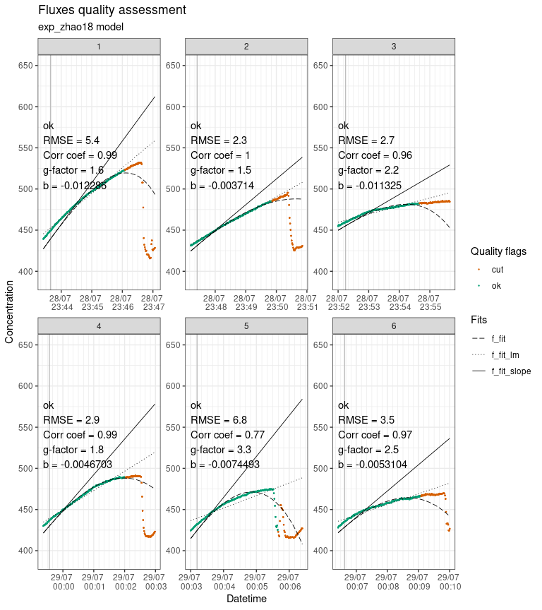

flux_plot(
slopes_flag_df,
conc,
datetime,
f_ylim_lower = 390,
f_ylim_upper = 650,
facet_wrap_args = list(
ncol = 3,
nrow = 2,
scales = "free"
#> Plotting in progress
Output of flux_plot, showing fluxes plotted individually with diagnostics and quality flags.
