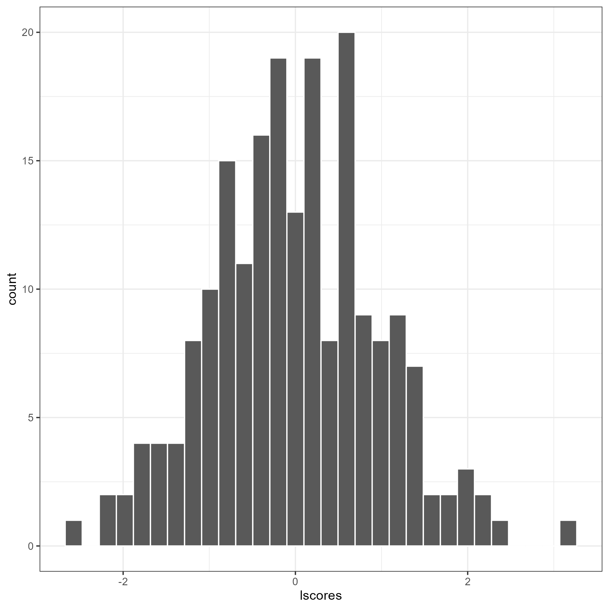

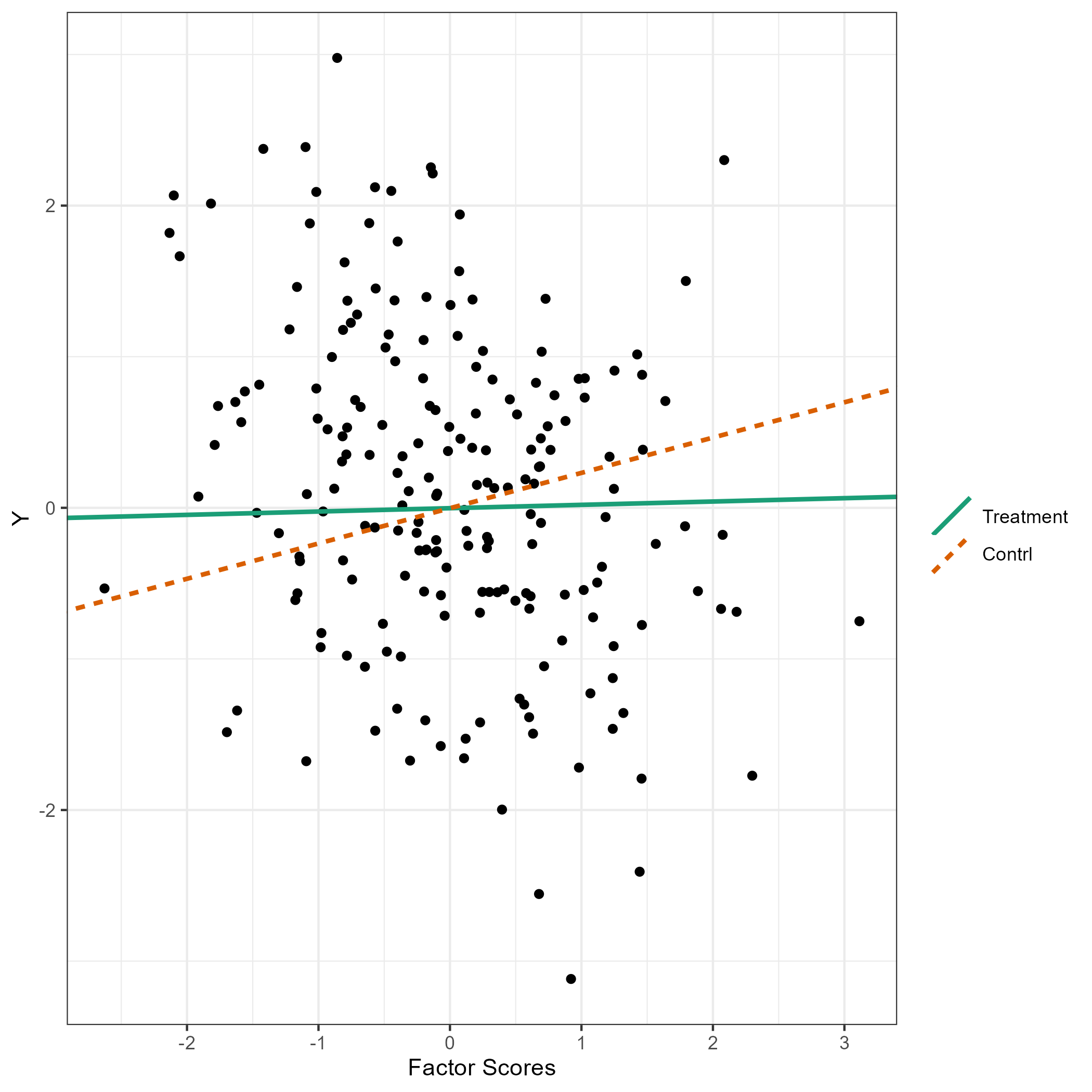

)Retrieve summaries and visualize results with the following:
The flps_plot() shows the plot related to FLPS models
